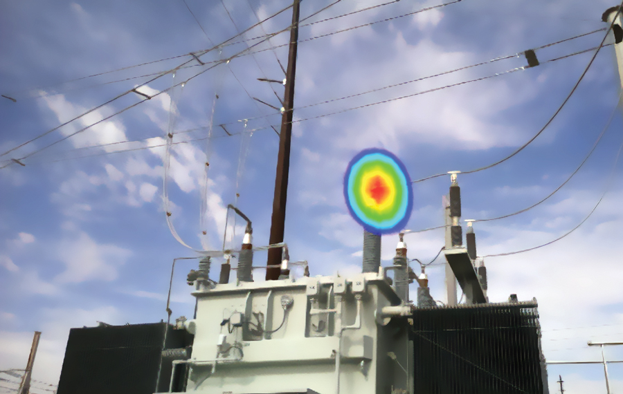

Example of Partial Discharge On or Near a Transformer Bushing
IMAGE COURTESY OF FLIR

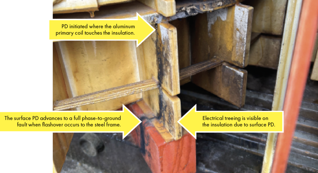

TRANSFORMER FAILURE DUE TO PD

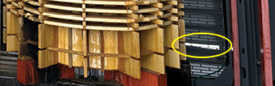

A 2,000-kVA, dry-type transformer failed due to PD on the 13.2-kV primary coil insulation. The failure was due to a damaged ventilation louver on an outdoor transformer enclosure, as the open louver repeatedly allowed water and snow to enter during inclement weather. The moisture, high humidity, and dirt contamination caused the primary coil insulation to break down due to PD. Surface PD tracking and electrical treeing damage were visible on all three primary coil windings and insulation. The surface PD eventually spanned the insulation system to the grounded support steel within the enclosure. The progressive damage to the insulation resulted in arcing ground faults that destroyed the winding insulation and melted the aluminum primary coil windings.
Periodic, on-line PD testing or manual acoustical imaging equipment would have detected the slowly developing surface tracking.
A review of the damage found that:
  •  Visual inspection of the roof-mounted transformer enclosure would have detected the damaged ventilation louver.
  • Repair or replacement of the bent louver would have prevented water and humidity from soaking into the primary winding insulation and reduced the PD inception voltage.
  • Having an NFPA 70B-compliant electrical preventive maintenance program for the roof-mounted transformers would have required periodic visual and electrical inspections.
  • Periodic cleaning of dirt from the transformer interior would have reduced the likelihood of surface PD or tracking.
The internal view of the transformer shows a direct entry point for water and moisture. This is especially true during wind-driven storm conditions.
