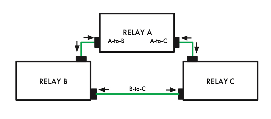

The 2oo3 trip logic requires that at least two out of the three main generator protection relays operate for a specific condition, such as an internal stator ground fault (e.g., 64G1). Figure 1 illustrates the relay communications. Each relay must communicate with the other two and vice versa, and each communication link is bi-way. Therefore, each relay continuously knows the status of the other two relays’ tripping elements via the communication links.
Figure 1: Relay-to-Relay Communication Links for 2oo3 Trip Logic

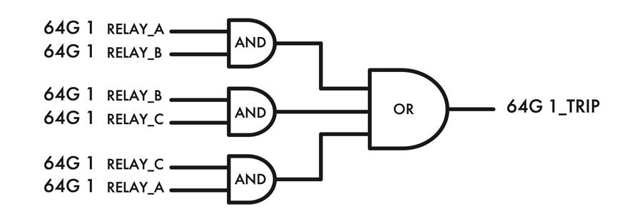

Two out of the three relays must operate via a particular protection element in order for a trip to be issued, such as 64G1 neutral overvoltage. Figure 2A illustrates this logic.
Figure 2A: 2oo3 64G1 Trip Logic

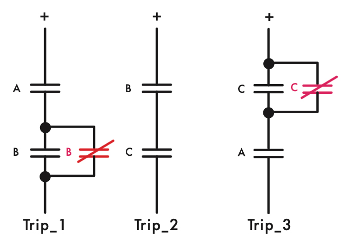

Ideally, each relay should have independent VTs, CTs, and DC batteries; however the vast majority of nuclear power plants were built decades ago. It is rare to ever have three independent sets of batteries. Therefore, two of the three relays must likely be sourced by one battery. The trip logic must automatically adapt if this common battery fails, or else tripping is not possible.
Suppose, for example, that relays B and C are both sourced by the same battery. Figure 3 illustrates how to switch over to a one-out-of-one (1oo1) scheme, relying solely upon relay A until the situation with the defective battery can be remedied.
Figure 3: Fail-Safe Adaptive Trip Logic
Normally closed output contacts for relays B and C are connected in parallel with the respective normally open trip output contact. Relay A can independently trip via paths Trip_1 and Trip_3 should the battery sourcing relays B and C ever fail. Each normally closed output contact falls closed when the relay power supply is dead.

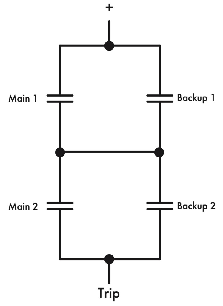

ONE-OUT-OF-TWO TAKEN TWICE (1OO2X2) TRIP LOGIC
Another popular trip scheme used is one-out-of-two taken twice, which is simply two one-out-of-two trip schemes connected in series, as illustrated in Figure 4. This scheme is biased towards dependability. This scheme can also be realized using relay-to-relay communication.
Figure 4: 1oo2X2 Trip Logic

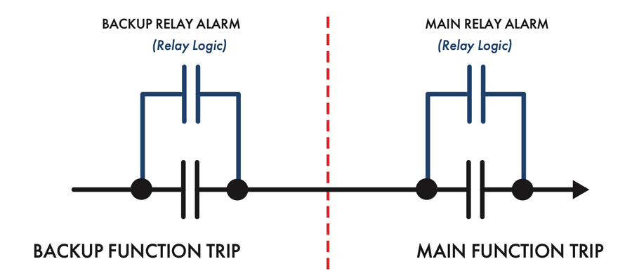

Figure 5 illustrates how this trip scheme can be modified so it is adaptive.
Figure 5: Adaptive 1oo2X2 Trip Logic
The relay alarm output can be realized using programmable relay logic, so extra output contacts are not required, for example:
OUT202 := (40Z1T OR 40Z2T) OR (HALARM OR SALARM)
