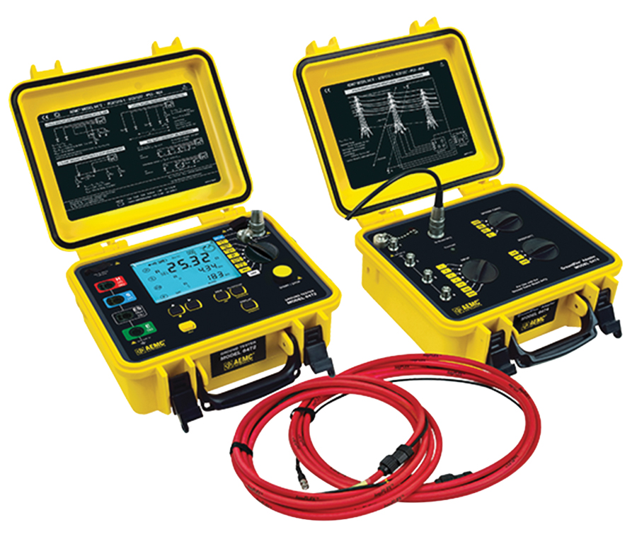

AEMC
Test Equipment
Image courtesy of AEMC® Instruments
AEMC 6472 + 6474 + ACCESSORIES*
Although AEMC and Megger have been around for a long time and offer newer versions of their test equipment, many pitfalls still exist in today’s grounding testing, specifically, limited current output that can’t overcome test lead interference (low signal-to-noise ratio). This equipment is:
  • Less expensive ($16K)
  • DC power, portable
  • 250 mA output—very limiting in field testing, even on small sites
  • Output frequency 0–440 Hz
  • No user interface data—requires the user to interpret data points in the field to determine validity
  • Available for rental

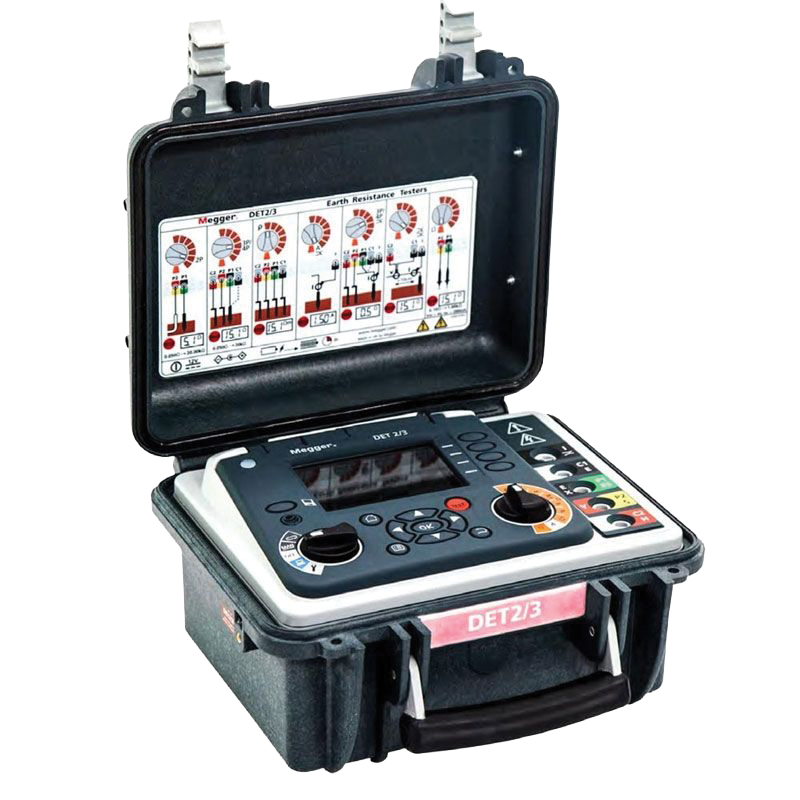

Megger
Test Equipment
Image courtesy of Megger
MEGGER DET 2/3*
  • Inexpensive ($6K)
  • DC power, very portable
  • 50 mA output—extremely limiting in field testing, even on small sites
  • Output frequency 10–200 Hz

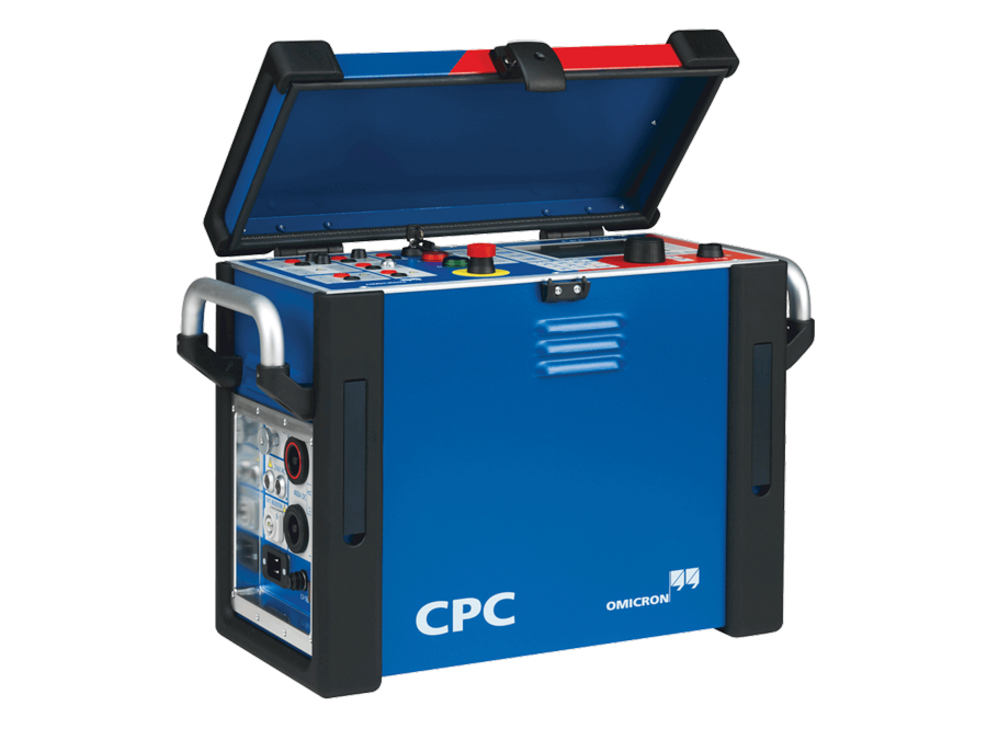

OMICRON
Test Equipment
Image courtesy of OMICRON
OMICRON CPC 100 (OR COMPANO 100)*
  • Expensive ($70K+)
  • Training recommended
  • Requires AC power for CPC 100 and DC power for COMPANO 100
  • Provides real-time data feedback during testing
  • Data recorded on tablet/computer
    • CPC 100 = 3 A output
      COMPANO 100 = 200 mA output
    • CP CU1 = 100 A/50 V or 10 A/500 V output (overhead injection)
  • Output frequency 15–400 Hz

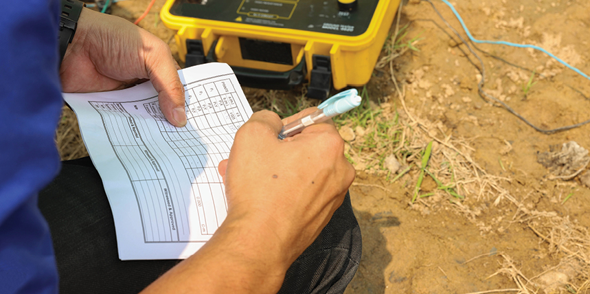

  • Data must be recorded by hand—no associated software for field testing (some software for post-test analysis)

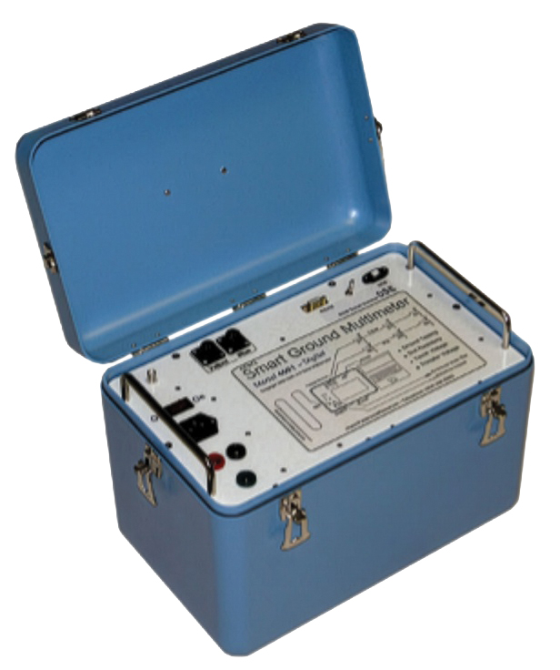

SGM
Test Equipment
Image courtesy of Advanced Power Concepts
SMART GROUND MULTIMETER (SGM)*
  • Expensive ($75K+)
  • Requires training
  • Requires AC power
  • Provides extensive real-time data feedbac during testing
  • Connected computer records all data
  • 16 A output (overland)
  • Output frequency 0–250 Hz default.
    User selectable to 2,000 Hz.
  • Due to training requirements and complexity, not available for rental
