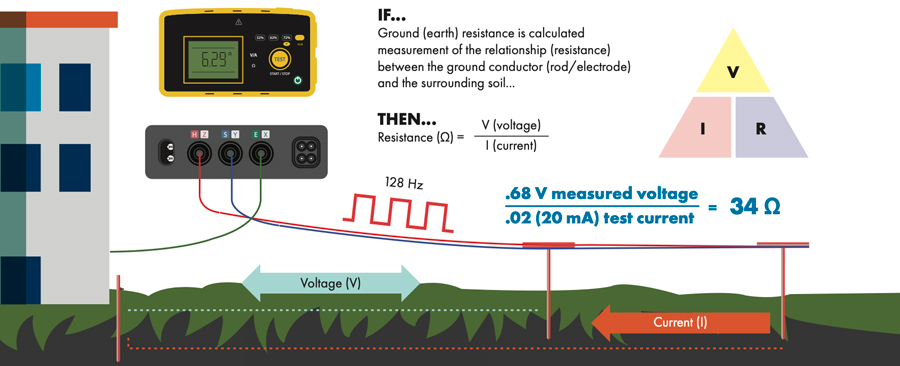

FOP testing is used to determine the resistance of a grounding electrode system to earth, commonly expressed as Rg. This value represents the effective resistance between the grounding system and the surrounding soil mass, and it is a key parameter for assessing a system’s grounding provision, mat, or network performance and safety.
The test is performed by injecting a known current between the grounding electrode under test (depending on the test set used, these probes may be tied to the E, X, or C2 terminal of the equipment) and a remote auxiliary electrode, often referred to as the current or outer A third electrode (equipment terminal H, Z, or C1). A potential electrode (equipment terminal S, Y, or P),  or “walking electrode,” is placed at evenly spaced, linear intervals along the line between the test and auxiliary electrodes. At each position, the voltage between the grounding electrode and the potential electrode is measured. By applying Ohm’s Law, the resistance can be calculated, as seen in Figure 1.
Figure 1: Fundamental Principles and Setup of Fall-of-Potential Testing
IMAGE COURTESY AEMC® INSTRUMENTS
As the potential electrode is moved farther from the grounding system, the measured voltage reflects the diminishing influence of the system’s hemispherical range of influence. Plotting these values typically produces a curve from which a stable resistance value can be identified.
The test setup generally consists of a ground test instrument connected to three electrodes. The grounding electrode is connected directly to the system under test, while the current and potential electrodes are usually metal stakes driven into the earth. In soils that are loosely compacted, moist, and moderately conductive, this process is efficient and reliable. These ideal conditions, however, are not always what a technician encounters on site.

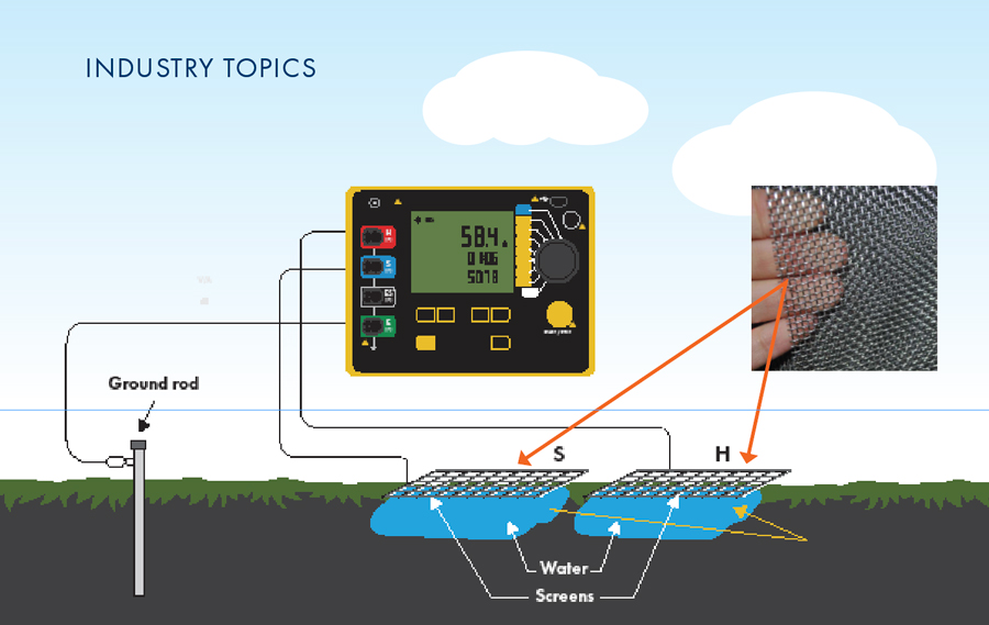

Chicken Wire and Ufer Soup
Cement concrete (hereafter referred to as concrete) presents a more complex challenge. Unlike asphalt, well-constructed concrete is only minimally permeable and, when dry, acts as a relatively effective electrical insulator. This can isolate the test setup from the earth below, making conventional approaches ineffective.
Concrete is composed of cement and aggregate, forming a dense, durable material that is not easily penetrated without drilling. Fortunately, its electrical properties change significantly when saturated with water. Under these conditions, concrete exhibits semiconductive behavior due to ionic movement within its pore structure.
The mesh electrode method leverages this phenomenon. Instead of a small contact point, this approach uses a large conductive mesh—such as chicken wire or metal fencing—placed over a water-saturated section of concrete to create a broad contact interface. The mesh should be larger than the flat electrode used for asphalt applications. A size of approximately two feet by two feet is generally sufficient for most testing scenarios.
To perform the test, the technician saturates the target area with a substantial volume of water, typically around one gallon per square foot. Time must be allowed for the water to permeate the concrete thoroughly, which may take several minutes or longer, depending on the material.
Once saturation is achieved, the mesh electrode is laid flat on the surface, and the test lead is connected. As with the flat electrode method, the technician stands on the mesh to ensure consistent contact during measurement. This alternate electrode method can be seen in Figure 3.
Figure 3: Mesh Auxiliary Electrode Method
IMAGE COURTESY OF AEMC® INSTRUMENTS
It is important to note that electrolyte solutions should not be used in this method. Introducing additional ions can alter the natural conductive behavior of the saturated concrete and lead to inconsistent results.
