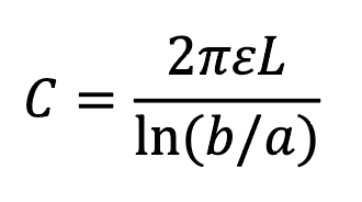

For the quantitative analysis of the phenomenon, the insulated cable is modeled as a coaxial geometry, consisting of a central conductor and a metallic shield separated by insulation that serves as the dielectric. In this model, a represents the conductor radius, b corresponds to the inner radius of the shield, L is the cable length, and ε is the electrical permittivity of the insulating material, defined as ε = ε₀εᵣ, where ε₀ is the vacuum permittivity and εᵣ is the relative permittivity of the dielectric.
From this coaxial geometry, the total capacitance of the cable is obtained, as presented in Equation (2), which depends on the permittivity of the insulating material, the cable length, and the ratio between the shield radius and the conductor radius. This parameter is fundamental for analyzing energy storage in the system, since the total capacitance C appears directly in the expression of the electrical energy stored in the cable during the voltage test, as previously presented in Equation (1).
(2)

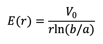

When a voltage V₀ is applied between the conductor and the shield, a radial electric field is established within the insulation. The intensity of the field varies with the radial distance r from the conductor’s center. This electric field is described by Equation (3), in which E(r) represents the electric field intensity at a point located at a radial distance r from the cable axis, V₀ corresponds to the voltage applied during the test, a is the conductor radius, and b is the inner radius of the shield.
The electric field distribution is not uniform across the insulation, being more intense in regions close to the conductor. Therefore, the maximum electric field, indicated in Equation (4), occurs at the interface between the conductor and the insulating material, when r = a. This result is particularly relevant for the analysis of dielectric stress in the cable, since this is the region where the insulation is subjected to the highest electric field level during voltage application.
(3)
  (4)

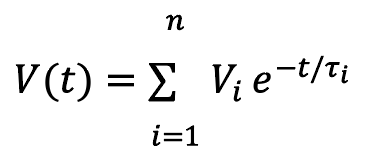

After the test source is removed, the voltage in the cable does not instantaneously drop to zero but instead decays over time due to energy dissipation in the system. In a simplified approach, this behavior can be described by the equivalent RC model of the cable, in which the voltage decay follows an exponential function over time, as represented in Equation (5), where V(t) corresponds to the voltage at time t, V₀ is the initial voltage at the moment the source is disconnected, R represents the equivalent leakage resistance, and C is the cable capacitance.
However, in polymeric dielectric materials, such as XLPE, used in power cables, additional phenomena associated with dielectric absorption and slow polarization are observed and are not fully described by a single RC circuit. In such cases, the residual voltage behavior can be represented as a sum of multiple exponential terms with different time constants (τᵢ), as shown in Equation (6). This more comprehensive model explains phenomena observed in practice, such as the partial reappearance of voltage after an initial discharge, known as voltage rebound.
(5)
(6)

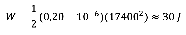

Example 1 — 15-kV Cable (8.7/15-kV Class)
For the first example, a medium-voltage cable of class 8.7/15-kV is considered, subjected to an acceptance test using VLF voltage, a method widely employed in field testing to assess the integrity of insulation in cables with polymeric dielectrics such as XLPE or EPR. In systems of this class, the nominal phase-to-ground voltage is U₀ = 8.7 kV. During acceptance testing, IEEE guides typically recommend applying 2U₀, resulting in a test voltage of V₀ = 17.4 kV. The typical parameters used to estimate the energy stored in the cable are presented below.
  • Cable length: 1 km
  • Typical capacitance: 0.20 µF/km
  • VLF test voltage (acceptance): 2.0 U₀
The energy stored in the cable during the test can be estimated using the capacitor energy equation, Equation (1). Considering the total capacitance corresponding to 1 km of cable and the applied test voltage, substituting these values into Equation (1) results in the expression presented in Equation (7).
(7)
This result indicates that, even for a single kilometer of a medium-voltage cable, the electrical energy stored during the test can reach several tens of joules. Values of this magnitude are sufficient to produce a perceptible electrical discharge, an electric arc, or a potentially hazardous shock if the cable is handled before the complete dissipation of the stored energy after the end of the test.

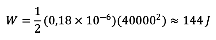

Example 2 — 35-kV Cable (20/35-kV Class)
For the second example, a medium-voltage cable of class 20/35-kV is considered, also subjected to an acceptance test using VLF voltage. In this class of system, the nominal phase-to-ground voltage is U₀ = 20 kV. By applying 2U₀, the test voltage becomes V₀ = 40 kV. The typical parameters used to estimate the energy stored in the cable during the test are presented below.
  • Typical capacitance: 0.18 µF/km
By again applying the capacitor energy Equation (1) and considering the total capacitance for 1 km of cable, the value in Equation (8) is obtained.
(8)
This result shows that, for higher-voltage-class cables, the energy stored during the test increases significantly, reaching hundreds of joules. Levels of this magnitude represent a substantial risk of electrical discharge, arcing, or severe shock if the cable is handled before proper discharge and grounding procedures are carried out after the test.
