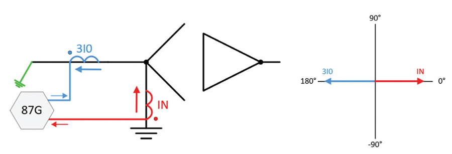

Typical differential CT configurations where polarity faces away from the protected equipment are shown in Figure 1. Assuming no CT saturation, the ideal phase difference between 3I0 and IN is 180 degrees for any external ground current condition. In addition, the 3I0 and IN primary current magnitudes should closely resemble each other.
Figure 2: Ideal Phase Relationship between 3I0 and IN for External Ground Faults

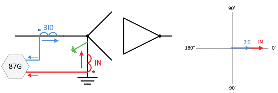

For internal ground faults on the protected winding, the phase difference between 3I0 and IN for the mentioned CT configuration should be closer to 0 degrees. However, unlike external faults, 3I0 and IN primary current magnitudes may vary for internal faults, as the fault sources and impedance to the fault location will be different. Figure 2 and Figure 3 illustrate these correlations for internal and external ground faults based on the CT configuration. These CT relationships, combined with varied vendor algorithms, define the basics of REF protection.
Figure 3: Ideal Phase Relationship between 3I0 and IN for Internal Ground Faults

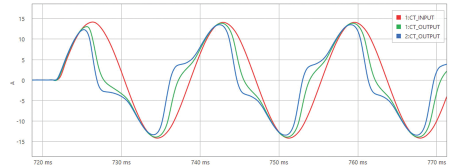

In an additional test on Auxiliary CT #1, the secondary side was loaded with a 10-Ω resistor, and a 10-A symmetrical signal was injected. This required the CT to produce a 100-V secondary, which would be above the CT’s capability shown in Table 1. The input signal can be seen in Figure 6 as 1:CT_INPUT. The initial output on the secondary side of the auxiliary CT can be seen as 1:CT_OUTPUT with characteristic saturation.
Figure 6: Auxiliary CT Saturated and Replayed Again
The authors were curious how the auxiliary CT would respond to a saturated signal as an input, so the 1:CT_OUTPUT signal was replayed back into the CT, with the resulting 2:CT_OUTPUT as the twice-saturated signal measured on the secondary. During CT or event analysis, it may be of benefit to consider one or both primary and auxiliary CTs saturating differently depending on the input signal, level of DC offset, and any remanent flux in the CT.

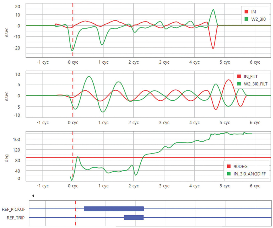

The 46-kV B-phase current (W2_IB) shows signs of CT saturation for the first two cycles of the event in Figure 8. The filtered current magnitudes show that the B-phase current was about 10% lower than the other phases when saturated, but 10% higher when not saturated. It is common to think of three-phase faults as perfectly balanced, but system asymmetries can create imbalance and ground current, as shown in this event. In this case, the 46-kV auxiliary B-phase CT had an input signal of about 44 A with some DC offset and was expected to produce 22 A. As the auxiliary CT was mounted above the relay, the leads between the auxiliary CT and the relay could be considered to have negligible impedance. The microprocessor relay CT inputs also have little burden.
Figure 8: 46-kV Unfiltered Waveform (Top) and Filtered Magnitude (Bottom)
Based on the system model, a similar fault resulted in an estimated X/R ratio of about 5. An impedance of 0.1 Ω would result in an auxiliary CT secondary voltage requirement of under 20 V, assuming no remanent flux in the CT. If the long lead connection from the field and the auxiliary CT primary impedance resulted in a total impedance of 1.6 Ω, the primary CT would need to support a secondary voltage above the 400-V rating. Regardless of whether the primary or the auxiliary CT saturated, this configuration is not ideal and warrants additional security measures for relay protection associated with the 46-kV currents.
The resulting filtered and unfiltered neutral and residual (3I0) 46-kV currents can be seen in the top two graphs in Figure 9. At the beginning of the event, the CT saturation results in a filtered 3I0 that is within 40 degrees of the neutral current, indicating an internal REF trip condition.
Figure 9: Neutral and 3I0 Current, Angle Differences, and REF Operation
Once the saturation subsides, the angle difference moves to 180 degrees away from the neutral current past the 90-degree threshold, indicating an external through-fault condition. The REF element was also configured to block operation when the neutral current was below 1.2 Asec or the phase residual current was below 0.96 Asec. These thresholds align with a typical 10% imbalance for the transformer MVA rating. During the initial saturated portion of the event, the neutral current measured around 1.9 Asec, and the phase residual current measured 6.0 Asec, permitting the REF element to operate.
Since this misoperation occurred, the breaker with the 600/5 CT was replaced and now supports a 1200/5 ratio. The 10/5 auxiliary CT on the 46-kV phase currents was removed. Whether the cause of the misoperation was the primary or auxiliary CT, no issues have occurred since the reconfiguration to remove the auxiliary CTs and use a 1200/5 primary CT ratio.

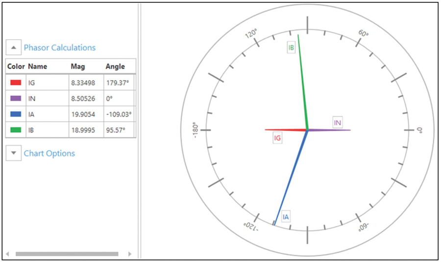

As the A-phase current saturates, the filtered magnitude reduces, but more importantly, the filtered phase angle leads the ideal current. The latter portion of the positive or negative sinusoid waveform is reduced during saturation, so the peak looks to occur earlier in the filtered waveform, resulting in the leading phase angle. As a CT with an ideal sinusoid input saturates further, the filtered signal peak could shift by only 90 degrees before it crosses into the opposite polarity region. This highlights the security of REF elements set with a 90-degree characteristic angle for single-phase faults.

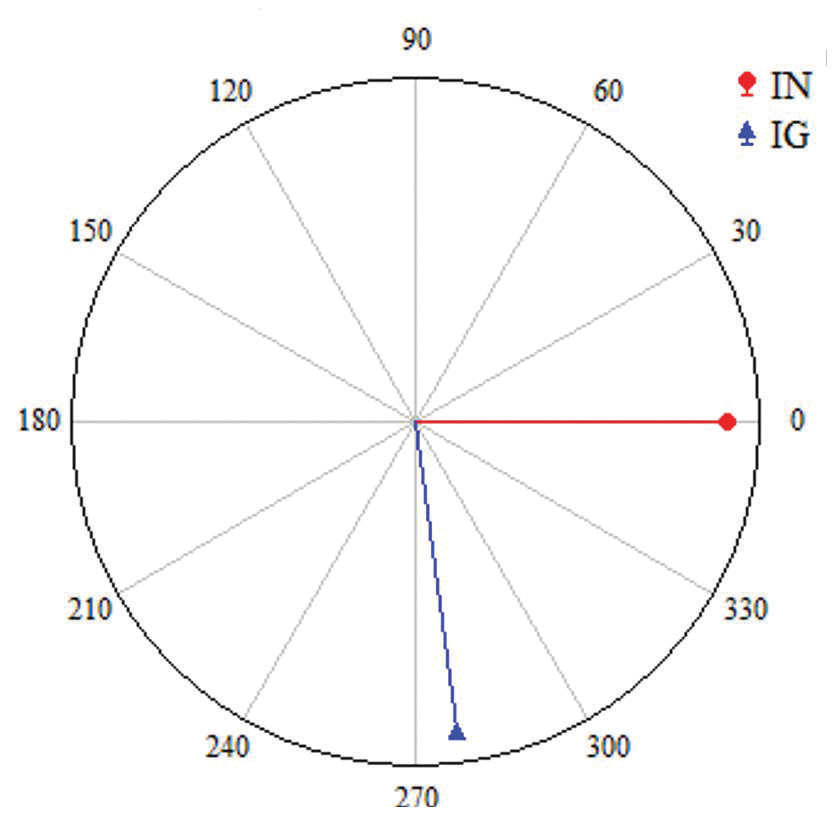

When the angle between IA and IB increases beyond 180 degrees due to CT error, the resulting filtered IG angle quickly moves to less than 90 degrees from IN and into the internal REF trip region (Figure 11). One consideration when analyzing CT saturation and phase-phase-ground faults with REF elements is that less CT saturation is required for a misoperation to occur as the angle separation between the two faulted phases increases. For instance, with a 120-degree separation, one phase would need to saturate such that the filtered waveform would shift by over 60 degrees to misoperate. The simulation in this section shows a 155.4-degree separation, which would require the resulting filtered waveform to shift by only 25 degrees for a REF misoperation.
Figure 11: Phase-Phase-Ground Simulation with Saturation

Figure 12 shows CT saturation on the A-phase and the resulting residual IG current on top. The bottom of Figure 12 shows the neutral current IN and the filtered residual IG current. The phasor diagram in Figure 13 from the latter portion of the waveform shows that the angle difference between IG and IN is less than 90 degrees and is in the REF trip region for the waveforms in Figure 12.
Figure 13: Unbalanced Three-Phase Fault with Saturation—Phasors
Analyzing the waveforms in Figure 12 graphically shows that an unbalanced three-phase through-fault may be more susceptible to REF misoperation due to saturation than a phase-phase-ground through-fault. Both fault types should be considered when designing the REF protection for a transformer if CT saturation is expected.
