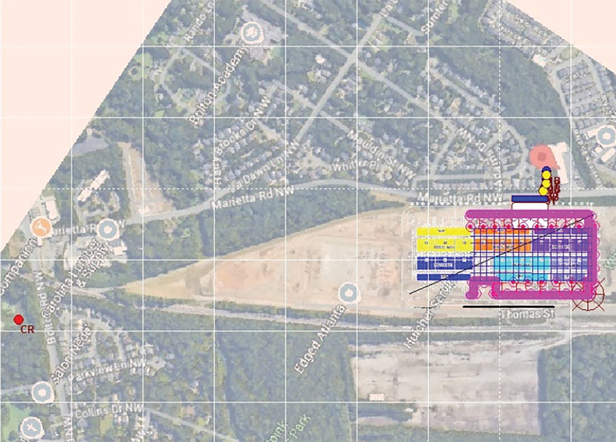

EXAMPLE 1: DATA CENTER SUBSTATION, OHIO
To test this site, two attempts using FoP were made. The testing personnel, who were told the site was isolated, proceeded with a standard FoP test without confirming the site’s isolation through a continuity test. In reality, the site was connected to three utility feeder lines and not isolated, invalidating the measured data in both cases.
This site was successfully tested using a computer-based multimeter as prescribed in IEEE Std. 81. This method does not require de-energization or isolation and reduces the distance required for the current return probe to twice the diagonal distance of the site under test (Figure 1).
Figure 1: Data Center Substation, Ohio, Using Computer-Based Multimeter

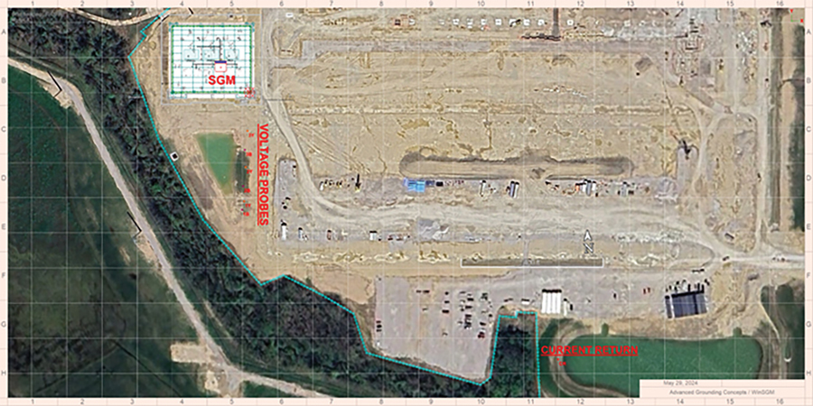

EXAMPLE 2: DATA CENTER BUILDING, GEORGIA
This site was first tested with the FoP method. The building has a 1,400-foot diagonal; five times that distance is 7,000 feet. The testers went 300 feet from the building and reported a reading of 186 feet (62%) as the building’s ground resistance value (Figure 2). This is an invalid test for several reasons:
  • They didn’t go far enough with the current-return probe
  • They relied on 62% rule–not valid at this site
  • They needed to develop a complete test curve (measure every 10%)
  • They didn’t confirm that the building was isolated
Figure 2: Data Center Building, Georgia, Using FoP Test

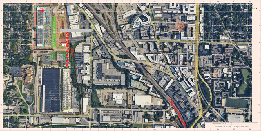

The site was retested with the computer-based multimeter (Figure 3) after determining that the building was bonded to the substation. The site’s grounding system diagonal now measured 2,500 feet. For a proper FoP, the current return probe had to be a minimum of 12,500 feet (almost 2.4 miles) away–not 300 feet. Using the computer-based multimeter, the distance was reduced to 5,000 feet, which was still a bit of a hike.
Figure 3: Data Center Building, Georgia, Using Computer-Based Multimeter
Note: Even using a computer-based multimeter, testing errors and bad data are still possible if you fail to go far enough away from the site under test. Always confirm the site’s isolation and diagonal before testing, regardless of the chosen test method.

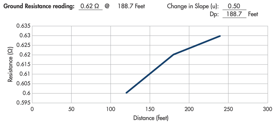

EXAMPLE 3: DATA CENTER BUILDING, GEORGIA
This new data center building on a campus was tested with the computer-based multimeter. The building was allegedly isolated, but we successfully conducted a test and obtained good data (Figure 4).
Figure 4: Data Center Building, Georgia, Using Computer-Based Multimeter
