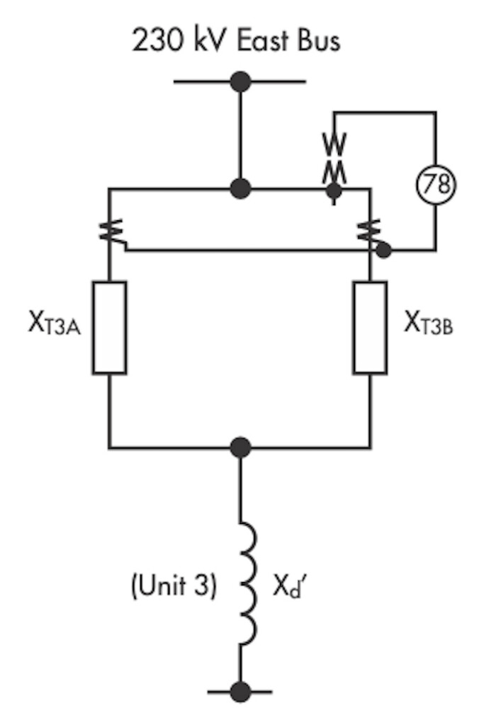

This example demonstrates how to set an existing KD-10 electromechanical distance relay for this application. The KD-10 relay is a polyphase compensator-type relay that provides a single zone of phase distance protection for all three phases. Figure 1 shows the one-line diagram for this particular application. The relay is located on the high side of the two parallel GSUs and measures the total current flowing into the adjoining 230-kV system.

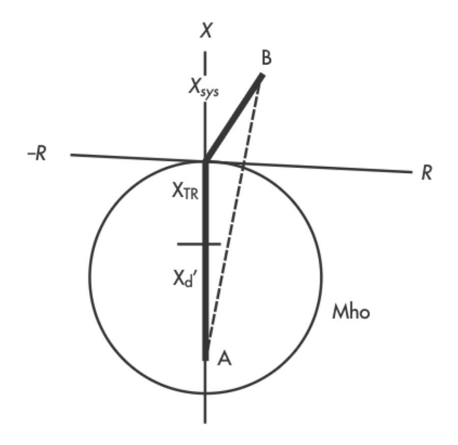

The relay is located at the bus on the high side of the parallel GSUs. Therefore, set the reach to see the equivalent GSU impedance (XTR) plus the saturated generator direct axis transient reactance (Xd’) as shown in Figure 2.[1] Care must be taken to use the correct base when calculating the total impedance to determine the proper reach, which is the 230-kV system, not the generator.

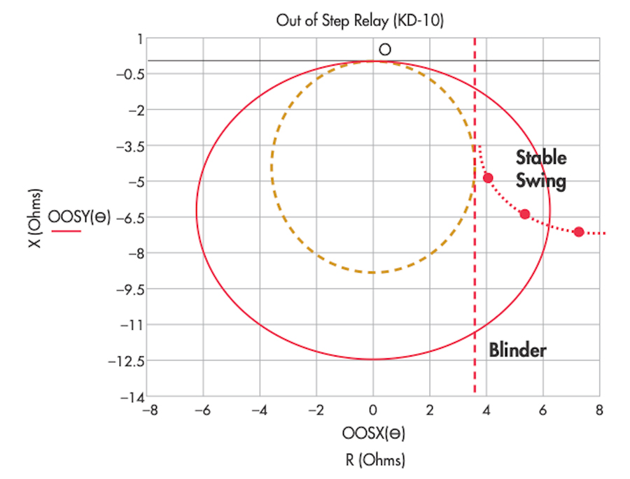

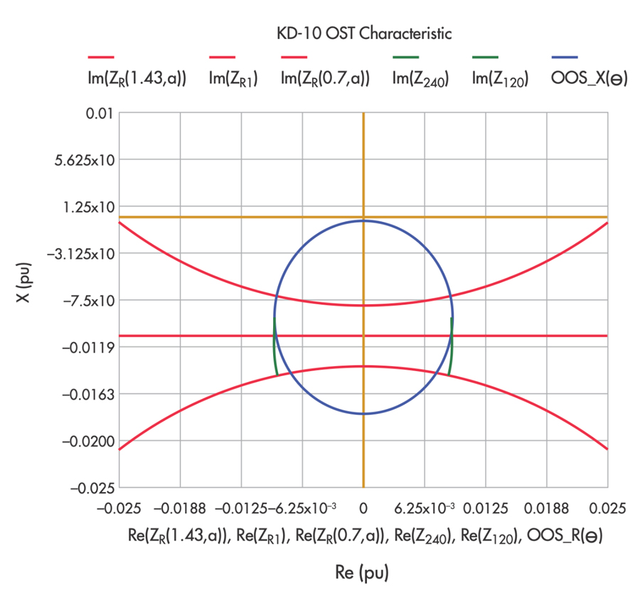

Figure 3 shows the actual Mho characteristic that was calculated for this application. One of the main drawbacks to using the KD-10 for this application is that there are no blinders to keep the operating characteristic from operating during a stable swing. Therefore, the reach must be pulled back if necessary, which can compromise the protection. Unstable swings travel through either the generator or the GSU for large machines. The blinder shown in Figure 3 is for illustrative purposes only.
Figure 4 shows the actual Mho characteristic for the application. The reach was pulled back until it met the PRC-026-2 requirements.
