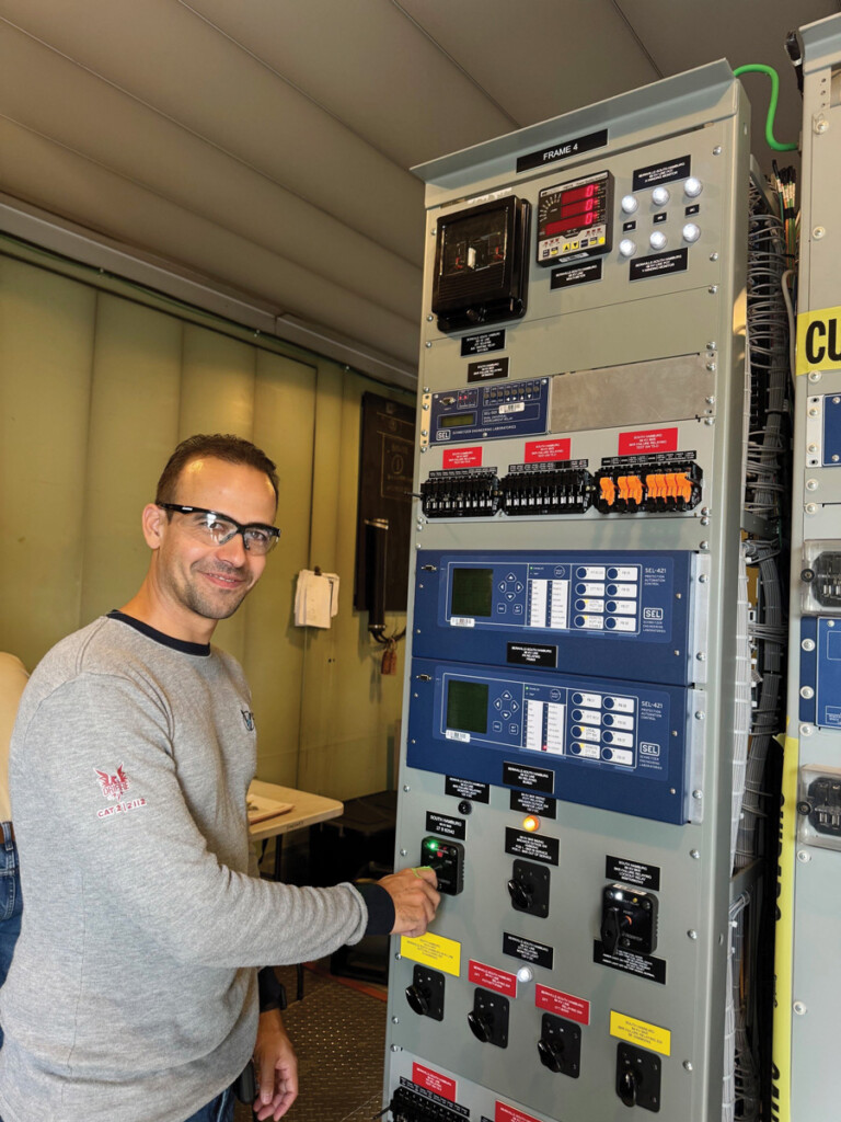

The Starting Point: Turn It Off!
My guess is you treat switching operations like surgery—plan the task, determine the proper shutdown sequence, see which loads are affected, check the one-line diagrams, verify the labels, double-check the switching order, figure out the lockout/tagout needs, and execute the tasks.
Dangerous? It can be, but you have likely put a lot of brain cells into the situation to help minimize risk.

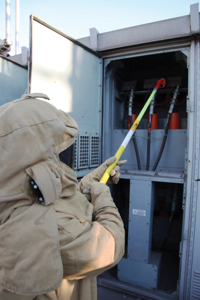

Testing for voltage using portable test instruments.
Arguably, NFPA 70E® doesn’t treat switching as the riskiest moment in electrical work. Your real exposure shows up in using portable meters to test and verify energized electrical conductors and circuit parts.
That includes testing for the absence of voltage, testing for the presence of voltage, troubleshooting, load checks, verifying lockout scenarios, proving circuits before touching them…anything involving portable test instruments.
You do this work every day. You also have opportunities to take more shortcuts here than anywhere else.
These exposure combinations will likely put you closer to an arc or shock event than a breaker operation or a switching procedure, not to mention how many times a day you might (or should) be doing this.
Portable metering steps place your hands and body closer to energized parts than switching ever does.
  • You lean in.
  • You open covers.
  • You reach into unknown conditions.
NFPA 70E COVERS IT
NFPA 70E®, Standard for Electrical Safety in the Workplace®, centers your risk right here, and it addresses the process for verifying the absence of voltage in a few key sections. The primary procedure for verifying absence of voltage is detailed in Section 120.6, and it is supported by additional test instrument requirements in 110.6(E), as well as lockout/tagout procedural elements in 120.5(B)(6).
Section 120.6, Process for Establishing and Verifying an Electrically Safe Work Condition, details step-by-step procedures, including:
  • Using an adequately rated portable test instrument
  • Testing each phase conductor or circuit part, both phase-to-phase and phase-to-ground
Section 110.6(E) Operation Verification, provides guidance on verifying the test instrument’s operation on a known voltage source before and after testing for the absence of voltage.

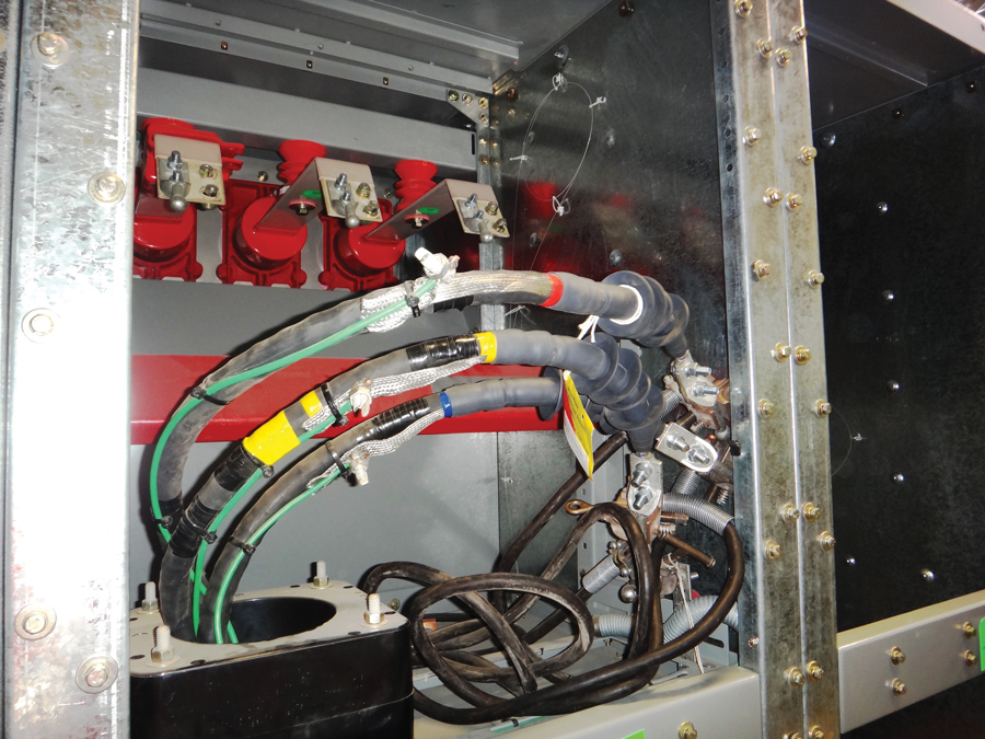

REMBEMBER THIS: DON’T MAKE TEMPORARY PROTECTIVE GROUNDS THE MISSING CONTROL POINT
OK, you’ve tested the system for absence of voltage (70E requires us to test for the absence of voltage “at each point of work.”) and you have locked out everything. What needs to happen before you actually work on the equipment?
You should be placing temporary protective grounds on large systems after testing for voltage…and I’ll bet you rarely ground the smaller systems down the line. NFPA 70E addresses temporary protective grounding as a requirement, not an option, so be careful here.
Those requirements are addressed in Section 120.6(8) Process for Establishing and Verifying an Electrically Safe Work Condition, where 70E tells us that temporary protective grounding equipment is required where there is a possibility of induced voltages, stored electrical energy, or the potential for contact with energized conductors during the work.
An increase in the risk of injury shows up when:
  • Induced voltage sits on isolated conductors.
  • Backfeed appears through control circuits.
  • Capacitors have a residual charge.
  • Parallel feeders share stray voltages.
  • Temporary generation is misapplied.
  • Tie breaker or alternate feed circuits are coming from a different source.
You test it once, and you remove your rubber insulating gloves. You ASSume the circuit is safe. But what about all of the touch points? Did you map all of the possible scenarios, even on the smaller circuits? Did you sweep all of the exposed conductors and circuit parts? It’s “the other parts” that can sneak up and get you with unexpected energy that finds your hands and body.
