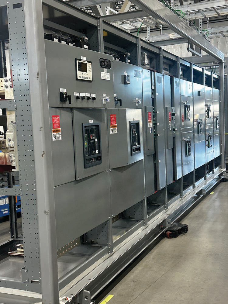

To meet schedule demands, many owners now elect to have switchgear assembled off-site and delivered as completed substations or modular skids. Medium-voltage and low-voltage skids are increasingly manufactured with breakers installed, cables pre-terminated, and protective devices programmed prior to delivery. While this approach reduces on-site construction time and improves quality control in a controlled environment, it introduces new challenges for acceptance testing once the equipment arrives at the data center.

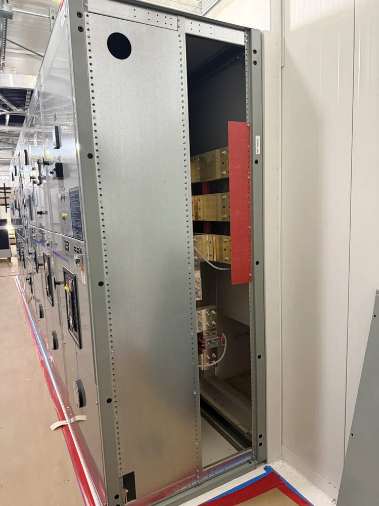

Low-voltage modular skids (Photo 1) are typically mounted on elevated steel frames, often more than 12 inches above grade. This configuration can significantly restrict access for high-current test equipment, lifting devices, and test leads. Physical access limitations can make traditional primary injection testing difficult or, in some cases, impractical. One effective approach is to perform component testing on the warehouse floor before skid assembly. Testing breakers, protective relays, and other devices before assembly allows technicians to perform thorough inspections and testing without the spatial constraints imposed by the skid structure.
Photo 1: A Modular Skid Assembled in the Factory
After skid assembly, the common bus can be tested to verify continuity, proper connection of bus joints, and the absence of shorts or grounds. Acceptance testing performed at skid facilities is often faster, cleaner, and more efficient; however, it must be carefully coordinated with the owner, the engineer of record, and the testing firm to ensure that test scope, documentation, and responsibilities are clearly defined.
Testing equipment before final installation can reduce the effectiveness of acceptance testing if not properly managed. Errors introduced during final assembly, transportation, or field installation may go undetected if testing is completed too early. For this reason, the ideal scenario is to perform acceptance testing once equipment is installed in its final position and before it is energized. This approach ensures that any issues resulting from handling, installation, or final connections are identified and corrected.

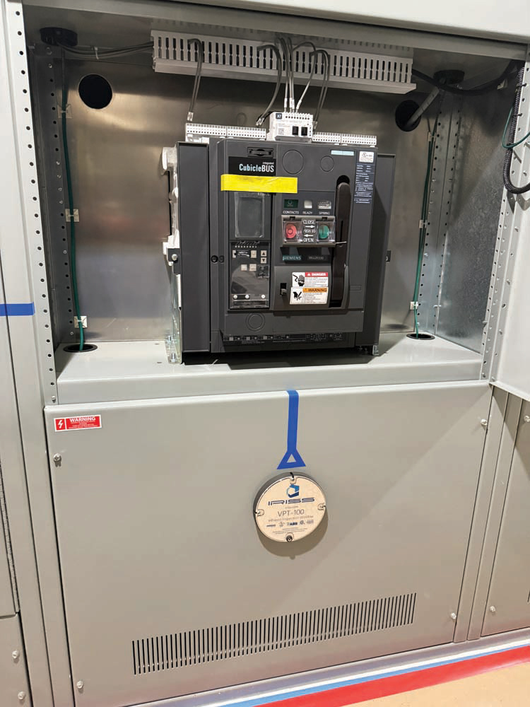

Some clients do not approve of off-site testing or require all devices to be retested at the destination. In certain cases, bolt-in low-voltage circuit breakers (Photo 2a and 2b) cannot be removed once installed due to enclosure design or skid configuration. Removing these breakers can be extremely difficult and time-consuming, often requiring partial disassembly of the enclosure or surrounding equipment.
In these situations, and only with full client knowledge and approval, alternative test methods such as primary current verification may be considered. This method uses a smaller current source to verify current transformers and control wiring by measuring primary current at the trip unit, followed by secondary injection of the trip unit itself. Because this approach is not a NETA-approved test method, it must be clearly documented and approved by the customer as a deviation from standard testing requirements. The objective remains unchanged: Verify that equipment is functional, reliable, and safe to energize without causing damage.

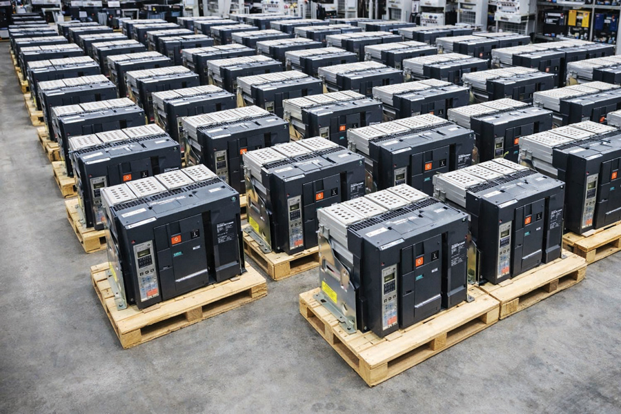

Another major challenge in data center acceptance testing is verifying short-circuit and coordination settings across large populations of low-voltage circuit breakers (Photo 3).
Photo 3: Low-Voltage Circuit Breakers in Just One Electrical Room

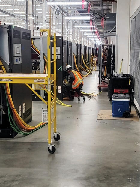

A single electrical room may contain hundreds of devices (Photo 4), and this number multiplies rapidly across a multi-building campus. While verifying breaker functionality is essential, improper coordination can result in nuisance tripping, loss of redundancy, or failure to isolate faults appropriately.
Photo 4: Numerous Power Distribution Units Installed in an Electrical Room

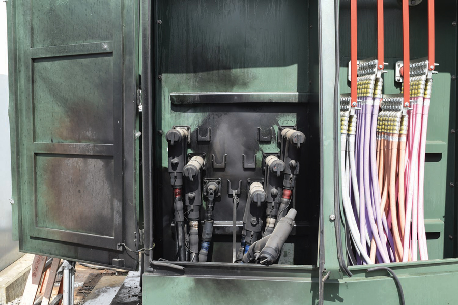

The destructive potential of electrical faults (Photo 5) is well documented. Even something as minor as a loose control wire can initiate a severe fault if it contacts an energized bus.
Photo 5: Transformer Fault Showing Internal Damage

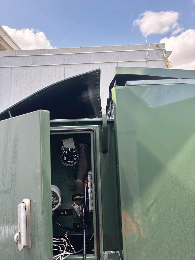

Internal faults within switchgear or transformers can cause extensive equipment damage (Photo 6) and pose serious hazards to personnel. While modern arc-resistant designs and safety procedures reduce risk, the most effective protection is identifying and correcting deficiencies during acceptance testing.
Photo 6: Equipment Damage from a Catastrophic Fault

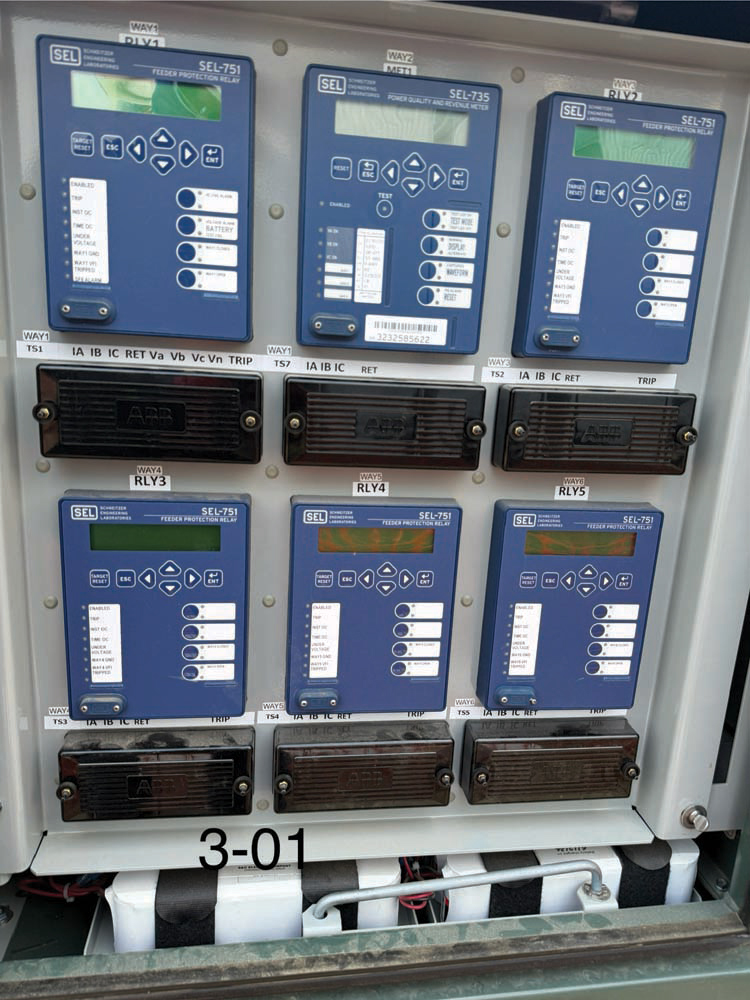

Communication systems add another layer of complexity. Modern data centers rely heavily on digital communication between relays (Photo 7), meters, controllers, and building management systems.
Photo 7: Protective Relays Using Fiber Outputs to Control the Automation
IEC 61850, Modbus, DNP3, and proprietary protocols are used, often in combination. Commissioning must verify not only that devices communicate, but also that they exchange the correct information with the correct devices, using the correct logic and priorities. A communication failure may not immediately trip a breaker, but it can prevent alarms, inhibit automated sequences, or delay fault clearing during an emergency.
