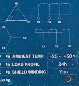

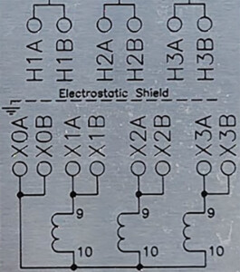

If you’ve worked on transformers in renewable energy circuits, as I have for the past six months, you’ve likely seen many—perhaps most—equipped with electrostatic shields, grounded copper or aluminum sheets wedged between the high- and low-side windings. The existence of these shields inside transformers is normally (but not always) readily identifiable via the unit data plates (Figure 1). Some affirm the presence of a shield with a grounded, dotted line running between the windings; others label the dotted line with “Electrostatic Shield” or “ESS”; others indicate the shield with a simple “Yes.”

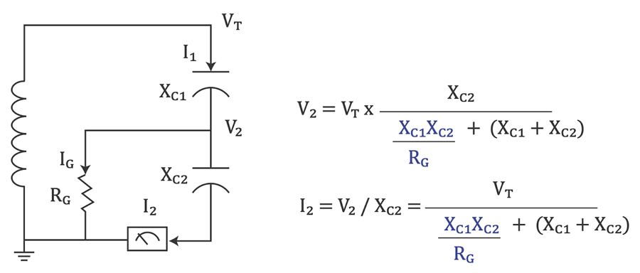

A common cause of negative power factor measurements is an unknown path for resistive current back to the source, typically via ground. How this is possible can be explained as follows. Suppose a technician performs a power factor test on an asset as illustrated in Figure 4.
Figure 4: Negative Power Factor Model (Pong, 2022)
The technician may think that the asset is composed simply of one capacitive layer, but suppose a surreptitious path RG  for resistive current IGback to the source exists somewhere in the middle of the asset. Such a path would split the single capacitive layer of the asset into two distinct, capacitively reactive layers, XC1 and XC2. The power factor test set calculates the power factor by measuring the phase angle between the test voltage VT and the current that enters its ammeter, I2.
But if the current that is supposed to enter the ammeter instead bypasses the ammeter on its way back to the test set, that current being IG, the test set will erroneously calculate the power factor. The test set sees the true test voltage, but it does not see the true total current, I2 + IG, otherwise known as I1. It only sees I2.
Let’s use some numbers. Suppose VT is 100V, XC1 and XC2 = 100Ω, and RG = 1000Ω. In that case, the current I2 that flows through the test set ammeter using the equation in Figure 5 will be:
This value of I2 converts to 0.499A ∠ 92.86° when switching from rectangular to polar coordinates. The test set sees this amperage, concludes that angle θ equals 92.86°, and calculates the power factor as cosine (92.86°) equals -0.0499. Behold, negative power factor!
The key in this erroneous calculation is the ammeter placement. If the ammeter was between the test set and the ground connection, it would intercept all current I1, including resistive current IG, and the power factor calculation would instead be:
This value simplifies to a power factor of 0.0497.
In the case of a shielded transformer, XC1 + XC2 represents the capacitive reactance of CHL, and RG represents the electrostatic shield acting as a path back to the source that splits CHL into two capacitances. Because the shield redirects the vast majority of the current from the UST ammeter to the GST-G ammeter during power factor tests, USTs tend to render small or even negative values for CHL, as is evidenced by Table 1. Pong (2002) has a highly recommended and masterful discussion on this topic.
