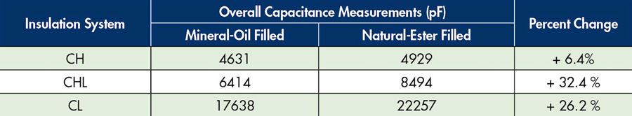

Changes to the insulating fluid of a transformer will result in a change in the overall capacitance. For example, a transformer tested with mineral oil will inherently have higher capacitance than a transformer filled with dry air. Note that overall tests performed in the absence of its intended insulating liquid should be tested at a reduced voltage to prevent insulation damage.
For example, consider the overall capacitance measurements of the two-winding, 230-kV to 13.8-kV YNyn, 100-MVA transformer shown in Table 1. This transformer was filled with mineral oil in the factory and with natural ester fluid in the field. The increase in the insulating liquid’s permittivity will cause the overall capacitance to increase. The magnitude of the increase will vary for each insulation system, depending on the volume of contributing insulating liquid.
Table 1: Overall Capacitance vs. Fluid Type

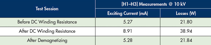

Single-Phase Exciting Current and Loss
Tap changer positions will play a role in the behavior of the exciting current and losses under single-phase excitation. Changes to the energized winding’s number of effective turns will change the magnetic flux, thereby changing the exciting current and losses. The tap position of lower-voltage windings (i.e., an on-load tap changer on the LV winding) may cause intentional loads during this open-circuit test, resulting in a change to the measured exciting current and losses. Such intentional loads include preventive autotransformers used with reactive-type on-load tap changers and/or series transformers.
As demonstrated in Table 2, the effects of residual magnetism are commonly observed during the single-phase exciting current and loss measurements. Efforts to demagnetize the transformer core are often successful at reducing the impact of the core’s magnetic state. Notably, the core’s magnetic state is constantly changing, even without external influence, due to the effects of magnetic viscosity.

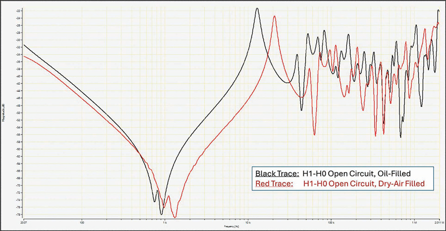

Figure 1 demonstrates a situation where the manufacturer performed a shipping-condition SFRA, but with the tank filled with mineral oil. After the transformer was received in the field, SFRA measurements were repeated with the transformer tank drained. Changes to the frequency response, particularly the resonance frequencies, are expected for this difference in insulating medium. Because air has a relative permittivity lower than mineral oil, the frequency response is expected to shift towards higher frequencies.
Figure 1: HV Open Circuit Response of a YNyn Transformer Tested in Empty and Oil-Filled Conditions

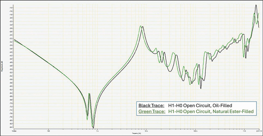

In Figure 2, the SFRA tests were made on the same transformer while the core and coil assembly was immersed in different insulating liquids. Knowing the difference in insulating liquid sets an expectation of frequency response shift. For example, because the relative permittivity of natural ester is higher than that of mineral oil, it is expected that the trace shifts toward lower frequencies. If this situation was not documented in the test records, suspicions of physical change may be justified.
Figure 2: HV Open Circuit Response of a YNyn Transformer Tested with Mineral Oil and Natural Ester
