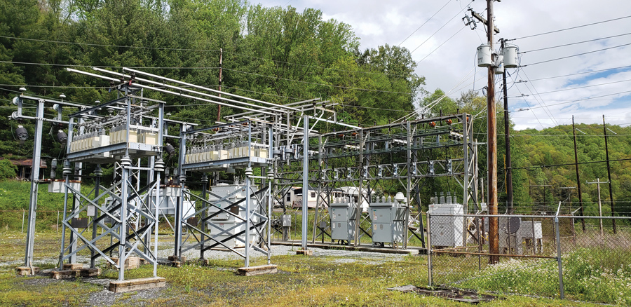

This older distribution substation has minimal rock with a lot of grass and weeds—precisely what you want to avoid.

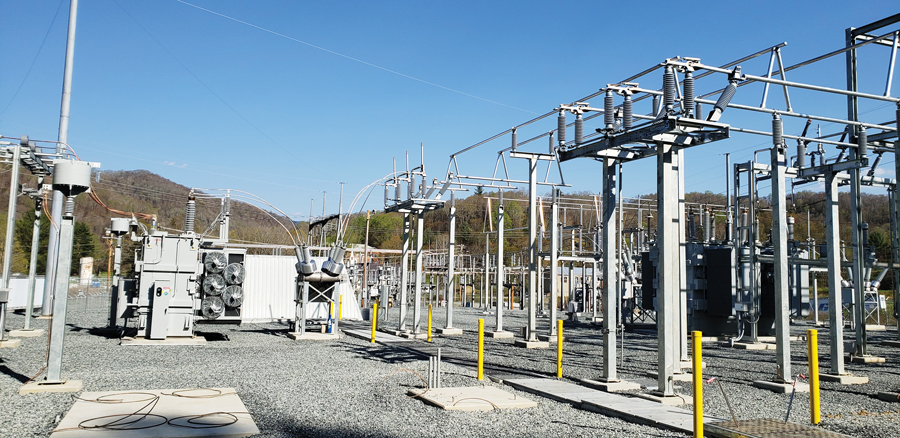

Regular inspections to maintain the rock layer depth are critical to substation safety.

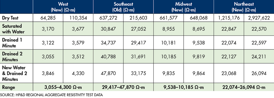

In November 2025, the IEEE PES Substations Committee released IEEE Std. 81-2025, IEEE Guide for Measuring Earth Resistivity, Ground Impedance, and Surface Potentials of a Grounding System. Per this newest version of IEEE 81 Section 11, Annex E, and Annex F, we now have guidelines for testing the aggregate resistivity of substations. This is significant because most ground grid designs default to a crushed aggregate resistivity of 2,000–3,000 ohm-meters (Ω-m), which is likely a conservative assumption that results in over-engineering the ground grid. Testing the aggregate resistivity will allow a more accurate design of the ground grid. Conversely, lower assumed aggregate values can result in measured touch potentials exceeding the overly conservative calculated permissible values.
IEEE Std. 80-2013, IEEE Guide for Safety in AC Substation Grounding,outlines “typical surface material resistivities,” but our testing has revealed that the data is incomplete and may not be indicative of aggregate values nationwide. As shown in Table 1, regional samples vary widely; hence, it is necessary to test your aggregate not only per region but also per site, as many factors can affect aggregate resistivity and, therefore, substation safety. Not all utilities in a region may be using the same type of stone, so the values shown in the table are for a specific region, utility, and site.
Table 1: Regional Aggregate Resistivity Samples
