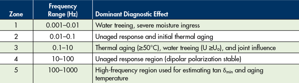

The XLPE insulation response can therefore be segmented into five diagnostic frequency zones (Figure 1), each corresponding to a dominant physical mechanism and distinct degradation behavior (Table 1). This zonal segmentation allows utilities to evaluate tan delta trends with respect to the underlying aging process rather than relying solely on a single-point VLF tan delta at 0.1 Hz.
Table 1: Frequency Zone for DFR Interpretation

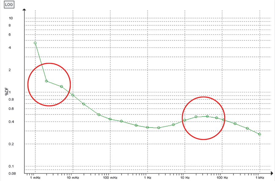

When the actual DFR curve is mapped onto this framework (Figure 5), several termination-specific observations become clear. At ultra-low frequencies (<10 mHz), the measured tan delta reaches approximately 4–5%, far higher than what is typically expected for a well-sealed, dry termination. This behavior strongly suggests moisture presence inside the termination enclosure or migrating along the XLPE surface, causing ionic conduction and interfacial polarization.
Figure 5: Frequency Response Analysis of Cable Termination and XLPE Insulation
In the 10–100 mHz range (Zone 2), the curve steadily declines but remains elevated, indicating a combination of thermal and moisture-driven dielectric relaxation. The slope observed in this region resembles laboratory data from thermally stressed termination samples, where warming of the stress-control tube and semicon layers increased low-frequency losses.
Mid-frequency behavior (0.1–10 Hz) shows a defined tan delta minimum around 0.3–0.4%. Comparing mid-frequency with the master curve[3] clearly shows a normal curve with a minimum difference, proving that the cable and termination have not experienced any high temperature above 50.
At higher frequencies (100–1,000 Hz), the upward trend in the DFR curve corresponds to thermal activation and semicon resistivity effects typically observed in cable terminations. Installation-related defects—such as improper wrapping of the yellow stress-control tape, incorrect semicon cutbacks, conductor-interface heating, and overheating of the heat-shrink tube—create localized regions of elevated electrical stress.
Furthermore, semiconductive layers exhibit strong temperature-dependent resistivity behavior, with resistivity rising significantly as temperature increases.[9] Because stress-control tubing and semicon materials are more temperature-sensitive than bulk XLPE, even moderate heating steepens the high-frequency conduction slope, a phenomenon consistent with the positive temperature coefficient (PTC) behavior observed in semicon shields.[9] This aligns with research showing that terminations often fail due to a combination of workmanship errors and thermally activated interface defects, which amplify dielectric losses across the frequency spectrum.[7]
In summary, the DFR curve indicates that the termination exhibits moisture ingress and early-stage moisture ingress near the XLPE/stress-cone interface, accompanied by thermal effects and moderate interface aging, while the bulk XLPE remains functional.
