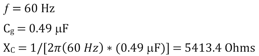

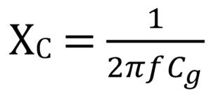

Voltage-based protection, such as measuring the voltage drop across the neutral grounding resistor (RN), is used for stator ground fault protection since the ground current magnitude in the stator is very low (e.g., 5 amps primary or less). Equation 1 calculates the distributed capacitive reactance.
[Equation 1]

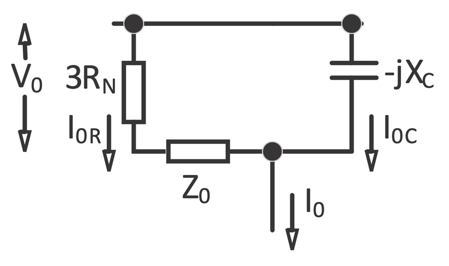

The 60 Hz component neutral current flowing on the secondary side of the grounding bank (Figure 3) is calculated as follows for a ground located at the generator terminals:
Figure 3: Zero-Sequence Network
This large neutral current flows into the generator relay neutral current input (IN) and can swamp the input circuitry. A 5.0 Ohm resistor would limit the secondary current to 48 amps.
