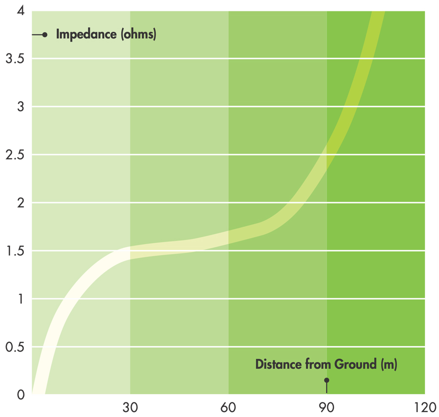

The FOP method is the most commonly specified ground-grid test method. It was developed in the 1930s, when the United States was less developed. Proper setup includes locating the current return probe at a minimum of five times the diagonal of the site under test. The larger the site, the longer the distance required — up to 10 times the diagonal. The potential (voltage) probe should be located every 10% of the current return distance, looking for a plateau in the measurements, which should theoretically be at 61.8% of the distance to the current return (Figure 1).
Figure 1: The ground grid impedance value is the plateau at around 62% of the measured distance.

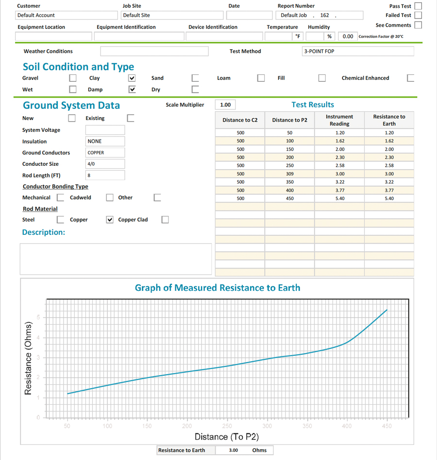

Example 1 – Not Enough Data
In the real world, the expected curve with a plateau at 62% doesn’t always show up (Figure 2). While this curve doesn’t line up with the traditional curve shown in Figure 1, the data may still be valid. To improve the results, increase the resolution of the curve by adding additional test points. Greater resolution may show the plateau.
Figure 2: The expected plateau at 62% is missing.
It is also possible that the data/curve is affected by other buried objects. Ensure you are paying attention to the test area and noting buried pipelines, fences, etc., that could affect the results. This report is also missing information required to verify or replicate the results. The site address (or GPS coordinates), test direction, and current probe placement are not included. Since the size of the site could not be verified, it is also possible that the current return probe was not placed far enough away from the site under test — a very common testing mistake.

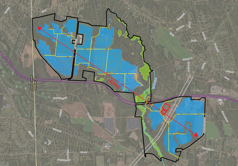

An engineering firm was hired to perform FOP testing on the two substations with a shared ground grid (Figure 3, red squares). The larger red square is the collector yard, and the smaller one is the utility’s point of interconnect (POI). The diagonal of the two substations is 500 feet, so the planned FOP current probe was placed 2,500 feet away (green line). The measured impedance was reported as 7.4 ohms while the design value was 0.89 ohms. This discrepancy in values was a red flag that something was off.
Figure 3: Nearby sites must be investigated for potential bonding to the site under test.
Next, a testing firm was brought in. They essentially repeated the same method, going in a different direction with their current wire (yellow line). They obtained a value of 1.48 ohms at 62%. This value was lower but still above the desired 1-ohm design value.
Next, we were hired to test this site with the specialized, computer-based smart ground multimeter (SGM) prescribed in IEEE Std. 81. After our initial test, a high error in the SGM data reported by the SGM software indicated that something was amiss. We discovered that the solar arrays were bonded to the inverters, which were then bonded to the substations through the concentric neutrals. The new diagonal of the combined sites is now 6,600 feet. For FOP testing, the current return probe should have been placed at five times 6,600 feet, which equals 33,000 feet or 6.25 miles (Figure 4).
Figure 4: The solar arrays were bonded to the substations, making the required diagonal distance for FOP to remote earth 6.25 miles.
The site had a significant amount of metallic interference, including fencing (black lines), railroad tracks (purple line), a transmission line (dashed white lines), and the arrays themselves (blue figures). Due to the size, surrounding interferences, and the fact that the utility’s substation was bonded and energized, it is impossible to test this site with the FOP method.
The SGM allows testing in these conditions if aided by a software model of the ground grid and other connected sites and grounded objects. We reduced the required remote earth distance by disconnecting the concentric neutrals from the inverters, isolating the substation grids from the solar arrays. Although we were still bonded to the utility system, the site could now be tested with the SGM. We measured 0.74 ohms versus the design value of 0.89 ohms.
