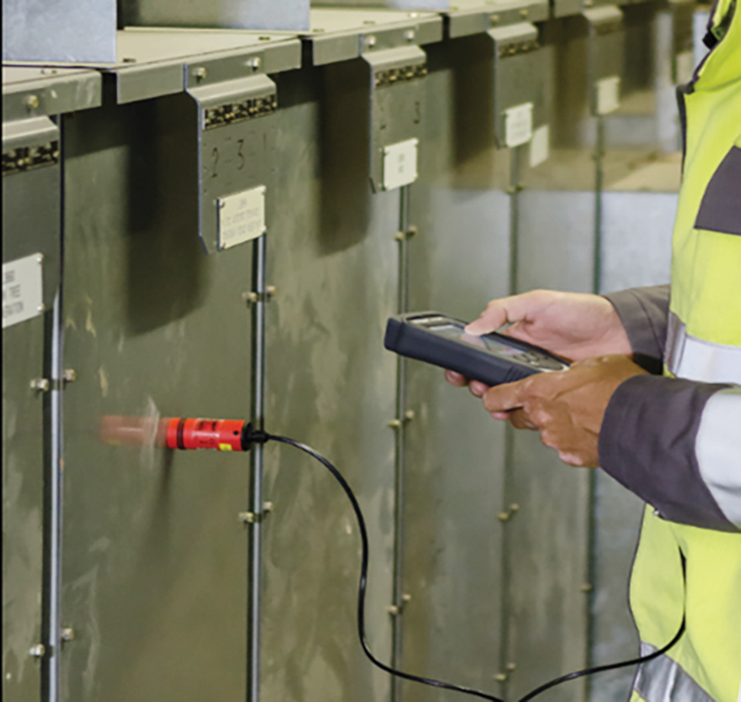

Figure 1: Contact-Type Sensor, Usually for TEV or Contact-Type Acoustic

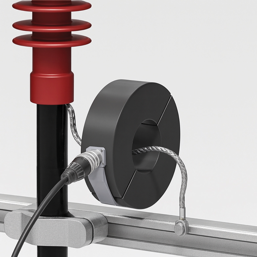

  • Clamp-on high-frequency current transformers (HFCTs) are widely used in portable PD surveys. Installed on grounding leads, they detect high-frequency PD currents as they return to ground. HFCTs are sensitive, easy to deploy, and suitable for many types of medium-voltage assets.
  • Transient earth voltage (TEV) sensorsdetect electromagnetic pulses that strike metal surfaces and travel to ground. They are particularly useful for switchgear and other metal-enclosed equipment where internal PD can couple effectively to grounded enclosures.
Figure 5: HFCT Clamped on the Cable Termination at the Grounded Cable Gland

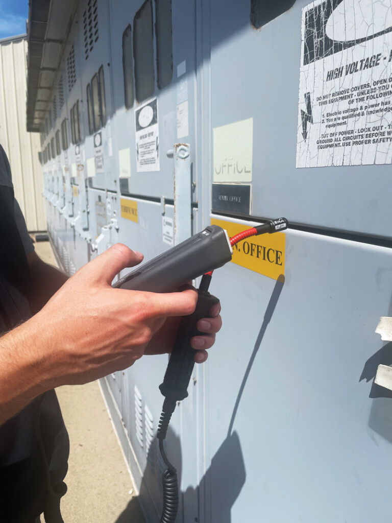

  • PD activity also produces tiny mechanical vibrations, and acoustic sensors — such as ultrasonic microphones or contact probes — capture these sound waves, making them useful for detecting surface PD or corona activity, especially in switchgear or open bus structures. This method is based on the vibration of air molecules caused by PD rather than the electrical signal itself, and the results are very sensitive to the distance from the defect location.
Figure 6: Acoustic PD Measurement Using an Airborne Sensor

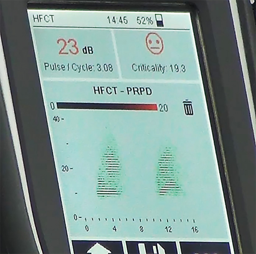

While on-line PD measurement is a powerful tool for assessing insulation condition under real operating stresses, it is not without challenges. One of the primary obstacles is the presence of electrical noise and disturbances in field environments. Modern MV systems are filled with switching devices, power electronics, and background electromagnetic activity that generate signals in the same frequency range as PD. These external disturbances can easily mask or mimic true PD activity, complicating the interpretation of results.

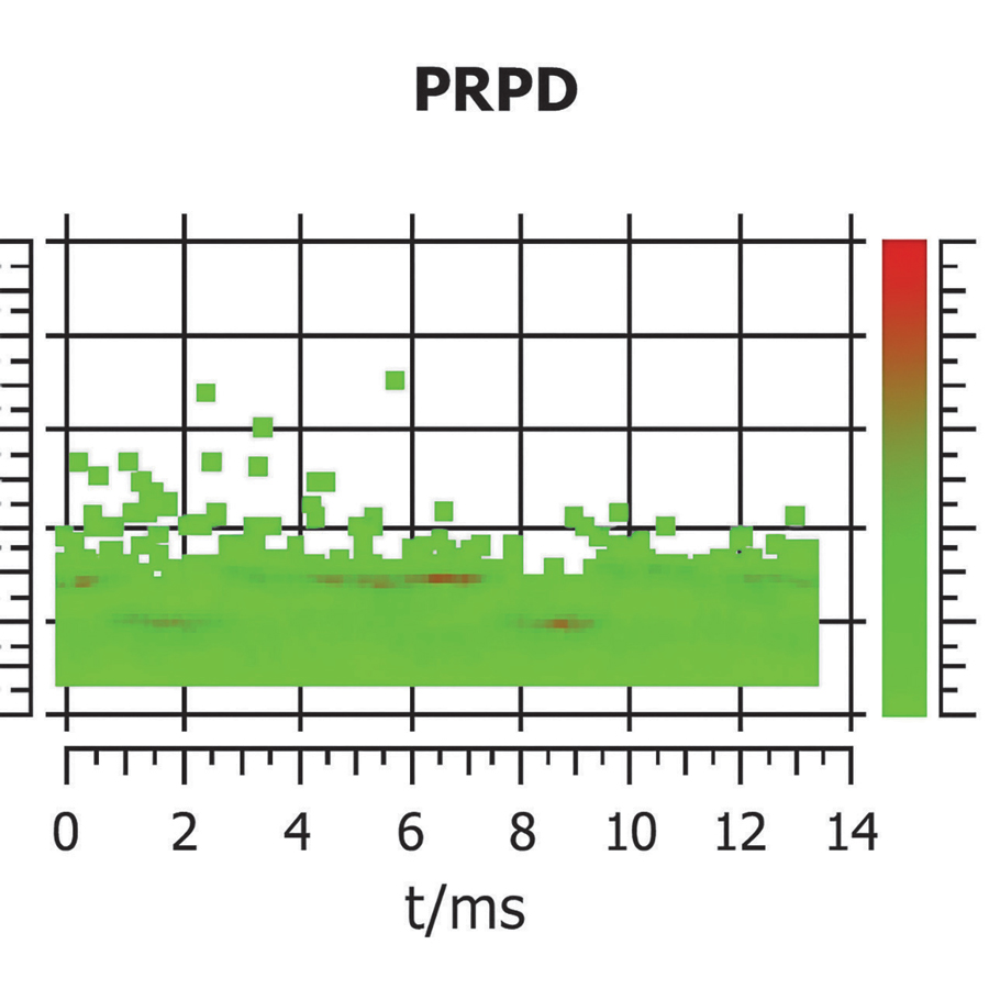

In practice, this means that weak PD signals — especially those originating from defects located farther away from the sensor — may be hidden beneath stronger noise. As a result, real insulation defects can remain undetected if their discharge activity does not rise above the noise floor. For example, a void discharge inside a cable joint may be overlooked when high background interference from variable frequency drives or corona on nearby hardware dominates the measurement.
Figure 7: PRPD Patterns Captured with HFCT Confirming a Valid PD Defect
Another challenge lies in the variability of PD propagation paths. PD signals attenuate as they travel through insulation, conductors, and grounding systems, and their strength decreases with distance from the source. When combined with strong external noise, this attenuation can further reduce the likelihood of detecting subtle but important defects.
To address these issues, practitioners often use multiple sensors, advanced filtering, and pattern recognition techniques to separate real PD from noise. Even so, interpretation requires experience, and there is always a risk of missing early-stage defects if they are weak or obscured. Recognizing these limitations is critical: While on-line PD testing provides valuable insight, it should be complemented with other diagnostic methods and careful judgment to ensure a reliable insulation assessment.
Figure 8: A PRPD pattern influenced by strong noise and disturbances is difficult to interpret, possibly due to incorrect measurement settings.
