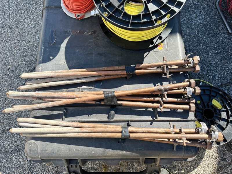

  7. Be aware of extremely dry or high resistivity (sandy or rocky) soil that may require:
    a. Extra probes at each probe location
    i. We’ve used up to four 4-foot probes in a single location to increase current flow and reduce probe resistance.
    b. Longer probes (2 feet typically, may need 4+ feet)
    c. Add water/salt to reduce the probe-to-soil resistance and increase current flow.
    i. Specifications frequently say this is not allowed, but it is often necessary to achieve enough current flow for successful testing.
    ii. This is included/recommended in IEEE Std. 81 6.2
Soil resistivity testing requires sturdy, conductive probes.

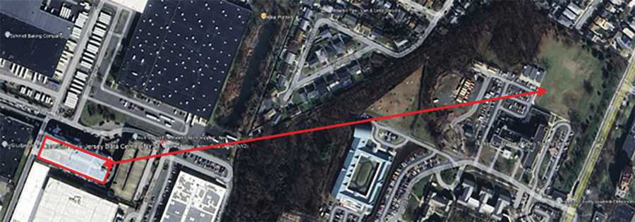

An existing data center planned a new building next door in place of an existing parking lot, and the electric utility required soil resistivity measurements (Figure 4). The closest suitable area for measurements (red arrow) was ½ mile away – not ideal, but the best that the site location and conditions would allow. Testing site access can have unique circumstances. In this case, the owner of the testing site, a mental health facility, had patient safety concerns regarding the injected current on their property. After careful explanation of our testing process, we were granted access. Be prepared to explain to a site owner what you are doing, especially when accessing private property.
Figure 4: The closest suitable area for measurement was a half-mile away.

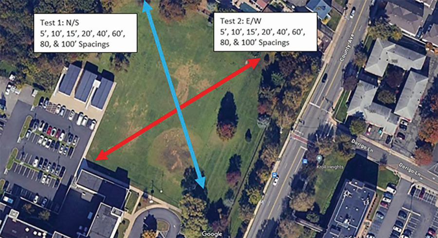

A densely developed college campus required soil resistivity data to design a new, dedicated grounding system for lab test equipment (Figure 5). The area next to the lab was heavily wooded and included underground utilities. Measurements taken in this area were inconsistent, making the data unreliable. The closest suitable location was a ½ mile away, where two diagonal traverses were measured with 100-foot spacings. In urban and suburban areas, athletic fields, golf courses, and parks are tempting measurement sites. While these may be the best or only nearby options, watch out for buried irrigation systems, lighting circuits, and other underground objects that may influence results.
Figure 5: Results can be influenced by underground utilities and buried objects.
