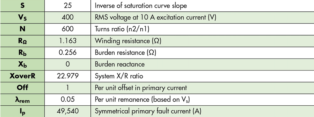

IEEE CT SATURATION CALCULATOR INPUTS
The low-side C200 CT performance was evaluated for an out-of-zone, three-phase fault using the IEEE PSRC CT Saturation Calculator.
Table 1: IEEE CT Saturation Calculator Inputs
The saturation calculator models the CT secondary current based on fault current, system X/R ratio, saturation voltage of the CT, secondary winding resistance, CT burden, remnant flux, per-unit fault current offset, and the CT S curve slope. Note: The highlighted numbers throughout the article indicate input to the calculator.

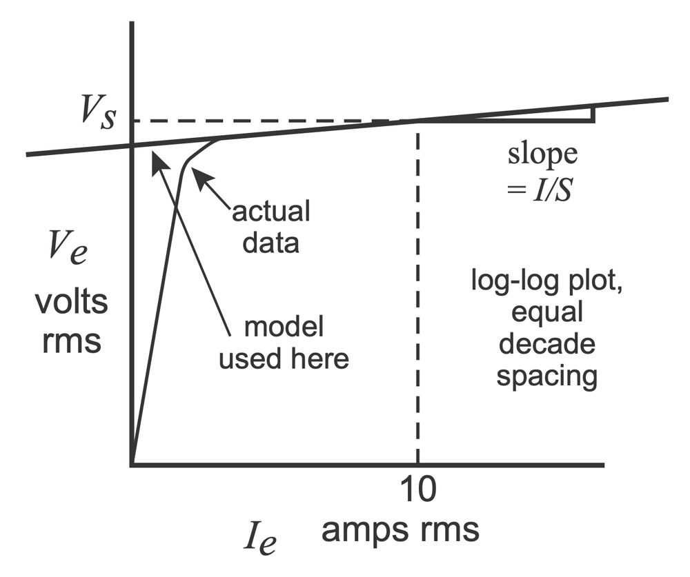

Figure 1: Method to Determine VS and S from the CT Excitation Curve
The straight-line curve with slope 1/S shown in Figure 1 is not linear. The curve is defined mathematically as:
[1]
Vi is the value of Ve for Ie equal to one amp; that is, log Ie equals zero. Resolving the logs yields:
[2]
Ve for an excitation current equal to one amp according to the C200 CT excitation curve is 210 volts. Vi is calculated for an excitation current equal to 10 amps, which yields the following value for S, solved iteratively:
370 * 101/S = 399.5
S = 25
RMS Voltage at 10 Amps Excitation Current
VS is determined by inspecting the C200 CT excitation curve:
VS = 400 V

N = 3000:5 = 600
CT Winding Resistance
The CT winding resistance is provided on the C200 CT excitation curve (62-400-066-XXX):
Rw = 1.163 Ω
Burden Resistance
The burden resistance consists of the relay current input and the leads to and from the CT:
Prelay = 0.5 VA @ 5 A (refer to page 1.14 of the SEL-487E instruction Manual Date Code 20240509)
X/R Ratio
The contractor stated: “The X/R ratio at guaranteed load losses (48 kW) is 18.974, and the ratio as expected losses after design (38 kW) is 22.979.”
DC Offset
Assume the worst case of a fully offset current waveform.
Per-Unit Remanence
Remanence is approximated closely by assuming the initial excitation curve is non-zero.
λrem is expressed in per unit of VS. To specify λrem accurately, specify x no greater than Vknee (see Figure 2).
Figure 2: Per-Unit Remanence
(IBase is the transformer full-load current with respect to the low-side winding)
x/y = 0.047
Symmetrical Primary Fault Current
Figure 3: Symmetrical Primary Fault Current Calculations (Mathcad)
IF = (82.57 A) * (3000:5) = 49,536 A primary
