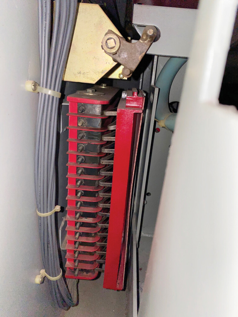

A notable example is a recent issue where a VCP-W 27 KV medium-voltage (MV) breaker failed to open electrically while the operator was attempting to bring a turbine generator off-line. With the breaker on the floor and using an external power source, everything worked perfectly. However, the breaker wouldn’t trip when placed in the test position. An attempt to use an available spare also failed to trip.
Electrical problem, right? Working through the control circuit, one device and interlock at a time, proper control voltage was found all the way up to the terminal strip that goes to the secondary contacts block. Inspection of the secondary block revealed that several pins had been pushed out of the block (Figure 1). This created an open circuit between the control system and the breaker. Correction of this mechanical issue fixed the breaker’s operation.
Figure 1: Secondary Block Pins Pushed Back

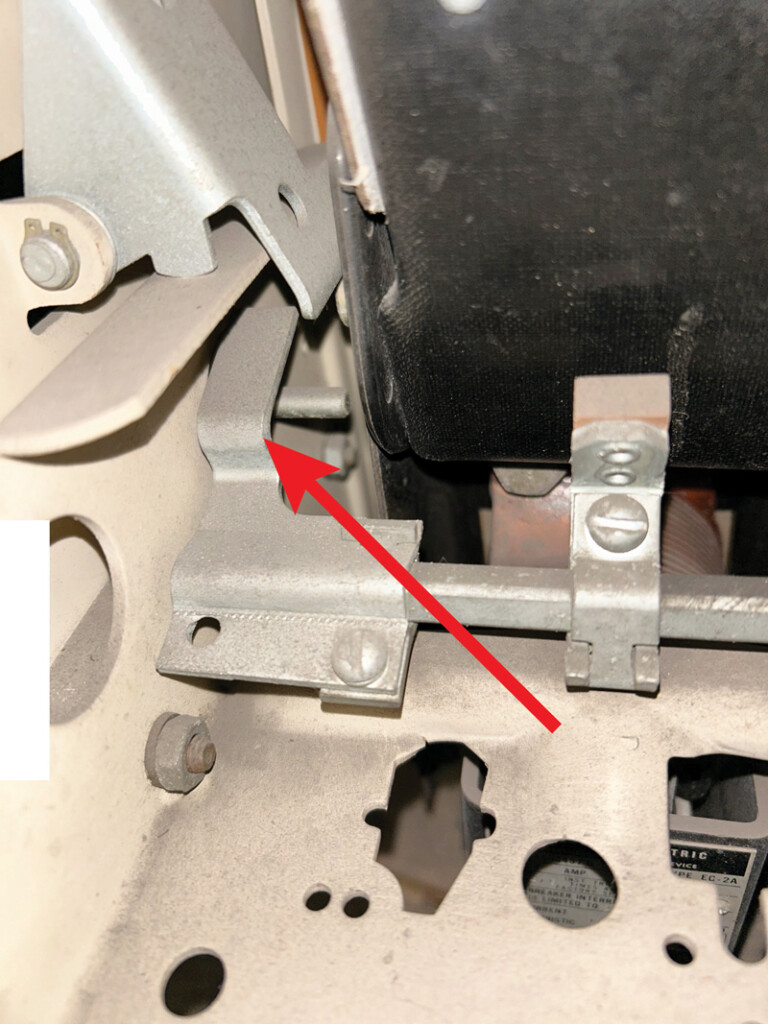

A related issue can occur on MV breakers with sliding secondary contact blocks like GMI and Allis-Chalmers breakers. It’s always frustrating at the end of the outage when you close the last breaker and nothing happens. Before you go through extensive troubleshooting and second-guessing whether that breaker you just tested works, grab a flashlight. Look closely at the left side of the cubicle and breaker to ensure that all the fingers of the breaker are in their grooves/slots (Figure 2). This problem occurs mostly in vintage gear that has had time to get out of square or if the floor plates are less than solid. Some of you know exactly what I’m talking about.
Figure 2: Allis Chalmers Secondary Block
It will take some mechanical work to get things to line up, and I just saved you hours of head scratching the next time your breaker doesn’t operate electrically.

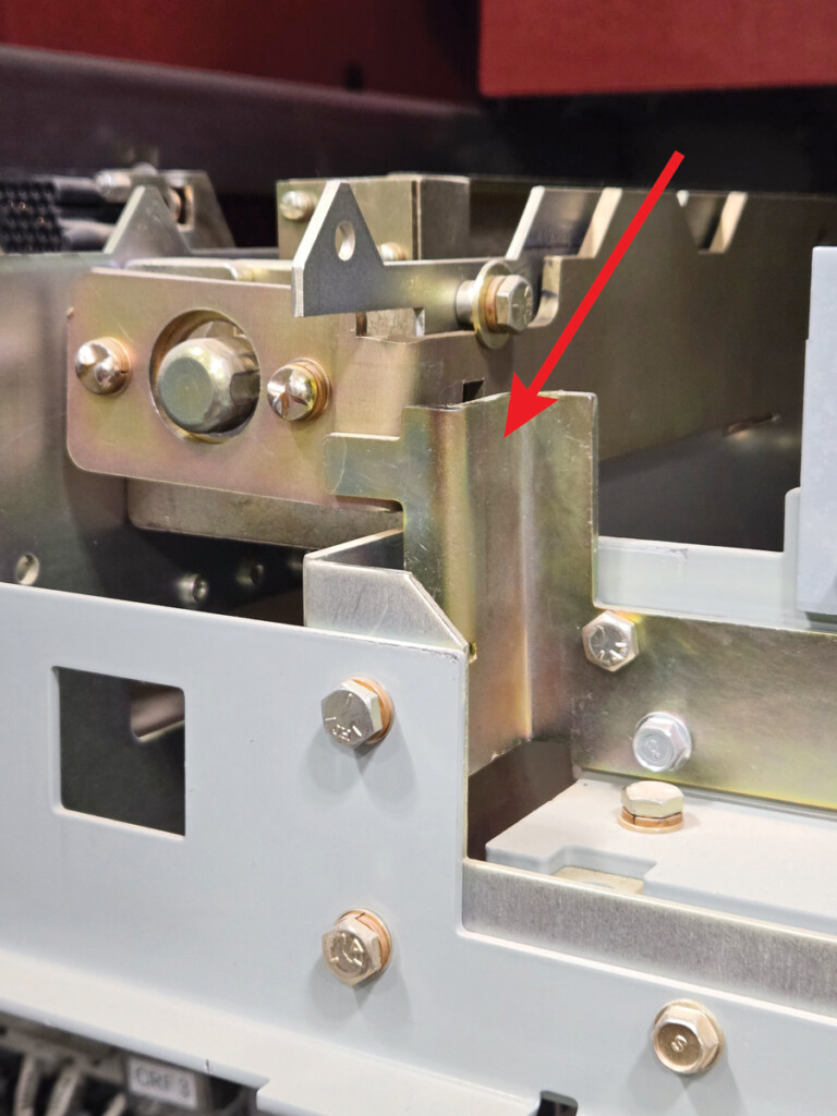

LV breakers with secondary connection/ contact, such as low-voltage (LV) Masterpact NW breakers, among others, can also have issues with secondary blocks. A recent installation identified numerous damaged secondaries (Figure 3).
Figure 3: Masterpact Secondary Block
The damage occurred when the secondaries of the breaker were binding on the cell side while being racked in. As a reminder, if you feel anything binding or otherwise unusual when racking, stop and investigate.

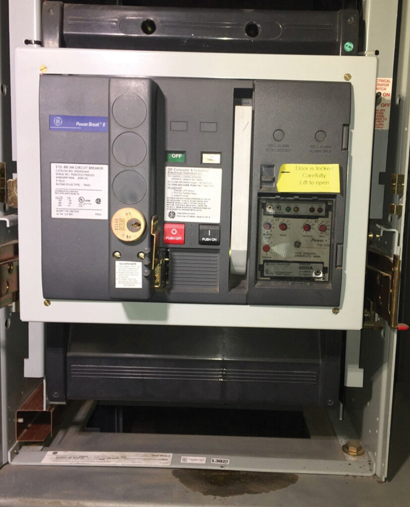

GE Power Break II (PBII)
If you come across one of these in the field, be prepared for this breaker not to close or charge if you open it. Unlike the AK, a little lubricant will not fix the issue. The issue with these breakers is the stop block (over-travel bumper). Over time, the bumper material degrades (Figure 5). This degradation allows the mechanism to overtravel, and the breaker trips free. In some cases, it won’t even allow the mechanism to charge. The fix requires removing the breaker from service and installing a new block kit. You can get more information by searching for DEH40466 Installation Instructions.
Figure 5: PowerBreak II Bumper Drippings
Pro-tip note: After closing a mechanically operated PBII breaker, manually charge the closing springs. This removes the force the mechanism places on the stop block, allowing the bumper to recover, in theory, extending its serviceable life. Other breakers with over-travel issues can include DBs, GE AKRs, and Siemens LAs.

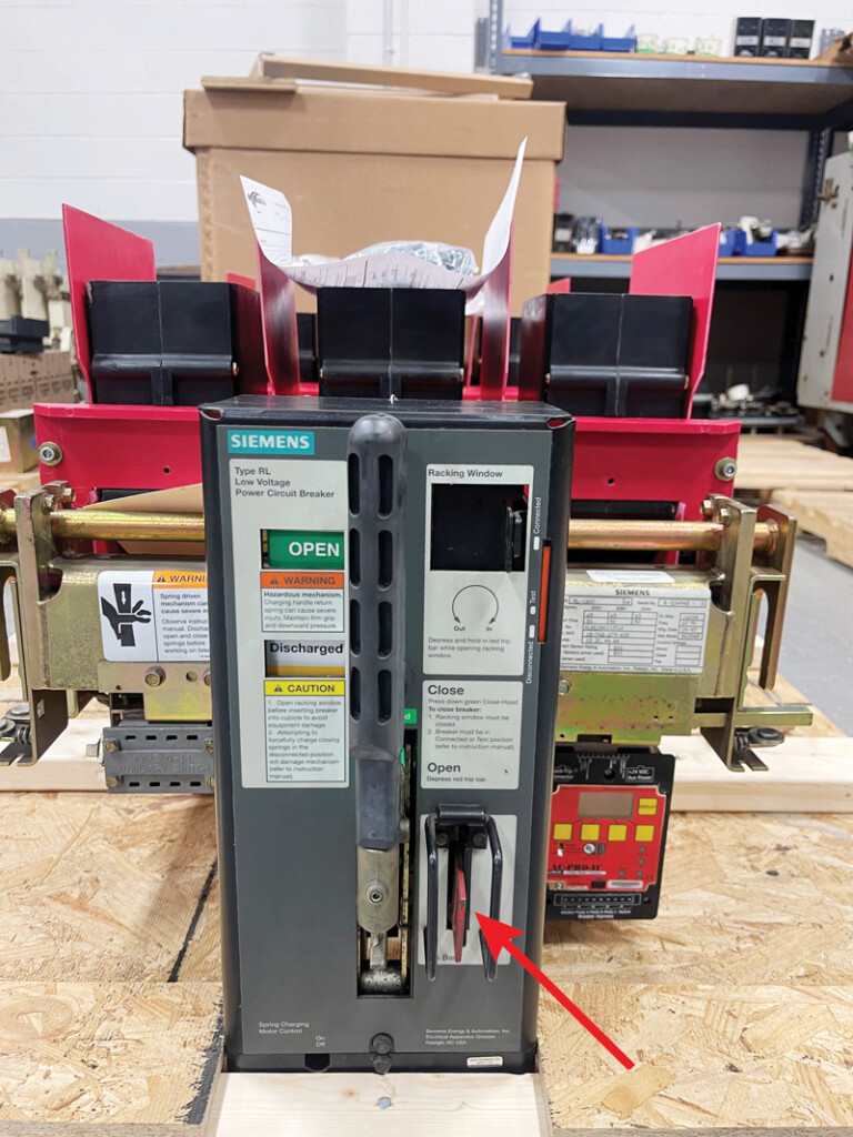

Siemens RL Breakers
Several things to remember when it comes to these breakers (Figure 7):
  • Broken phase barrier boards are routine, probably because they stick up above the frame and arc chutes. Handle with care.
  • These are difficult to close because the close hood is behind the charging handle. Many of us use the racking handle or a long screwdriver to close them.
  • Follow all instructions to avoid damaging the breaker while racking. Depress and hold the red trip bar while opening the racking window.
  • The RL discussion would be incomplete if I didn’t mention what a pain these can be to remove and reinstall the arc chutes for inspection of the breaker contacts.

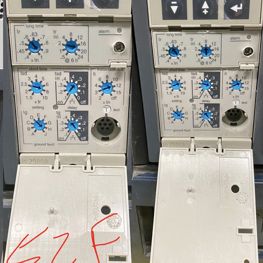

Have you ever done LV breaker testing and needed to change settings? Of course, you have. Have you ever forgotten to put them back to the as-found settings? I like to take a picture of the settings before the breaker leaves the cell, then a final picture when the breaker is back in the cell to compare with the previous pictured settings (Figure 10). The time stamps of the two pictures can be used to defend against any questions about possible setting discrepancies.
Figure 10: Our As-Left Settings (left); Changes by Others (right)
This information came in handy when another contractor (working for another person at the plant) was asked to make changes to breakers after we departed the site. When issues ensued with the changes that our plant contact was not aware of, the ability to be able to document the as-left settings absolved us of responsibility.
