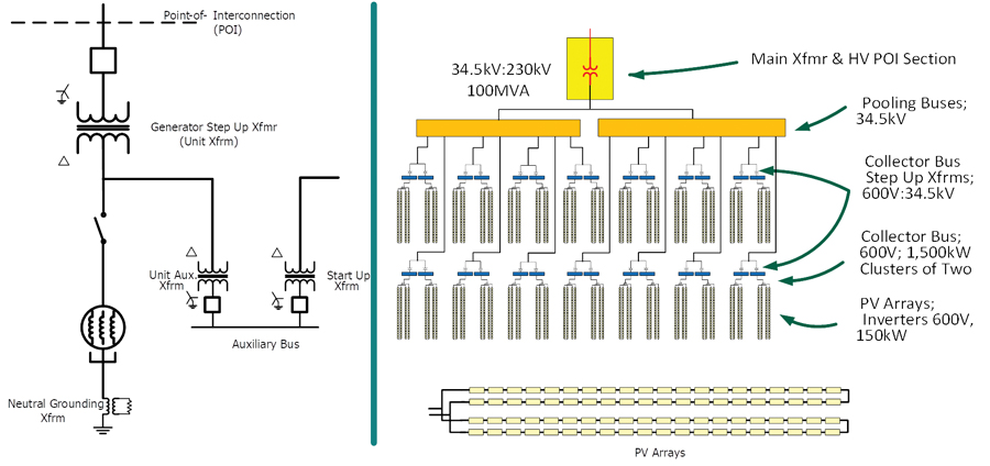

Figure 1 compares and contrasts a traditional utility-scale powerplant with a single power source with an IBR renewable plant with hundreds of smaller energy sources.
Figure 1: Comparison of Traditional and IBR Renewable Power Plants
The plant’s various buses and voltage levels are listed below:
  • Two identical PLBs are used, each with seven sources: air-insulated switchgear (AIS) and outdoor CBs.
  • Seven identical sources feed each PLB input.
  • The 28 CLBs are identical LV switchboards in weather-proof enclosures.
  • CLB connections are 10 150-kW, 600-V inverters, a feeder to supply auxiliary power, and one output to the CLB step-up Xfmr.
  • Two CLBs are grouped per PLB input.
  • Two PLBs are input into the main Xfmr.

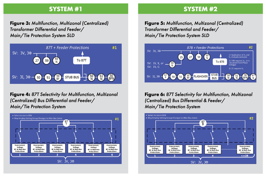

An economic protection method is to employ partially centralized systems with the collector and pooling buses. Partially centralized systems combine an element suited for a given zone or zones of protection, plus multizonality, which protects different zones with the same protection system.
For our study, we assume two protection systems are used for application in partially centralized distribution protection schemes:
  • System #1. A transformer protection system that can cover <=6 nodes, using a definable and selectable transformer differential zone, with all nodes employing overcurrent, voltage, and frequency elements.
  • System #2. A combination bus/feeder, main, tie CB protection system that can cover <=28 nodes of primary bus differential protection with phase and neutral/ground overcurrent, overvoltage, neutral overvoltage and breaker failure protections for each node. The differential protection can be divided into <=3 zones.
Single-line drawings (SLD) of the two systems are shown in Figures 3, 4, 5, and 6.

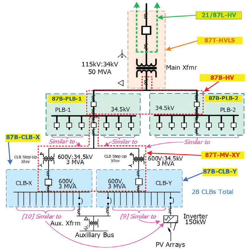

Figure 2: Utility-Scale Solar Plant
Figure 2 describes the infrastructure and protection application:
  • For CLB main CBs and the cabling to the main Xfmr low-side CTs, one System #2 will cover two CLB main CBs and cabling to the main step-up Xfmr low-side winding.
  • For the main Xfmr, two System #1s will provide redundant coverage.
  • For the HV utility POI, two-line protection systems will provide coverage.
  • Six modular units (MUs) will be used to provide redundant HV POI line protection, redundant main Xfmr protection, and non-redundant PLB to main Xfmr low-side bus protection.
Figures 3, 4, 5, and 6: Bus Differential and Feeder/Main/Tie Protection System

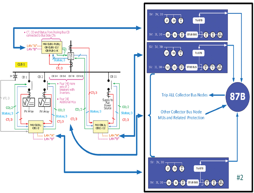

MU Connectivity and Protection: CLB
Figure 7 describes the  infrastructure and protection application for CLBs; System #2 will cover two CLBs.
Figure 7: MU Connectivity and Protection: CLB
  • Seven groups of two CLBs per PLB input; two CLBs are connected to each PLB.
  • Each CLB has 10 inverters, one auxiliary source, and one main as nodes (12 nodes total).
  • Overcurrent, voltage, and breaker failure protection are provided for all nodes.
  • Each CLB is a 12-node 87B zone, 87CLB-X, and 87CLB-Y.
  • Total nodes used by CP#2 = 12+12 = 24 (<=28).
  • Non-redundant protection for the set of two CLBs will require one Protection System #2.
  • Non-redundant protection for the set of two collector buses application will require 14 MUs.
  • For nodes on the CLB, System #2 provides bus differential protection. For a bus differential trip, all CBs connecting the CLB are tripped.
  • A breaker failure (BF) of the main CB will be cleared by an upline PLB input CB.
Note: All MU-relay signals are transmitted through a networked connection. Connections shown here show relationships only.

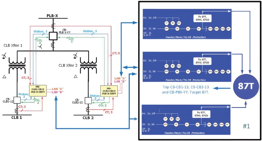

MU Connectivity and Protection: CLB to PLB, CLB 87B
System #1 provides overcurrent, voltage, and BF protections for the two CLB main CBs and the PLB input CB (Figure 8). The respective CB is tripped for any protection trip. In the case of BF, all CBs connecting the CLB are tripped.
Figure 8: Protective Relay—MU Relationships: CLB to PLB, CLB 87T
System #1 provides transformer and cable differential protection for the zone between the two CLB CBs and the PLB input CB. For a transformer or cable differential trip, two CLB CBs and a PLB input CB tripped. A BF of a PLB input CB will clear the respective PLB.

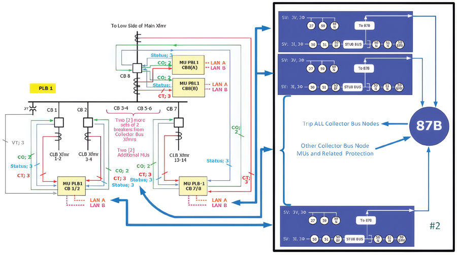

MU Connectivity and Protection: PLB
System #2 provides overcurrent, voltage, and BF protections for the PLB input and main CBs (Figure 9). The respective CB is tripped for any protection trip. In the case of BF, all CBs connecting the PLB are tripped.
Figure 9: Protective Relay—MU Relationship: PLB
System #2 provides bus differential protection for nodes on the CLB. For a bus differential trip, all CBs connecting the CLB and PLB tripped. A BF of a PLB main CB will trip CB M.
Description of infrastructure and protection application:
  • System #2 will cover two CLBs.
  • Yard-to-MU connectivity for PLB 1; PLB 2 is similar.
  • Total nodes used by CP#2 = 8+8 = 16 (<=28).
  • Non-redundant protection for the set of two collector bus applications will require eight MUs.
  • Redundant MUs on the PLB Main CB bus side are part of the main Xfmr 87T (HV, NERC).

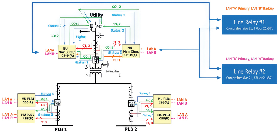

MU Connectivity and Protection: Utility POI
The utility POI dual-line protection systems are employed for the CB-M (Figure 11). Exact element fleet and principle used are dependent on the bulk system owner. CB-M is tripped for any line protection that trips in either redundant protection system. A BF of CB-M will transfer the trip to the up-line transmission system CBs.
Figure 11: Protective Relay—MU Relationships: Utility POI
