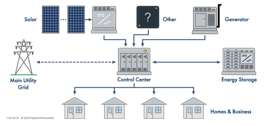

To elaborate on the DER’s condition, as third-party consultants or engineers-of-record, we predominantly work with the latest inverter-based resources, such as solar photovoltaics, lithium-ion battery energy storage, and generators (Figure 1).
Figure 1: Various DERs Relied On by Microgrids
Yet, with an eye for any energy future that includes a diverse abundance of renewable energy solutions, any good microgrid definition should consider proven technologies such as fuel cells, modular nuclear reactors, turbine-based assets, and any number of non-lithium storage technologies, including compressed air, redox flow-battery, thermal systems, pumped hydro, flywheels, and others. Notice that a simpler system consisting of loads, a generator, and proper controls for islanding capabilities could meet this four-part definition of a microgrid. This working definition is intentionally open-ended to accommodate all possible DER combinations.

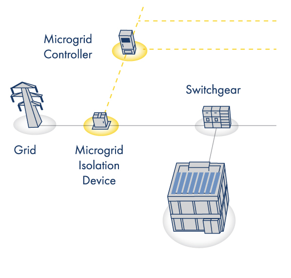

Figure 2: The ability to island from the grid while continuing to serve on-site electrical loads is important.
In most cases, the transition from grid-interactive to islanded and back again to grid-interactive is a key feature of microgrid design (Figure 2). However, this transition can present significant design challenges and considerations. Questions may include:

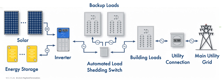

In a partial-facility backup design, the loads the facility cannot do without during an outage can be aggregated separately from loads that the facility operator might afford to leave unpowered.
In Figure 4, backup loads are aggregated in two backup load panels that can be isolated from the grid with the inverter bypass switch. During an outage, only the backup loads will receive power from the PV and BESS.
Figure 4: Example Block Diagram

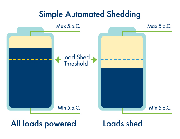

Taking load management one step further in complexity, what if I want to provide full-facility backup for as long as possible but also have the flexibility to remove some loads to extend the resilience period if needed? There could be any number of reasons to reduce load to the most important ones. When the time is right, a microgrid controller, contactors and relays, and subsystem controllers can be programmed and coordinated to shed predetermined sheddable loads in order to keep the most important loads powered. Consider load shedding based on battery state-of-charge (SOC) as one example, shown in Figure 5.
Figure 5: Simple Automated Shedding
Within the usable energy capacity of a BESS, an SOC threshold can be designated to initiate load shedding. Here, the microgrid will transition from full-facility backup to partial-facility backup when SOC falls below a programmed threshold.

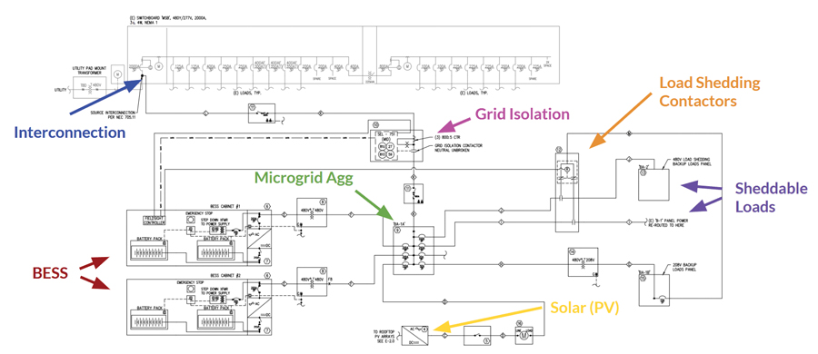

Here’s what programmable load shedding can look like in a single-line diagram (Figure 6). In this case, our microgrid includes solar PV (generation), BESS (storage), a grid isolation device (islanding), and two groups of loads (primary backup and sheddable loads).
Figure 6: Single-Line Diagram Showing Programmable Load Shedding
This microgrid system has two backup behaviors: full-facility and partial backup. During full-facility backup, non-sheddable loads (see Microgrid Agg panel in Figure 6), as well as the sheddable loads to the right side of the diagram, receive power. When the load-shedding threshold of the BESS SOC is reached, the load-shedding contactors, in communication with the controller integrated into the BESS, will transition from serving all loads to serving only the key loads located in the Microgrid Agg panel.
