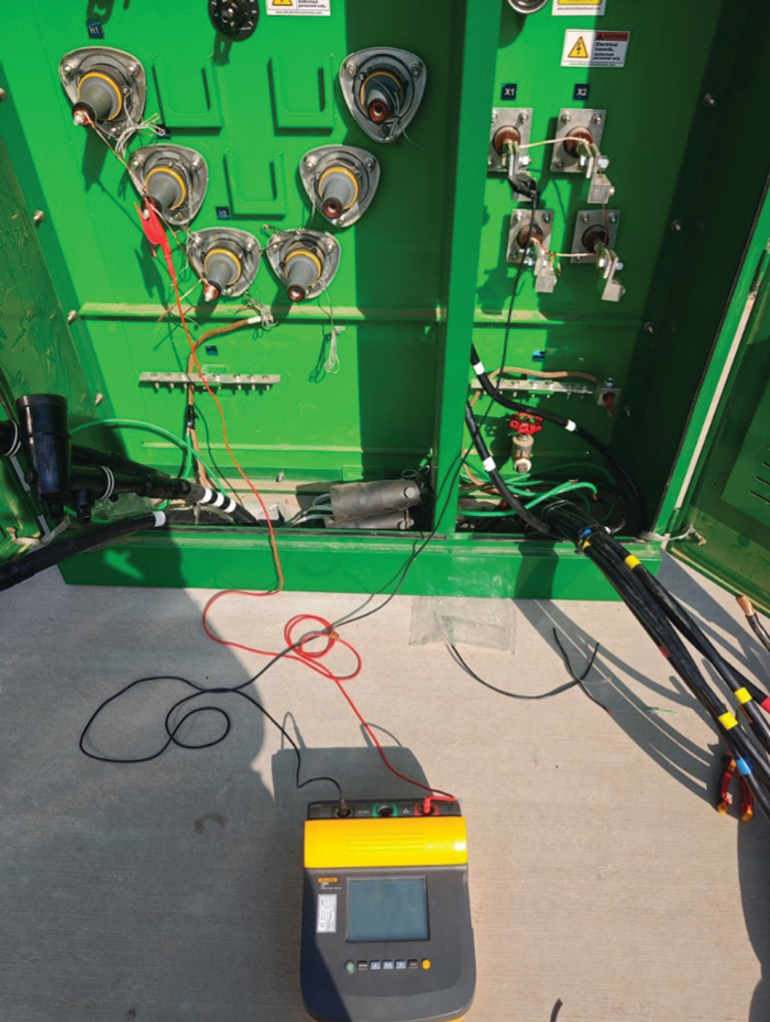

INSULATION RESISTANCE: THE FIRST VIEW OF INSULATION HEALTH
The insulation resistance test (Figure 1) is usually one of the first electrical tests performed on a transformer. It gives an initial indication of the condition of the insulation system between windings and between windings and ground. The test is simple in concept: A DC voltage is applied, and the resistance of the insulation is measured. However, interpretation requires care. The measured value is affected by temperature, humidity, surface contamination, moisture, test voltage, and the condition of the insulation. A low reading may indicate moisture, dirt, insulation deterioration, or leakage paths. It may also be influenced by poor test preparation, dirty terminals, or wet environmental conditions. This is why insulation resistance should be seen as a screening test, not a complete diagnosis by itself. A good insulation resistance value is encouraging, but it does not confirm that the winding geometry, turns ratio, tap changer, or core condition are correct.
Figure 1: Transformer Insulation Resistance (IR) Testing Connections

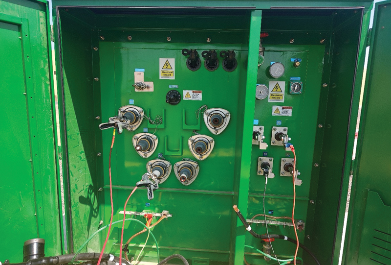

WINDING RESISTANCE: SMALL VALUES WITH BIG DIAGNOSTIC MEANING
Winding resistance testing (Figure 2) measures the DC resistance of transformer windings. The measured values are usually small, but they carry important diagnostic information. This test can help detect loose connections, high-resistance joints, poor bolted connections, defective tap changer contacts, open circuits, and phase imbalance.
Figure 2: Transformer Winding Resistance (WR) Testing Connections
One of the most important parts of this test is comparing phases and tap positions. A single resistance value has limited meaning unless it is compared with the corresponding phases, previous results, factory results, or expected design values.
If one phase shows a noticeably higher resistance than the others, the issue might be related to a loose connection or tap changer contact. If one phase shows a much lower resistance, it could indicate a possible shorted turn or incorrect connection. If the values are unstable during the test, this might suggest poor contact, incomplete core saturation, or an issue in the test connection.
Winding resistance testing also reminds us that field technique matters. Current should be applied carefully, readings should be allowed to stabilize, and the winding should be safely discharged after testing because of the stored magnetic energy in the transformer core.

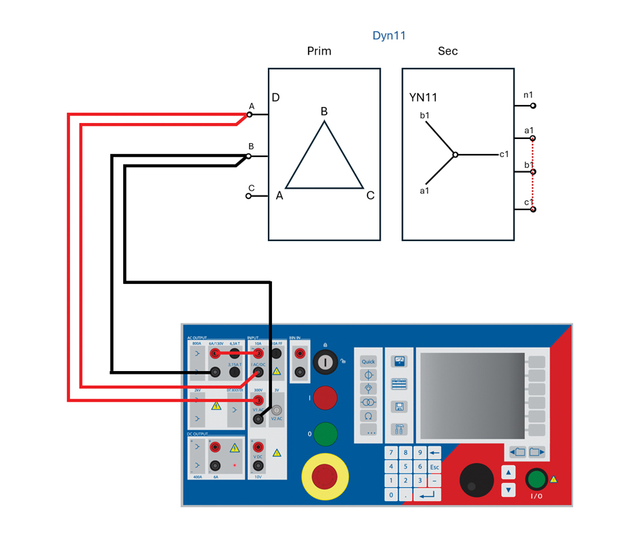

TURNS RATIO TEST: CONFIRMING THE ELECTRICAL RELATIONSHIP
The turns ratio test (Figure 3) verifies that the relationship between the primary and secondary windings matches the transformer nameplate and tap position. This test is critical because an incorrect ratio can lead to incorrect output voltage, circulating currents in parallel operation, protection issues, and system performance problems.
Figure 3: Transformer Turns Ratio (TTR) Testing Connections
However, turns ratio testing is not just about comparing a single number with the nameplate ratio. The tester must understand the transformer vector group, winding connection, tap position, and whether the calculation should be based on phase ratio or line-to-line ratio.
A common field issue is obtaining an abnormal ratio because the test connections are wrong or because the selected vector group in the test equipment does not match the transformer. In this case, the transformer itself may not be defective; the problem may be in the test setup. This is why a TTR test should always be interpreted with connection verification.
A correct TTR result supports the conclusion that the number of turns and the voltage transformation relationship are correct. But it does not prove that the contacts are healthy, that the insulation is dry, or that the core is free of problems.
