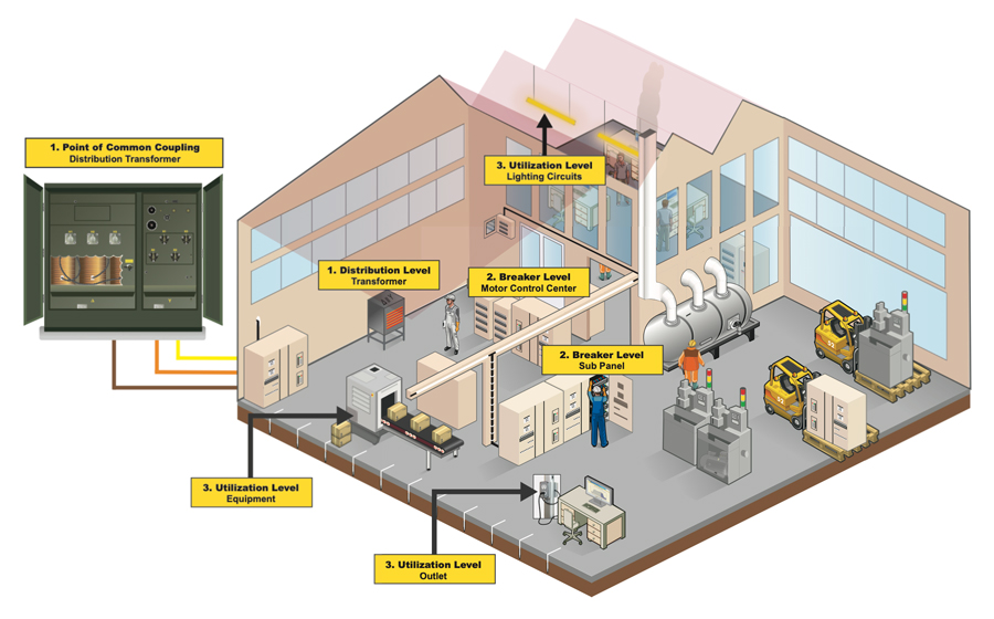

A IS FOR ANATOMY: THE ELECTRICAL SYSTEM AND WHERE TO MONITOR
If you frequent this publication, we do not need to explain the basic anatomy of an electrical system. What is worth examining is where the instrument should be placed within the system, because it is one of the most common misunderstandings about working with PQAs in complex systems. The right answer depends on the question being asked, and the wrong choice of location will limit even the most sophisticated analyzer to missed events or misleading data.
Figure 1 shows the three monitoring levels in a typical facility, from the utility-side distribution transformer down to the outlets, lighting, and equipment that ultimately consume the power.
Figure 1: Monitoring Levels
Point of Common Coupling
The point of common coupling (PCC), sometimes called the service level, is the derived source of power for the facility, typically the secondary of a distribution transformer. Studies at this level capture the entirety of the local electrical network, making it valuable for understanding overall system performance and the facility’s interaction with the utility. It is less effective for locating specific internal sources because the contributions of individual loads have already aggregated by the time current and voltage reach the PCC. The PCC is also where the utility’s power quality requirements formally apply. Service agreements and tariffs commonly hold the customer to harmonic distortion, flicker, and power factor limits measured at this point, and any question of responsibility for a disturbance is ultimately settled with data recorded here.
Most preset configurations in PQAs are designed against PCC-level references, especially the harmonic compliance limits in IEEE Std. 519, Standard for Harmonic Control in Electric Power Systems. The resulting data has value for documenting overall system behavior and for any conversation with the utility, but it is not the optimal starting place when the goal is to locate an internal load behaving badly.
Breaker Level
A study at the breaker level, such as a sub-panel or a motor control center, is better suited to locating circuit-level issues than studying at the PCC. Monitoring here focuses primarily on voltage stability across the branch circuits the panel serves and can reveal patterns spanning multiple loads that would be invisible at any single piece of equipment.
Consider a retrofitted LED lighting system. Before the upgrade, fluorescent tubes failed on a typical maintenance cycle, but new LED fixtures are failing much sooner than their expected end of life. A study at the panel feeding the lighting circuit may reveal overvoltage issues causing LED driver failure, the kind of marginal voltage variations older fluorescent tubes were largely immune to.
Utilization Level
Utilization-level studies have the most diagnostic impact when only a single load is exhibiting problems. Consider a recently upgraded high-speed printer that begins to misoperate shortly after installation (Figure 2). This is exactly the kind of problem a utilization-level study is designed to resolve. Despite being the easiest of the three monitoring tiers to deploy, utilization-level studies are also among the most consistently underused. Monitoring directly at the equipment terminals establishes the actual electrical environment experienced by the load, including voltage variations that may remain well inside published standards yet still exceed the susceptibility of the connected equipment.
Figure 2: Single-Phase Outlet Power Quality Analysis
Cascading Studies
One PQA is useful in identifying issues at one level. Several PQAs, deployed simultaneously at different tiers and synchronized in time, tell an entire power disturbance story. Class A instruments include accurate time synchronization, which makes it possible to capture events at multiple monitoring points and analyze them after the fact against a common timeline. Comparing what a single disturbance looked like at the PCC, at a sub-panel, and at the affected load is one of the few ways to determine with confidence whether a problem is being delivered from upstream or generated by something inside the facility. IEEE Std. 1159–2019 formalizes this same monitoring approach by relating the problem scope to the monitoring location, as summarized in Figure 3.
Figure 3: Suggested Monitoring Locations by Problem Scope, Adapted from IEEE Std. 1159-2019, Table 3.

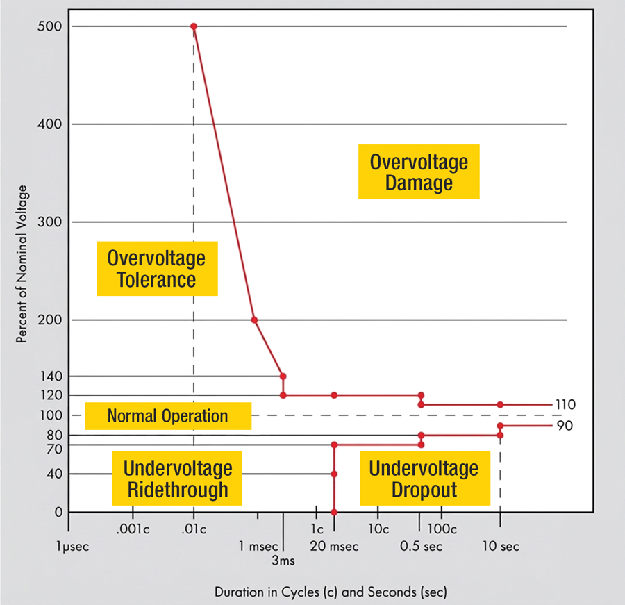

Benchmarking Versus Standards
Most PQAs ship with templates configured against standards such as ANSI C84.1, IEEE Std. 519, or EN 50160. These standards are useful starting points for general power quality assessment, but they are not the right benchmark when the question is whether a specific sensitive load is being treated badly. For that question, load susceptibility—meaning the actual tolerance of the connected equipment—is the critical benchmark. The Information Technology Industry Council (ITIC) curve, shown in Figure 5, is one widely used susceptibility reference for IT-class equipment. It defines a voltage-versus-time envelope inside which IT-class equipment is expected to ride through without dropout or damage. Equipment manufacturer specifications can be tighter still, and a sensitive load may operate within a window narrower than ITIC predicts.
Figure 5: ITIC Curve

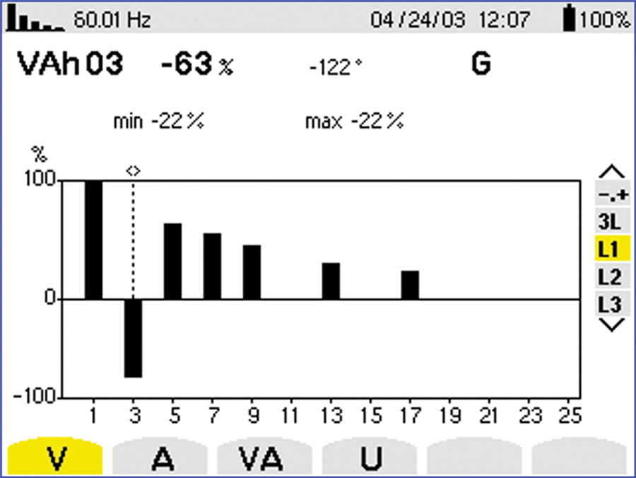

Harmonic Monitoring

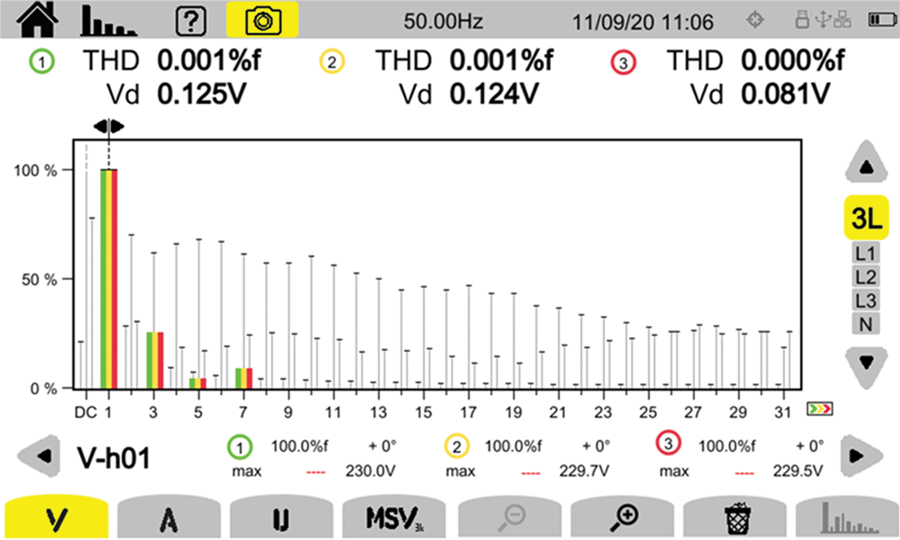

Harmonic content (Figure 6) is one of the parameters most likely to produce confusion when analyzer thresholds are configured without considering where the instrument is installed. Preset templates and default analyzer configurations often work well for general voltage monitoring, but harmonic thresholds may not behave the way the user expects.
Figure 6: Harmonic Content
At the utilization level—close to a nonlinear load such as a VFD, switch-mode power supply, rectifier, or LED driver—current THD of 20% to 40% may be completely routine depending on the topology and measurement location. At the PCC, however, IEEE Std. 519-2022 recommends limiting voltage THD to 8% for systems at or below 1 kV, with individual harmonics limited to 5.0%. Both conditions can be correct because they describe different measurement locations within the system.
Harmonic currents generated by nonlinear loads dilute and partially cancel as they aggregate upstream and mix with other loads. As a result, thresholds appropriate at the PCC can produce nuisance alarms when applied at the utilization level. Benchmark studies and equipment specifications provide a more realistic basis for configuring harmonic alarm thresholds near sensitive or nonlinear loads.
Harmonic flow analysis (Figure 7) can further help identify the source of a problematic harmonic. Modern analyzers capable of synchronous voltage and current sampling can calculate harmonic power flow by harmonic order. Positive harmonic power flow indicates the downstream load is injecting the harmonic, while negative flow indicates the harmonic is arriving from upstream. This technique is particularly useful when determining whether harmonic distortion originates inside the facility or from an external source.
Figure 7: Harmonic directional analysis shows the 3rd harmonic upstream from the instrument.

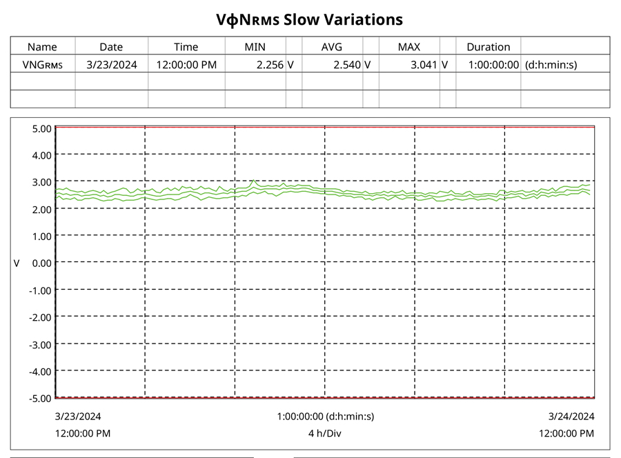

Neutral-to-Ground Voltage as a Threshold
The voltage between neutral and ground should sit near zero on a properly bonded system. Figure 8 shows a sustained neutral-to-ground voltage of approximately 2.5 to 3 V over a 24-hour period. While the system may appear electrically stable from a conventional voltage perspective, elevated neutral-to-ground voltage can indicate an unstable local reference environment for sensitive electronic or communication equipment. Conditions like these are commonly associated with harmonic-rich neutral currents, shared neutrals, or bonding issues and may create problems even when line voltage remains within published standards. IEEE Std. 1100 suggests keeping neutral-to-ground voltage below 1 V at receptacles serving sensitive loads, with tighter thresholds (under 100 mV) for some medical and information-technology installations.

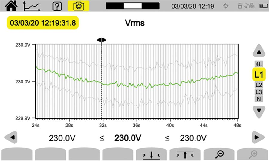

Trend mode–type studies (Figure 9) record continuously over a user-defined aggregation interval and are most useful for benchmark studies or long-term operating contexts. Because it records every aggregated value over time, analysis often involves hunting and pecking through large datasets, which makes trend mode better suited to baseline characterization than to event-focused troubleshooting.

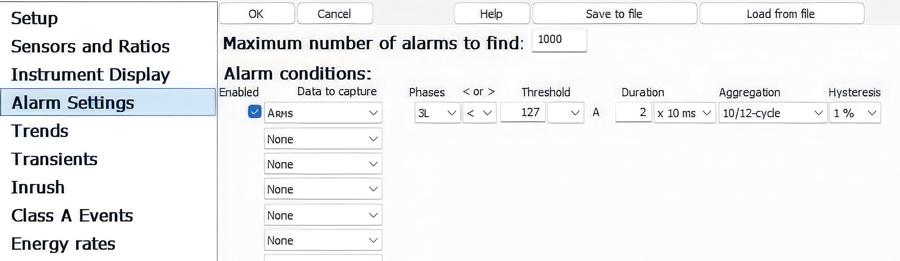

Alarm mode (Figure 10) builds on the same trend-recording structure but captures only events that exceed configured thresholds. Instead of producing a continuous operating record, alarm mode generates a smaller, more focused dataset centered on the events of interest.

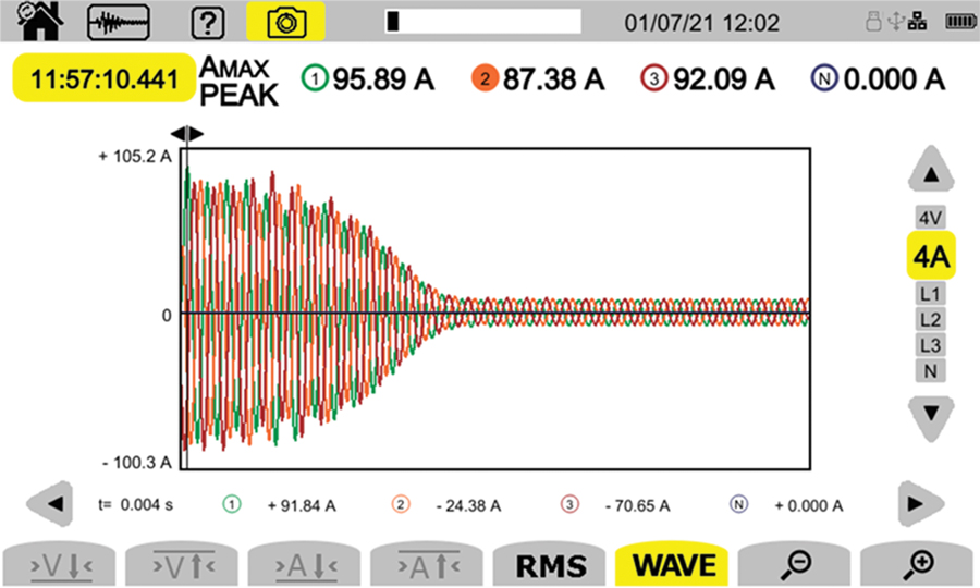

Transient and inrush modes (Figure 11) are specialized waveform-capture variants of alarm mode. Both trigger from configurable thresholds but record high-resolution waveforms rather than aggregated RMS values. Transient mode is intended for fast events such as switching surges, while inrush mode captures motor or transformer energization.

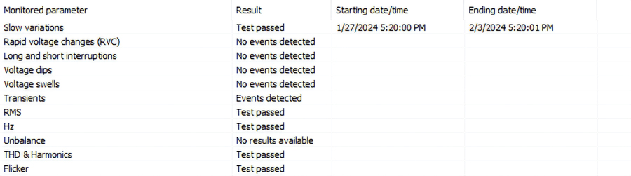

In practice, most PQAs include pre-configured monitoring studies (Figure 12) that combine trend-mode continuous recording with alarm- and transient-modes operating in parallel to trigger specific events. The trend record provides continuous context, while the alarm, transient, and inrush triggers capture the specific moments that matter at higher resolution. Typically, these monitoring studies are run at the PCC for voltage quality standards, utilizing various standards, but can be adjusted to monitor power quality at breaker and utilization levels.

The captured data at these intervals can be meaningfully compared with the multi-cycle portion of susceptibility references, such as the ITIC curve, manufacturer specifications, or other narrow-window equipment tolerances. A 10-minute aggregation will smooth out a 200-ms voltage sag from the data. A 12-cycle aggregation will register that same sag as a measurable RMS deviation.
