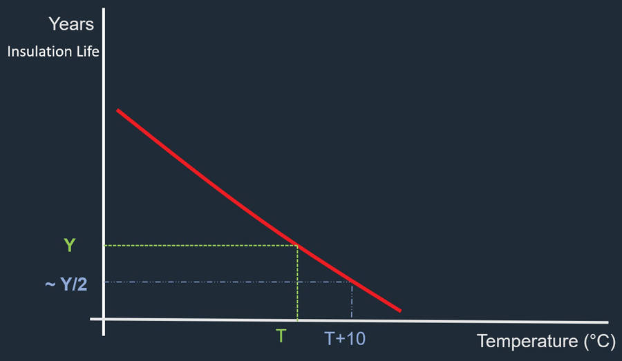

Thermal stress is typically associated with overloading and cooling-system deficiencies. In renewable-energy transformers, however, thermal aging is often driven by frequent load fluctuations, inrush currents, harmonics, and cyclic loading associated with solar and wind generation. These conditions can accelerate insulation aging, promote oil degradation, and increase dissolved gas generation, ultimately reducing transformer life expectancy.
Figure 1 shows that a 10°C increase in the operating temperature of a transformer can reduce its insulation lifespan by approximately half [1].
Figure 1: Aging by Moisture and Heat [1]

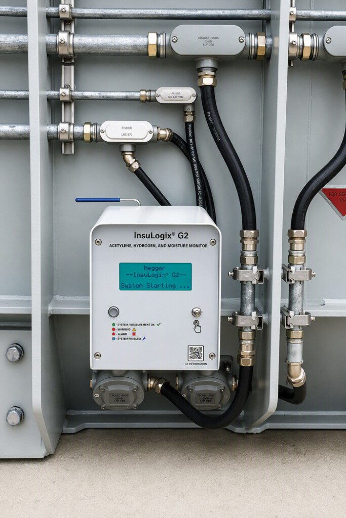

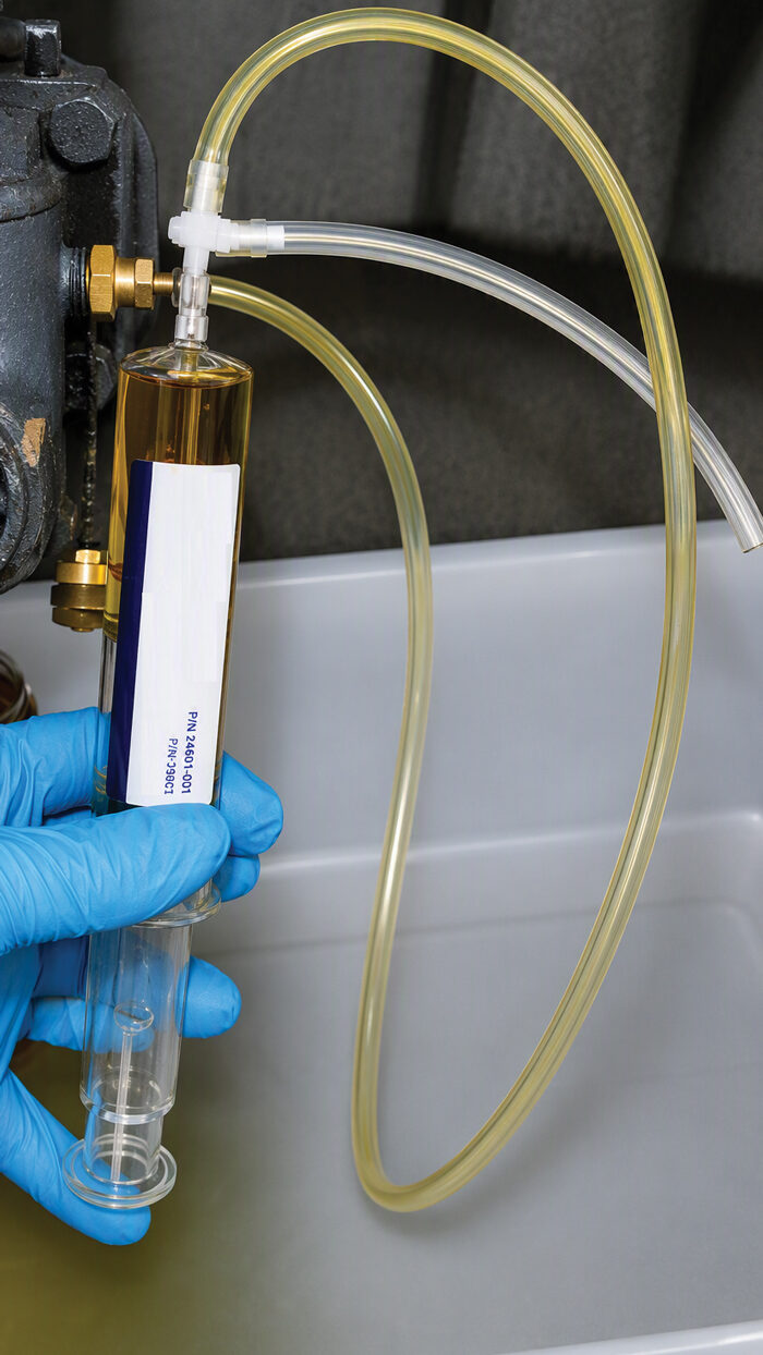

DGA MONITORING VERSUS OIL SAMPLING
Oil sampling can be compared to a blood test for the human body. Transformer oil carries evidence of insulation aging, overheating, electrical faults, and contamination, making it an excellent indicator of transformer health.
Oil sampling is typically performed every 6 to 12 months, depending on asset criticality and condition, providing periodic snapshots of transformer health. However, these snapshots may miss rapidly developing events in renewable-energy transformers. In contrast, online DGA monitoring provides continuous trending, enabling earlier detection of changes and developing faults.
Figure 3a: Installed DGA Monitor vs Manual Oil Sampling
Figure 3b: Installed DGA Monitor vs Manual Oil Sampling

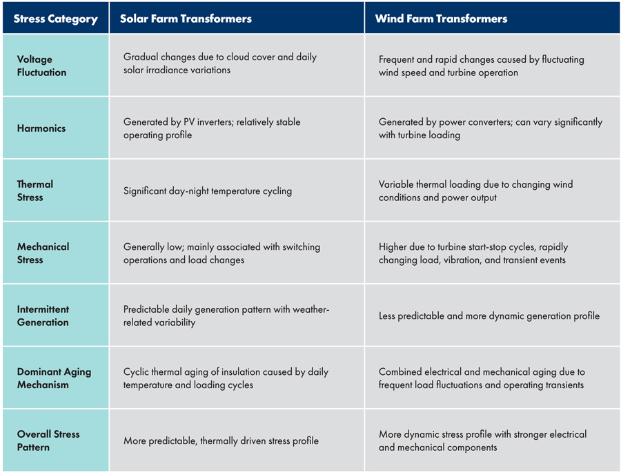

Renewable-energy transformers are typically subjected to elevated thermal, electrical, and mechanical stresses due to the variable and intermittent nature of solar and wind power generation. While transformers in both solar and wind farms experience these stress mechanisms, their magnitude and dominant characteristics differ between the two applications. Consequently, the resulting aging processes and failure modes may vary.
Table 1 summarizes the key differences in transformer stress profiles in solar and wind farm environments. Conventional oil sampling and dissolved gas analysis (DGA) are valuable for transformer diagnostics, but in renewable-energy applications, dynamic loading can elevate baseline gas levels. This may limit the effectiveness of relying solely on absolute gas concentrations for early fault detection.
Table 1: Comparison of Transformer Stress Profiles in Solar and Wind Farms [3]

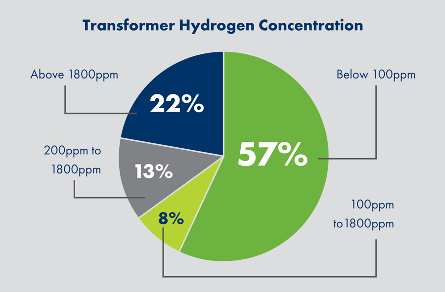

A large-scale study of transformer oil samples from wind power plants found hydrogen concentrations significantly higher than those typically observed in conventional transformer applications. Figure 4 illustrates the distribution of hydrogen concentrations observed in the sampled wind-farm transformer population.
Figure 4: Hydrogen Concentration of Transformers in Wind Power [3]

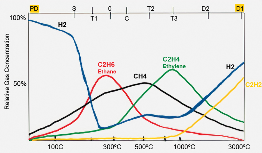

Most of the time, DGA interpretation relies on gas formation patterns, absolute gas concentrations, and gas ratios to identify fault types. However, the elevated and fluctuating gas levels commonly observed in renewable-energy transformers can limit the effectiveness of this approach, as seen in Figure 6.
Figure 6: Gas Formation Patterns as a Function of Temperature and PD [5]
