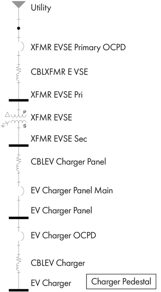

The common design constraint in all of these buildings was typically a 480-V power supply from existing panels. This overcurrent protective device (OCPD) was a thermally magnetic molded-case circuit breaker with no adjustable settings. This OCPD was sized appropriately to protect a dry-type transformer that had a NEMA 3R enclosure. All the transformers were 480-V to 208-V step-down transformers. The downstream of these transformers was connected to a 208-V three-phase panel with a main circuit breaker (MCB). Some of the MCBs had electronic trip units with long time, short time, and instantaneous (LSI) trip settings, and others were thermal magnetic MCBs with fixed instantaneous trip units. All feeder circuit breakers that provided 240-V power to the EV chargers were standard two-pole thermal magnetic MCBs with a fixed trip unit. All the chargers were no farther than approximately 50 feet from the panel. This design configuration is shown in Figure 1.
Figure 1: Single-Line Diagram for an EVSE and EV Charger

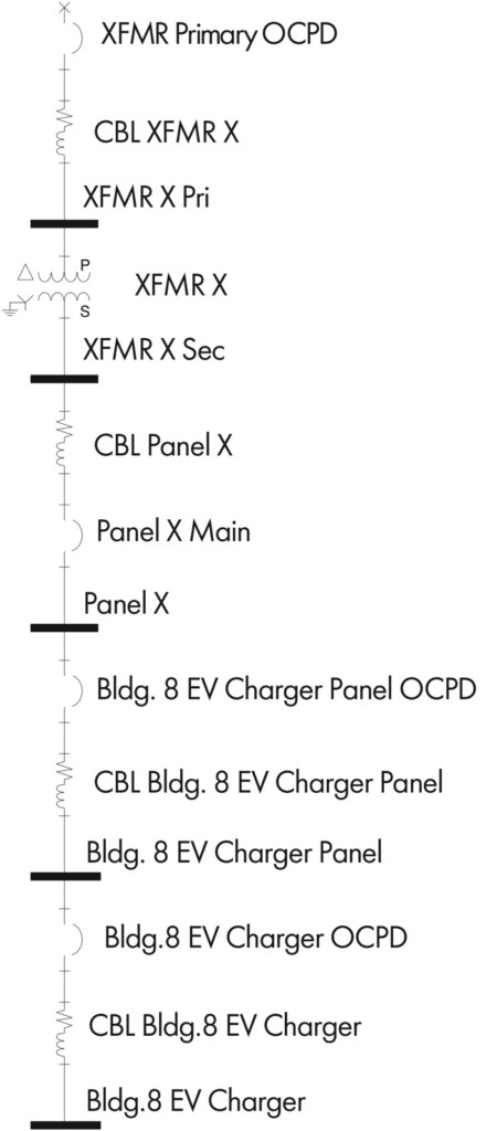

Most buildings have the power system shown previously in Figure 2 with the dedicated transformer for EVSE and then subsequent downstream equipment for EV charger. Building 8 and Building 9 have a different power system for EVSE as shown in Figure 3. These buildings have a separate EVSE distribution panel but share a common transformer, larger in size compared to the other buildings.
Figure 3: Single-Line Diagram for an EVSE & EV Charger for Buildings 8 and 9
