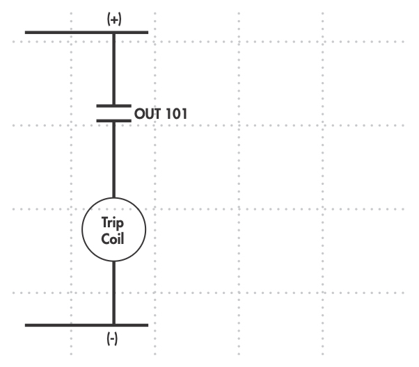

To illustrate, consider the DC schematic of a breaker trip circuit shown in Figure 1. The normally open OUT101 contact breaks the positive leg of the 125 VDC circuit of a trip coil. The circuit breaker’s trip coil is energized by pulsing the OUT101 contact, proving that the signal is passed to a downstream terminal point or device when the contact is closed.
Figure 1: DC Schematic of a Trip Unit
Pulsing the relay contact also verifies the relay contact’s ability to operate from an open to closed position and back again. Note that for simplicity, we have removed the auxiliary contacts that are usually present to provide supervision.

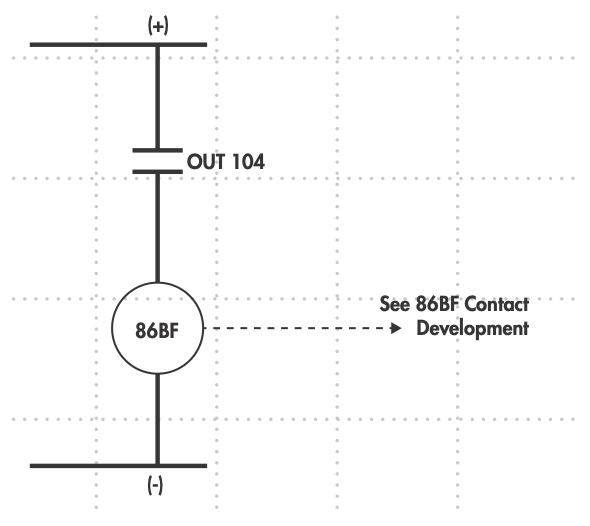

Functional testing is an intricate process that not only checks the relay’s output contact movement from closed to open and back again, but also verifies when the contact should operate. To elaborate, consider Figure 2.
Figure 2: DC Schematic of an LOR Circuit
We observe that the relay’s OUT104 contact is connected in series with the 86BF breaker failure lock-out relay (LOR). During function testing, we pulse the output to test the lockout relay’s operation or roll, followed by verifying the contact development to validate the circuits connected with the 86BF LOR.
While function testing involves pulsing the output to confirm the lock-out relay’s operation and validating the contact development to prove the circuits associated with the 86BF LOR, functional testing takes a more comprehensive approach.
In this method, we examine the circumstances that could cause OUT104 to operate, such as the trip condition that exists after 18 cycles, typical in programming breaker-failure logic. This approach allows the trip to be initiated, monitors the secondary current magnitude, and asserts a separate contact to operate a lockout relay that trips adjacent circuit breakers, blocks auto-reclosing, and sends necessary alarms to the station relay terminal unit (RTU). However, testing the operability of the OUT104 contact alone can lead to missing the conditions that must be fulfilled and dictated when OUT104 operates.
Even if the OUT104 contact is properly wired, the wiring diagrams are accurate, and the output is pulsed successfully during commissioning, there is still a chance of missing critical details. For instance, the OUT104 definition could be flawed or dependent on some other bit of logic that might have been inadvertently brought over from a previous project or an entirely different substation.

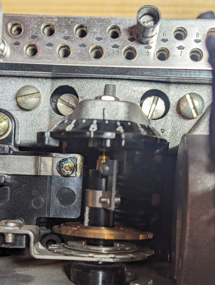

Moreover, when a trip or close coil saturates and operates, an arc develops across the contacts as it interrupts the circuit. This arcing causes pitting and degradation of the contact’s life (Photo). Therefore, minimizing the number of operations performed on a device, such as a circuit breaker, motor-operated disconnect, or lock-out relay, is crucial to reducing the chances of degradation.
Arcing results in pitted contacts and reduced contact life.
