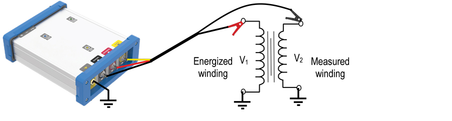

The basic setup of the SFRA ratio test employs connections for the inductive interwinding SFRA test (Figure 1). The high-voltage winding is excited by the test voltage (V1) applied between the red lead and ground, and the secondary voltage (V2) is measured between the black lead and ground.
Figure 1: Basic Setup for SFRA Ratio Test

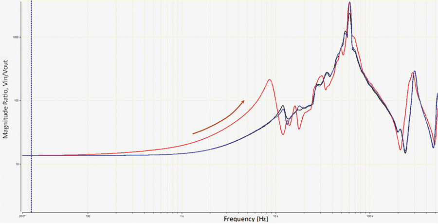

The spread between the SFRA traces of the various phases can be useful in detecting and confirming the presence and location of the defect (3):
(3)
In (3), are the SFRA ratio values obtained from the trace of each phase? To identify which winding has the shorted turn, the trace deviation in the segment below 200 Hz is examined.
The analysis is based on calculating the deviation for a set of three traces using Equation (3). Then, if the 0.5% limit (derived from field data) is violated, the trace that deviates the most from the other two is identified. The assumption is that the defect exists in only one phase.

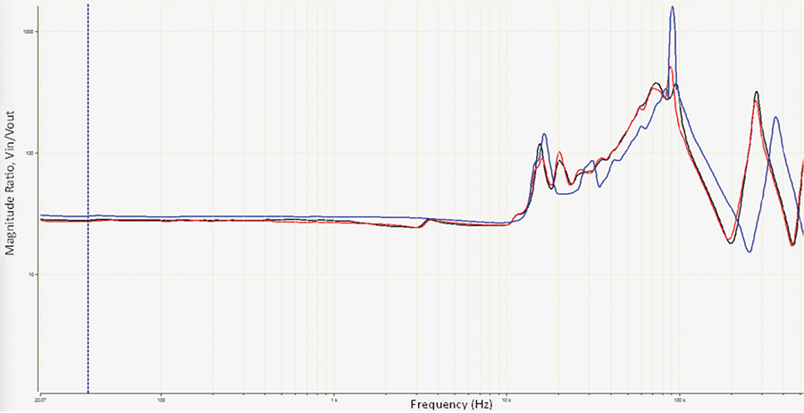

The trace segment will move upward (towards a higher ratio value) if a shorted turn is present in the low-voltage winding, as shown in Unit 2 and Unit 3. The deviation can increase with frequency, resulting in increased deviation at higher frequencies, as shown in Unit 2. This makes the defect more obvious.
The trace segment will move downward (towards a lower ratio value) if the shorted turn is present in the high-voltage winding, as shown in Unit 4.

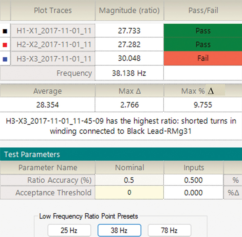

To assist the field tester, the rule mentioned above is implemented in the SFRA application that provides two features:
  1. Graphic results of magnitude (ratio) for direct ratio reading
  2. Ratio analysis of the selected three-phase traces to read the ratio, determine the ratio deviation, and identify the defective phase along with the winding sheltering the shorted turns, as shown in Table 2

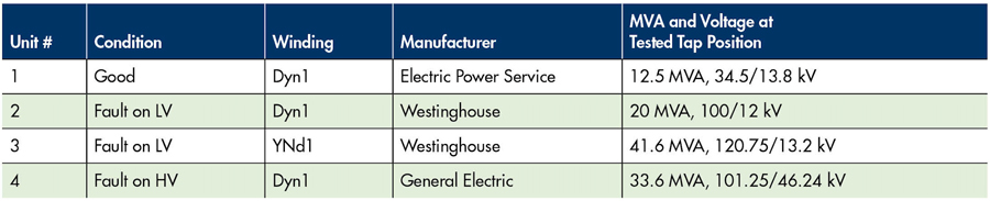

Four transformers were used to demonstrate the SFRA ratio application. The four units have different winding configurations with conditions ranging from good to conditions with a fault in the primary or secondary winding, as summarized in Table 1. The test results are summarized in Figure 2–Figure 5.
Table 1: Transformers Tested

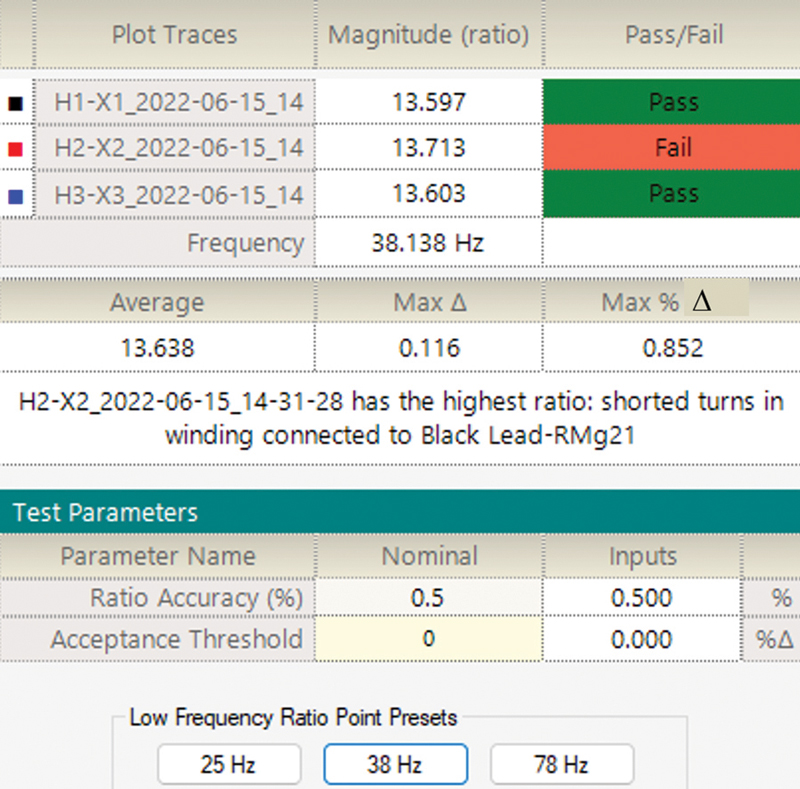

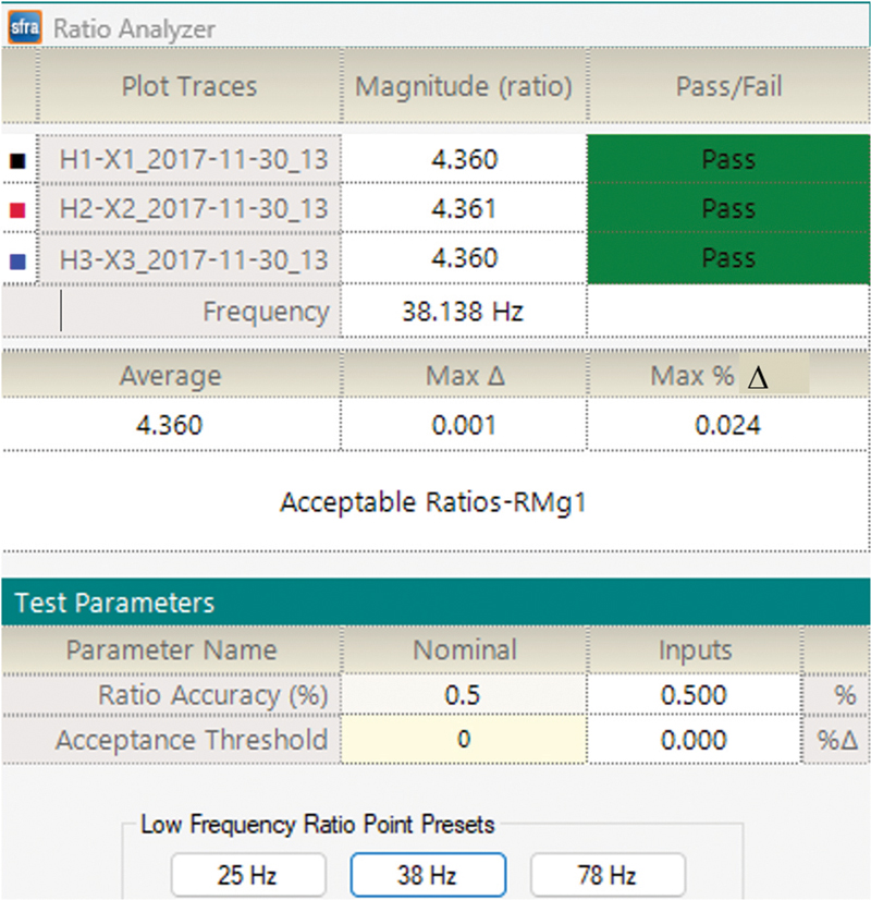

In each figure, the left column displays the graphical results of SFRA Ratio tests, with three selected traces coloured black, red, and blue for phases A, B, and C, respectively. The right column shows the ratio analysis of the three traces. The analysis performs four tasks:
  1. Measures the ratio values at the selected frequency by the cursor
  2. Calculates the maximum deviation among the three phase ratios
  3. Compares the deviation to the 0.5 % limit in the Inputs field
  4. Rates each phase ratio pass or fail and provides a diagnostic message. If it fails, the results will indicate which winding has the shorted turns in the fail phase.

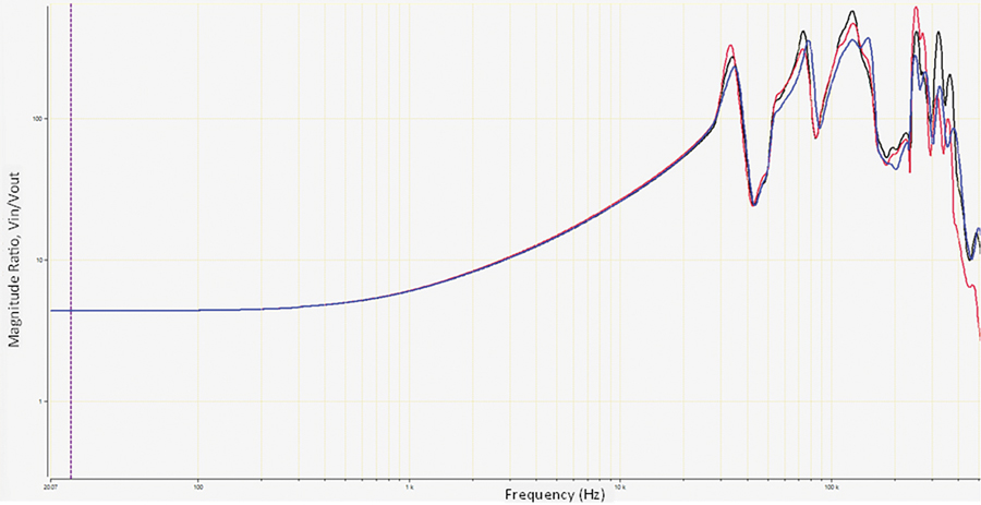

Figure 2a: Unit 1, Dyn1, NP Ratio = 4.33
Figure 2b: ∆38Hz = 0.024% No Fault Detected
Figure 3a: Unit 2, Dyn1, NP ratio = 13.54
Figure 3b: ∆38Hz = 0.852%. Fault Detected in X2 Winding
Figure 4a: Unit 3, YNd1, NP ratio = 13.54
Figure 4b: ∆38Hz = 10.56%. Fault Detected in X3 Winding

This case study shows that the SFRA ratio test was successful in both tested transformers. It detected the presence of the shorted turns and identified the winding that was sheltering them.
