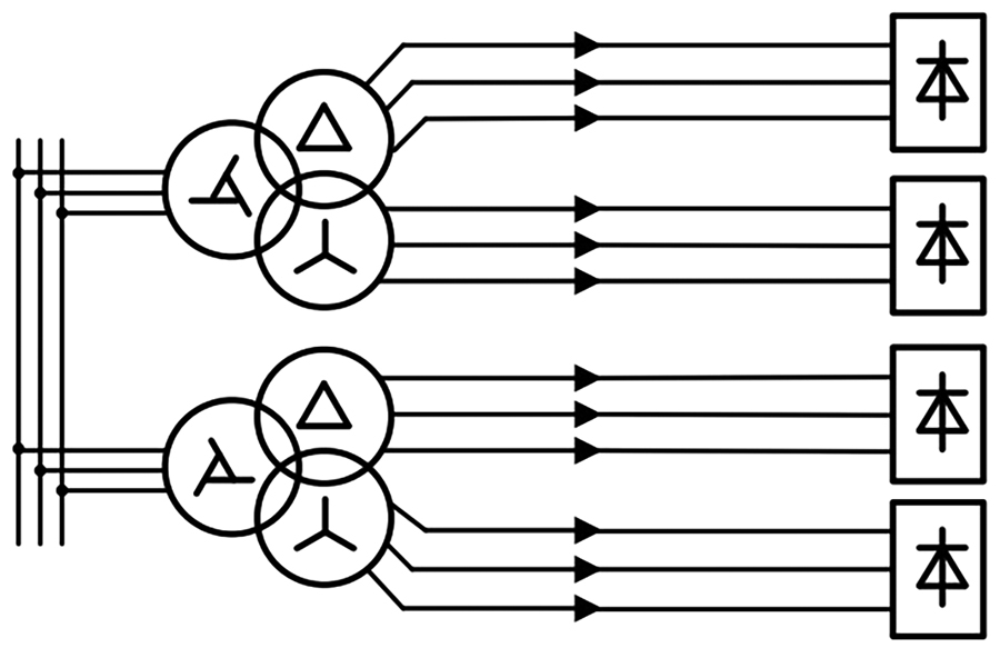

The configurations for a 24-pulse rectifier transformer, which includes the phase-shift transformers, have side-extended delta-connection primary windings and four secondary windings with conventional delta and Y connections, respectively. The unit used in this analysis incorporates automatic regulation with extended‑delta windings connected in parallel and phase‑shifted on the primary side, along with four secondary star–delta outputs.
A traditional 24-pulse rectifier transformer uses two 12-pulse, phase-shifting rectifier transformers to form a 24-pulse rectifier to eliminate most of the harmonics on the grid side, as shown in Figure 1. Nevertheless, the large footprint of two transformers affects the layout of other equipment in the system. Considering the limited physical size of available space in prefabricated substations, a new 24-pulse rectifier transformer can realize a special phase-shifting angle by using a delta-extended connection, which can improve efficiency and greatly reduce the size of the area.
Figure 1: Typical Topology of a 24-Pulse Rectifier System

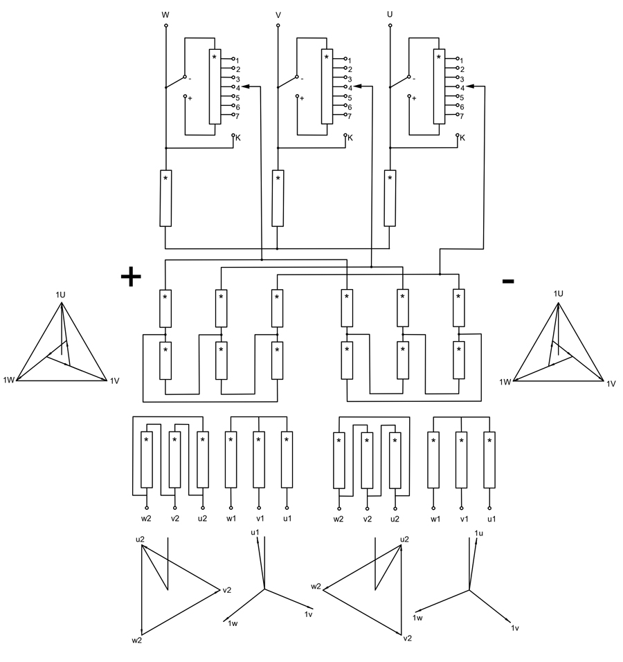

The configuration for the case under analysis is shown in Figure 2.
Voltage rating: 12.5 kV /526 V
Power rating: 6630 kVA
Frequency: 60 Hz.
Number of phases: 3
Type: ZHSZ-6630/12.5
Vector Group: Ya0 + DE/dy – DE/dy

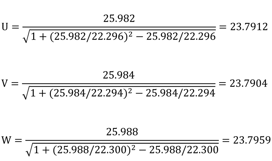

For each phase, two coefficients (Kb and Kc) are obtained. The effective voltage ratio is reconstructed using the IEC-defined analytical expression that compensates for phase displacement and magnetic coupling effects.
Field TTR tests were performed using a single-phase cyclic permutation method. The values Kb and Kc (the average of the three measurements) are used in the following equation for the effective voltage ratio:
where Kb and Kc are the averaged ratios obtained from cyclic permutation single-phase measurements.
This equation compensates for internal winding geometry and phase displacement inherent to rectifier transformers.

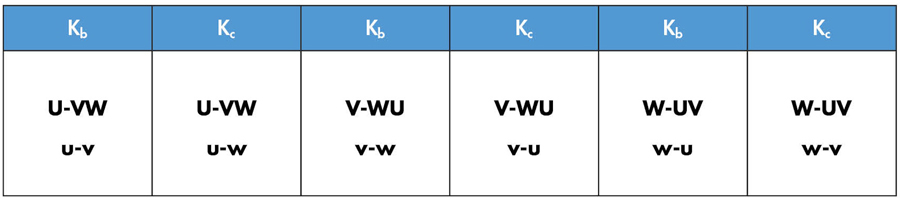

The turn ratio measurements should be performed in the single-phase configuration, feeding the HV phase (U, V, W) using a cyclic permutation with the other two phases short-circuited, against the respective LV phase (u, v, w) according to the following combinations (Table 1):
Table 1: Single-Phase Ratio Combinations

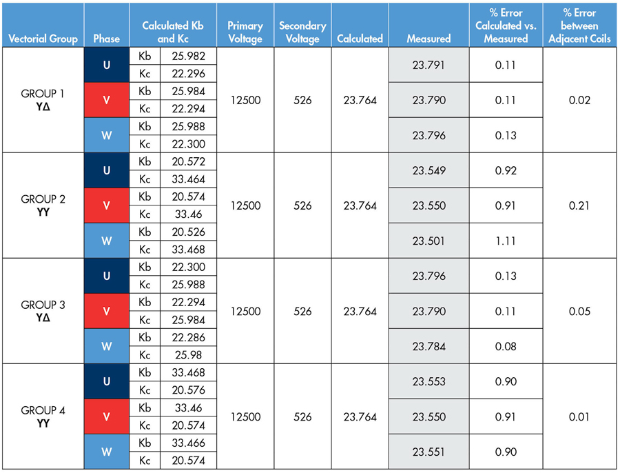

Measured ratios were reconstructed using the IEC analytical formula and compared against calculated nominal values. Phase-to-phase deviations remained within acceptable IEC limits, confirming winding symmetry and correct tap configuration.
Table 2: Field Single-Phase Ratio Measurements

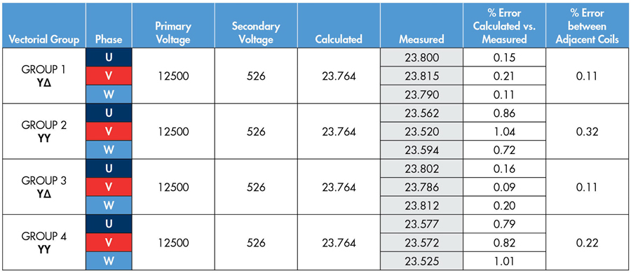

Table 3: Factory Acceptance Testing Phase Ratio Measurements

The comparison between field and factory TTR results demonstrates a strong correlation when the IEC 61378-1 single-phase cyclic permutation method is correctly applied. The results validate field TTR testing as a reliable commissioning and condition assessment tool for 24-pulse rectifier transformers.

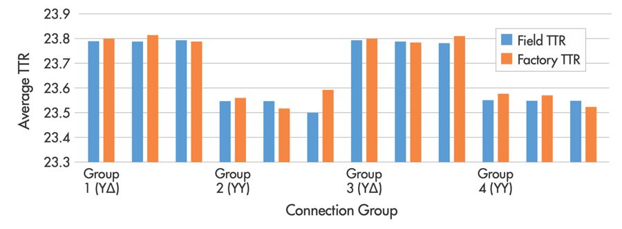

As shown in Figure 3, the average TTR values measured in the field closely match the corresponding factory acceptance test results across all connection groups, with deviations remaining well within acceptable limits. This comparison confirms the reliability and repeatability of the single-phase cyclic permutation method when applied during field testing.
Figure 3: Comparative Bar Chart of Field and Factory Average TTR by Connection Group
This chart compares average transformer turns ratio (TTR) values measured during field commissioning and factory acceptance testing for YΔ and YY connection groups at Tap Position #1.
