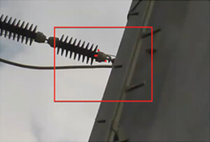

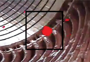

Solar-Blind UV Imaging
Position on the P–F curve: Very close to Point P
Solar-blind ultraviolet (SBUV) imaging detects electromagnetic emissions in the 240–280 nm wavelength range, where natural sunlight is filtered by the atmosphere. This enables the detection of faint ultraviolet photons generated by corona partial discharge, surface partial discharge, and arcing that are often early warning signs of potential faults (Figure 2). Such detections can take place even under daylight conditions.
SBUV cameras are designed as bi-spectral imaging devices, operating at two spectral bands: the solar-blind UV-C band and the visible light band. They produce output images by merging UV and visible light imagery, thereby presenting a comprehensive view of the observed scene.
Solar-blind UV technology can detect faults such as:
- Local electric field intensification caused by improper design or installation
- Early-stage insulation stress
- Contamination-driven discharge activity
- Microdefects on energized hardware, mechanical damage, breaks, cracks, broken strands, loose components, and more.
Because corona and surface PD are typically among the earliest measurable symptoms of electrical degradation, SBUV operates extremely close to Point P, often identifying defects long before heat, sound, or visual damage appears.

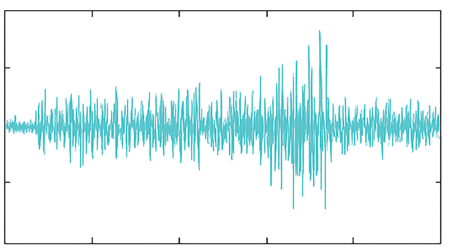

Acoustic and Ultrasonic Inspection
Position on the P–F curve: Mid-range between P and F
Acoustic and ultrasonic techniques (Figure 4) detect high-frequency sound emissions produced by:
- Partial discharge and arcing
- Mechanical looseness and vibrations
- Gas leaks
These methods are particularly effective in enclosed environments, such as switchgear. However, audible and ultrasonic emissions usually occur after electrical or chemical degradation has intensified, placing these tools further from Point P and closer to mid-to-late stages of the P–F interval.

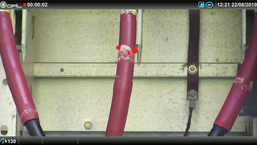

Infrared Thermography
Position on the P–F curve: Middle to late stages
Infrared (IR) thermography identifies temperature anomalies caused by:
- Resistive heating at poor electrical connections (Figure 5)
- Conductor overload
- Phase imbalance
- Insulation breakdown progressing to thermal loss
Thermal signatures generally appear after electrical stress and partial discharges have been active for some time. As a result, IR thermography is positioned further along the P–F curve, detecting faults typically in the late stages of degradation.

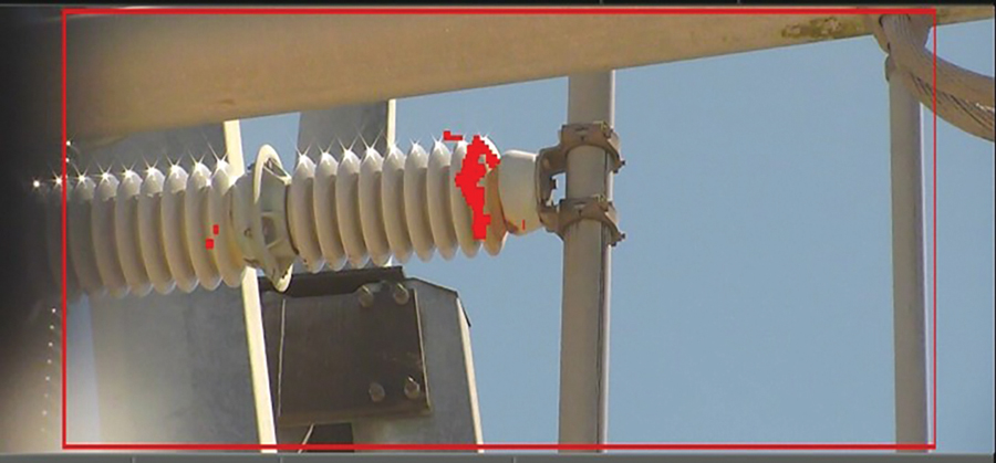

Visual and High-Resolution RGB Inspection
Position on the P–F curve: Close to Point F
Red-green-blue (RGB) Visual inspection detects:
- Cracks and fractures
- Burning and carbonization
- Corrosion and contamination buildup (Figure 6)
- Deformation and mechanical damage
These are typically late-stage symptoms, appearing only after significant damage has already occurred. As a result, visual inspection is positioned closest to Point F, where corrective actions tend to be reactive, urgent, and costly.

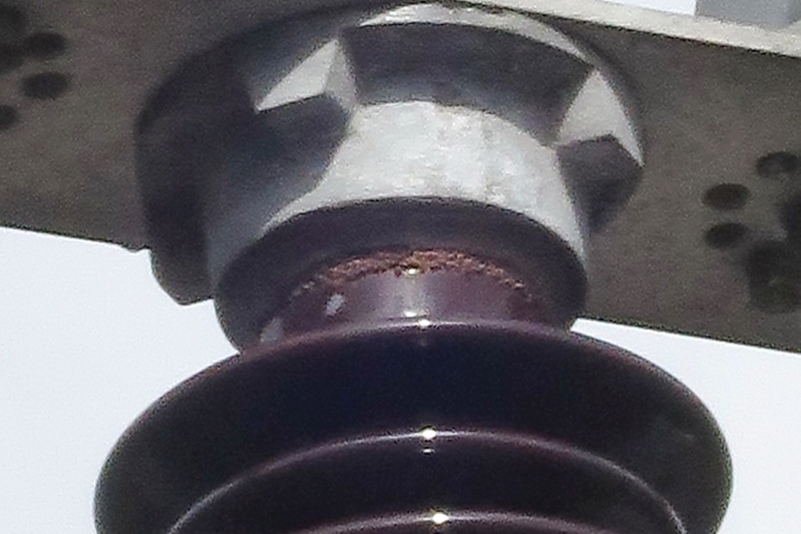

CASE 2: Extending Substation Insulator Lifespan in a Chemical Production Facility
During a scheduled condition assessment of a chemical production facility’s high-reliability substation, a solar-blind UV inspection was performed on critical insulation components operating under continuous load. The site required exceptionally high power quality and continuity due to the sensitivity of the production processes and the safety constraints of the operating environment.
Although no visible damage or thermal anomalies were detected, the UV inspection revealed persistent corona discharge activity concentrated around the metal cap of a critical insulator (Figure 8).
The discharge pattern was stable and repeatable, indicating a structural defect rather than a transient environmental effect. Detailed analysis suggested the presence of a micro-gap between the insulator cap and the insulating body. This gap was likely introduced during installation or developed over time due to mechanical stress, thermal cycling, and structural tension on the line. The gap created a localized electrical field intensification, producing continuous corona activity along the insulator surface. This condition initiated progressive material erosion at the edge of the insulating material.
Environmental exposure significantly accelerated the degradation process:
- Rainwater penetrated the micro-gap.
- Moisture reduced surface insulation resistance.
- Repeated wet–dry cycles increased surface tracking and erosion rates.
Although the insulator was still operational, the combination of continuous corona, moisture ingress, and surface degradation placed the asset on an accelerated path toward early end-of-life.
The Risk to Asset Lifespan
If left undetected, the defect would have resulted in:
- Rapid loss of dielectric strength
- Increased likelihood of flashover
- Structural weakening of the insulator body
Corrective Action and Life Extension Outcome
Based on the UV inspection results, the facility implemented a proactive replacement program before functional failure occurred:
- The affected insulator was replaced at a direct cost of approximately $1,800.
- Mechanical installation procedures were updated to eliminate tolerance gaps.
- A periodic UV inspection program was introduced to monitor similar components.
This proactive approach prevented the defect from progressing into irreversible damage and preserved the long-term integrity of the substation infrastructure.
