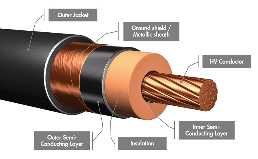

Evaluating the service life of medium-voltage cables begins with understanding their construction. Unlike low-voltage cables, which typically include only a conductor and insulation, medium-voltage cables incorporate several functional layers. These layers include the conductor, inner semiconducting layer, insulation, outer semiconducting layer, metallic shield, separator, and outer jacket (Figure 1).
Figure 1: Typical Structure of a Medium-Voltage Cable
Over the years, polymeric insulation has been subject to the formation of water trees as well as other dielectric aging mechanisms. The metallic shield may experience corrosion and discontinuities, which can compromise control of the electric field and its ability to conduct fault currents. When these two elements remain in good condition, it is common for the cable to continue operating well beyond the frequently cited typical service life of 25 to 30 years under nominal load.
Thus, the more important question is not, “How old is the cable?” but rather “What is the actual condition of the insulation and the shield?” Diagnostic testing exists precisely to answer this second question.
