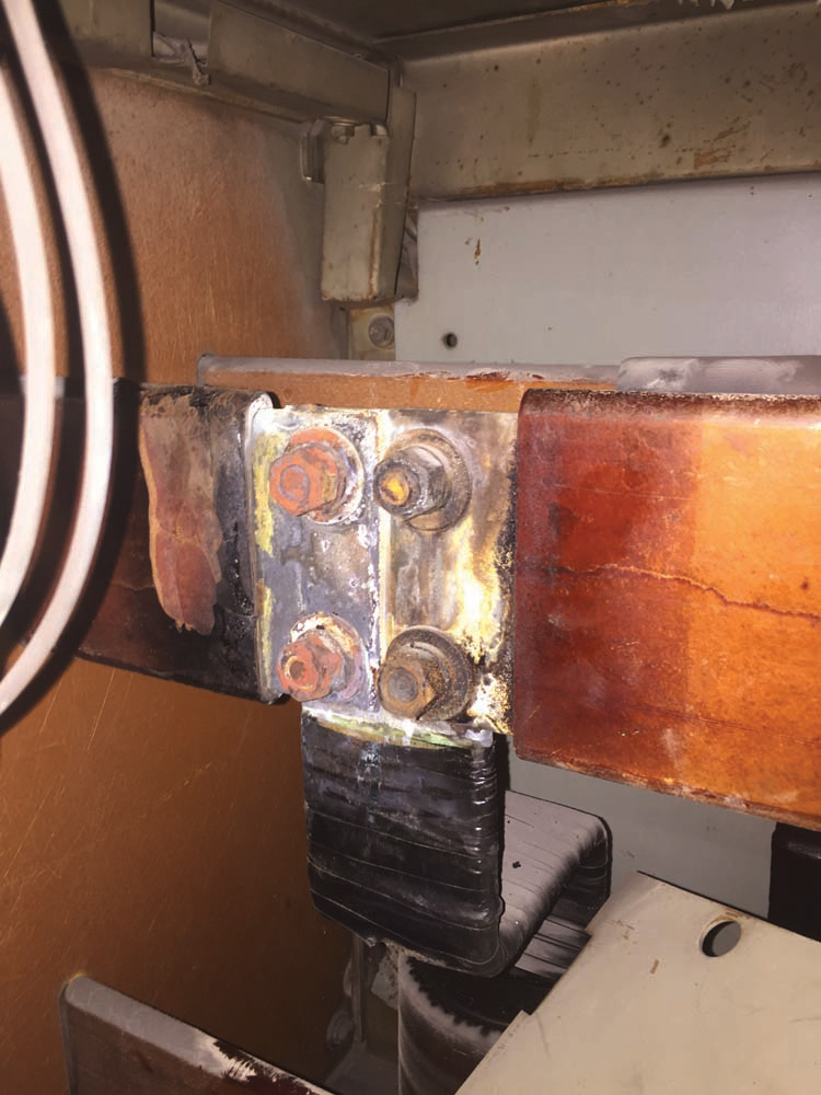

Internal damage to switchgear is a sure sign of a problem, including tracking seen on insulating components (Figure 1), burned or melted insulators, discolored conductors (Figure 2), pitting or erosion of conductors, and more. Many of these hazards hide inside switchgear and only come to light during infrequent outages, or when the equipment itself experiences dielectric failure or a thermal event.
Figure 2: Discoloration of a conductor and insulation is a sign of thermal failure. Corrosion on hardware can increase the severity of overheating.

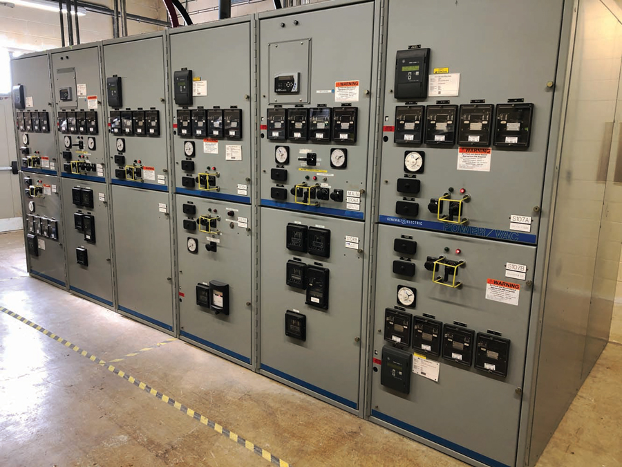

Electromechanical relays have stood the test of time, but they present many challenges in the modern world. For example, these devices can be sensitive to physical movement, sending inadvertent trip signals sometimes triggered just by opening or closing a compartment door.
They also have limited functionality. For example, if a three-phase system required both overcurrent protection and undervoltage protection on each phase, then six separate relays were required. The space required for these devices often led to additional control cabinets installed across switchgear aisles or on top of a section of switchgear, consuming floor space that could be used for other equipment (Figure 4).
Figure 4: MV Switchgear before Relay Upgrade
Using multiple devices also leads to additional points of failure and additional components to test and evaluate, extending the duration of maintenance outages. Aside from the physical constraints, there are also capability constraints. While technology has improved to include more complex monitoring, control, and communications systems, electromechanical relays have remained the same, and they cannot be integrated into these systems.

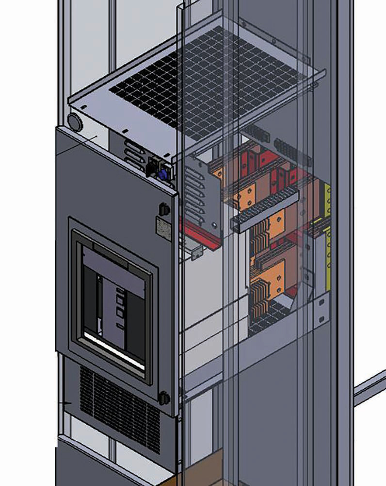

The process for a retrofill, like a relay replacement, begins with data collection. A site visit is performed to thoroughly inspect the switchgear and collect the required data for the design and installation of a new breaker during a planned outage. These details include nameplate data of the switchgear and breaker, detailed dimensional information for the construction, and a thorough evaluation of switchgear components. Those details are fed into the design, where the appropriate circuit breaker is specified, and components are designed to integrate the new breaker (Figure 6).
Figure 6: 3D CAD Model of an LV Circuit Breaker Retrofill
New components typically involve copper busbar conductors and sheet metal or insulating material structural members and barriers. The new components are specifically designed to meet the established standards for current-carrying capacity and short-circuit withstand capability. In some cases, these designs can be completed without type testing, but the best practice (and required practice for most IEEE standards) is to qualify a standard design by performing short-circuit and heat-rise testing. Using a qualified design ensures that the new installation can withstand the extreme forces and high currents of a short-circuit event and safely operate under normal circumstances without overheating. Once the design is complete and materials are fabricated, the installation can be scheduled. A retrofill of a single low-voltage circuit breaker can generally be completed in less than two days, compared to much longer installation time for a new section of switchgear. With the retrofill completed, a new circuit breaker with modern technology and little or no expanded footprint has been installed without tearing out a full section of switchgear.
