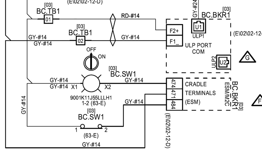

Pro Tip: Review control drawings before mobilizing. For example, the ERMS excerpts in Figure 2 and Figure 3 show connection points and power requirements. Having this knowledge upfront allows you to develop effective methods of procedure (MOPs) and avoid surprises on-site.
Figure 2: ERMS Drawing Schneider Electric
Note: ERMS is off with the switch closed.
Figure 3: ERMS Drawing LS Electric
Note: ERMS is off with the switch open.

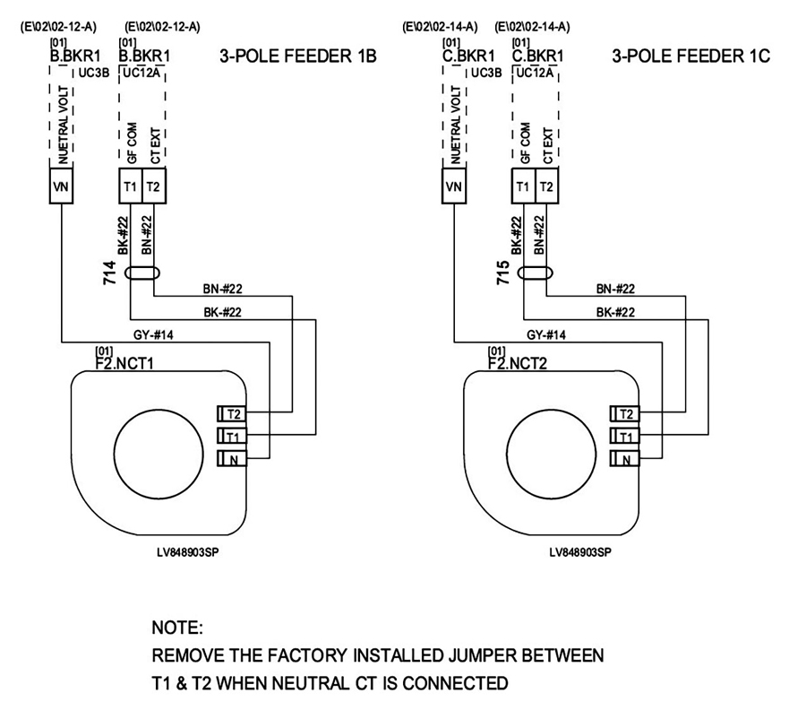

Ground-fault protection has been standard for decades, but it still causes headaches. For legacy trip units, many of us have relied on cheat sheets to remember the right method, whether it’s installing a jumper, moving a neutral lead, or using the proper secondary test set.
With today’s modern trip units, it is more critical to ensure that you have the correct software to allow for ground fault defeat. Those who have found themselves in the field downloading software tell a story of frustration. Reviewing drawings ahead of time also ensures you’re ready for the required primary current tests — trip and no-trip of the ground fault system — which confirms proper CT orientation and wiring. Figure 4 illustrates the neutral CT connections and provides a note about removing a factory-installed jumper. The devil is in the details.
Figure 4: Neutral CT Diagram

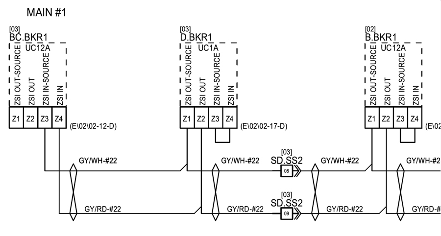

Zone Selective Interlocking
ZSI has been around for years. It allows downstream devices to clear faults while signaling upstream breakers to delay tripping. If the upstream breaker doesn’t receive that signal, it trips faster to clear the fault.
During testing, technicians must simulate this input to verify proper time-delay operation per the manufacturer’s trip curves. This is often as simple as installing a jumper between the ZSI input. In Figure 5, note the jumper needed between Z3 and Z4.
Figure 5: ZSI Drawing Schneider Electric; Interconnect Wiring Points Circled in Red
Pro Tip: Always confirm that ZSI asserts when a feeder fault occurs. Review drawings carefully, as shipping splits (circled in red in Figure 5) often reveal incomplete wiring. Some ZSI systems can be verified with manufacturer software, while others (like GE Entelliguard) require a dedicated test set.

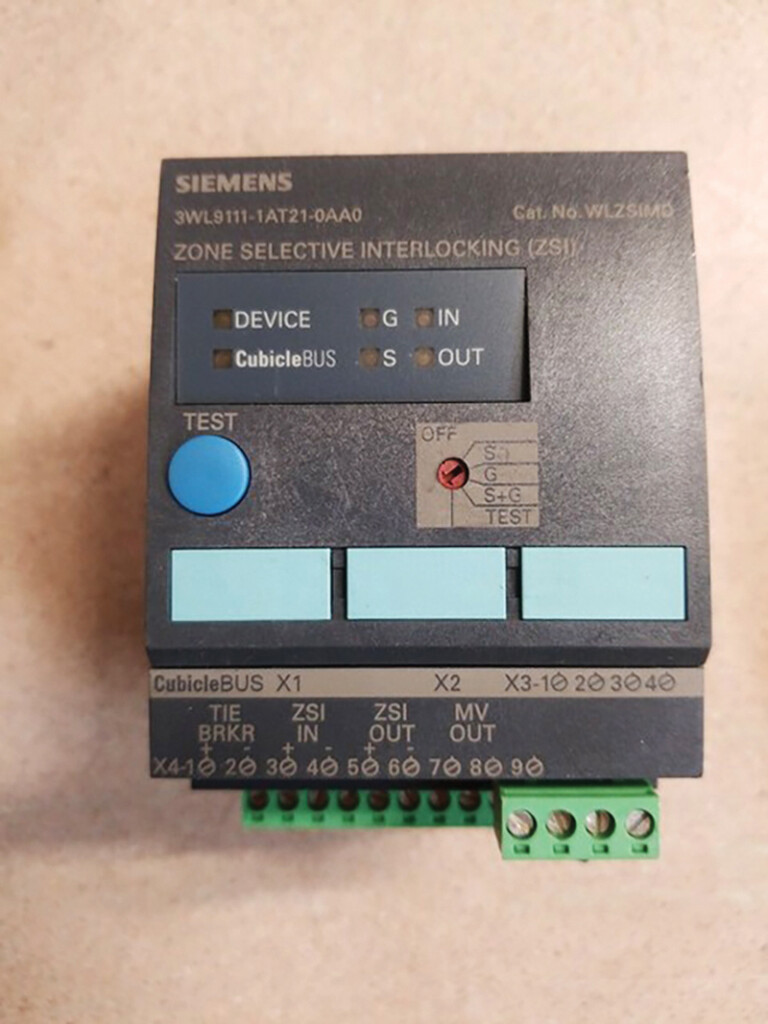

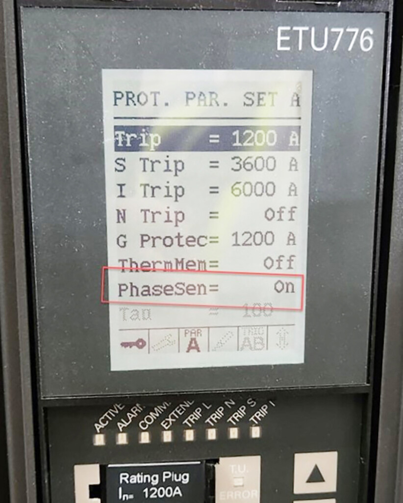

Siemens WL Breakers with ETU Trip Units
Siemens WL breakers with ETU trip units require ZSI to be deactivated before removing the breaker from its cell. If not, trip times default to instantaneous rather than the expected long-time delay. See Figure 6 for a picture of the device and plan accordingly to defeat ZSI.
Figure 6: Siemens ZSI Module
We recently encountered phase-loss sensitivity on the ETU776(Figure 7). It’s hidden under protective parameters, but it can be disabled if you know where to look.
Figure 7: PowerSen Setting
PHOTO COURTESY JOE GOSS
There is a catch, and it is in Siemens’ own literature and took some digging to find.
Phase Loss Sensitivity
When single-phase testing, make sure that the short-time delay is not set to the 20-ms setting. In this position, the phase-loss sensitivity function is enabled. This function is designed to protect motors from heavy imbalances and loss of one or more phases. When active, and the trip unit detects that the least heavily loaded phase is 50% lower than the most heavily loaded phase, the long-time pickup setting (IR) is reduced to 80% of the setting indicated on the display or dial. When this unbalance condition no longer exists, the setting is returned to normal. Single-phase testing will be recognized as a phase unbalance, and long-time trip timing will be faster than indicated in the trip curves. For an ETU776, phase-loss sensitivity is controlled by the PhaseSen menu item under the protective parameters. When a short-time delay is set to 20 ms, phase-loss sensitivity cannot be turned off.
Pro Tip: Ensure that Set A and Set B short-time delay parameters are above 20 ms to avoid phase-loss creating testing problems.

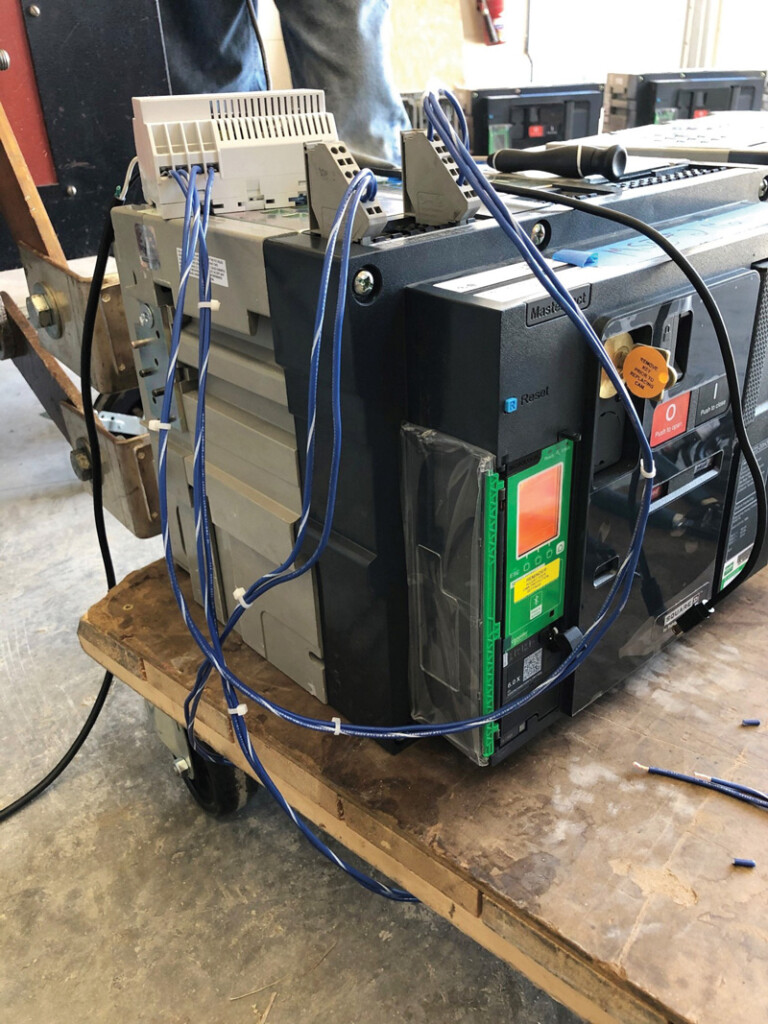

On MTZ breakers with 6.0X trip units, ERMS can be disabled before removing the breaker as long as 24-VDC control power is applied and EcoStruxure software is available. If the breaker is pulled first, you’ll need a 24-VDC power supply and secondary plugs to power the trip unit outside the cell and then deactivate ERMS through software. See Figure 8 for a basic layout of the connections required.
Figure 8: MTZ Breaker Power Supply Connections for ERMS Defeat
PHOTO COURTESY JESSE MASSMAN
Pro Tip: Build a dedicated kit for these various breaker types: Use a 24-VDC supply (most common, although some use 120 VAC), appropriate secondary plugs (don’t use a paper clip as seen in Figure 9), a cradle interlock defeat tool, and other tricks of the trade.
Figure 9: Paper Clip Used as a Jumper

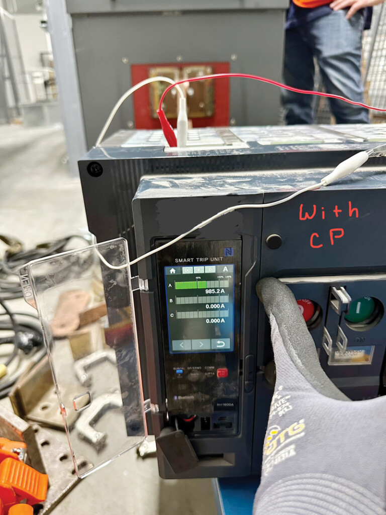

Our first encounter with LS Electric breakers came during a maintenance outage. The customer had secondary test sets for powering up the trip units and defeating ground faults. However, upon testing the first breaker, the trip unit displayed odd readings — about 30 amps (Figure 10) on all three phases during a 1000-amp single-phase test. After repeated failures, we contacted the manufacturer.
Figure 10: 30-Amp Current on All Three Phases
The issue: Not all LS Electric trip units are self-powered. Secondary test sets alone don’t provide proper control power. External control voltage must be applied to these units in the same way as a switchboard. Once we supplied 120-Vac control power, the breakers tested as expected (Figure 11).
Figure 11: Proper Current Display

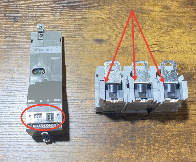

Are failures more common now? Maybe, maybe not. But during recent acceptance testing of 800-A bolt-in breakers, three out of four failed to trip on A-phase during primary injection testing. Secondary injection showed that the trip units functioned properly and confirmed that the CTs were good.
At the manufacturer’s direction, the trip unit was installed in a new breaker. A-Phase still failed. The lesson learned, once the trip unit was removed: In this breaker/trip unit design, the CTs are integral to the trip unit. The other lesson is that secondary injection does not identify all trip unit issues. The red arrows in Figure 12 point to the CTs on the trip unit.
Figure 12: CTs Integral to the Breaker (left) vs. Integral on a Trip Unit (right)
In contrast, a Micrologic 6.0 trip unit relies on CTs that are integral to the breaker and provide input to its processor via a plug connection(s) circled in red (Figure 12). This is an important distinction to understand when troubleshooting trip unit failures and corrective recommendations.
