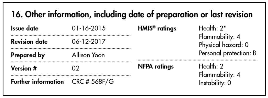

The Hazardous Materials Information System® (HMIS®) is commonly used to determine the hazard level of a chemical. Figure 2 shows the HMIS and NFPA data for a common white lithium aerosol spray lubricant.
Figure 2: HMIS Label for White Lithium Aerosol Spray Lubricant

Comparing the white lithium grease’s SDS and label and cross-referencing it to the NFPA label shows that the grease has a flash point of less than 73°F and is considered “moderately hazardous” on the health scale. Therefore, this material should not be exposed to an open flame or spark. Additionally, the material has a high enough health rating to warrant concern.  By taking proper precautions while using the grease, such as wearing protective gloves (i.e., nitrile), not concentrating and breathing the fumes, and ensuring that it is not exposed directly to open flame, the material is safe enough to use in most cases. Finally, this spray has a propane propellant, so if the material is non-aerosol, the flammability of the material is most likely significantly decreased. If this material is to be used in an area where the possibility of flames or sparks exists, a non-aerosol version would be recommended.
