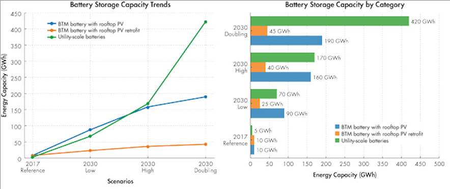

The global shift towards renewable energy, particularly solar power, is driving the clean energy revolution. However, solar energy’s intermittent nature challenges grid stability and consistent supply. Stationary battery systems offer a crucial solution for energy storage and grid management, capturing excess solar energy during peak hours and releasing it when needed. These advanced systems smooth power fluctuations, provide backup during outages, optimize energy distribution, and build a more resilient and sustainable power infrastructure.
While large-scale stationary battery storage dominates current deployment, small-scale storage is also increasing. Various scenarios project the adoption of battery storage by 2030, with the doubling scenario (Figure 1) showing increased stationary battery storage in response to the goal of doubling renewables in the global energy system by 2030.
Figure 1: Stationary Battery Storage Energy Capacity Growth, 2017–2030
Note: GWh = gigawatt-hour; PV = photovoltaic; BTM = behind-the-meter Source: IRENA, 2017[4]

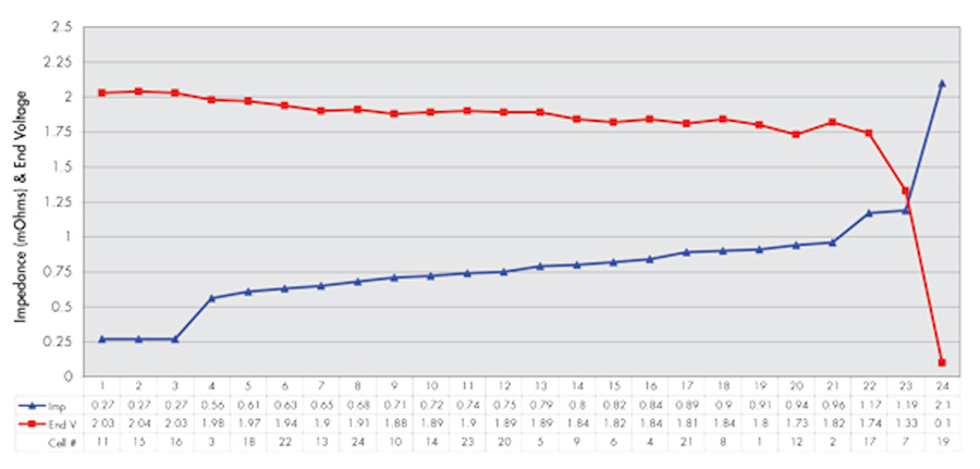

Ohmic Data Analysis
Ohmic testing, a relative assessment, compares current measurements to previous values or baselines to determine the battery’s state of health (SOH). When analyzing data, voltage examination is critical, with tolerances typically within 1% of manufacturer-specified float voltages. Ohmic values can be analyzed through percent variation from the string average, percent deviation from baseline, and changes in inter-cell connection resistance. Key indicators of potential issues (Figure 3) include batteries with 30–50% higher impedance than the string average, multiple batteries showing 30–50% change from baseline (signaling the need for a discharge test), and inter-cell connections with >20% resistance change (requiring torque checks and cleaning).
Figure 3: Ascending Impedance with Corresponding End Voltage

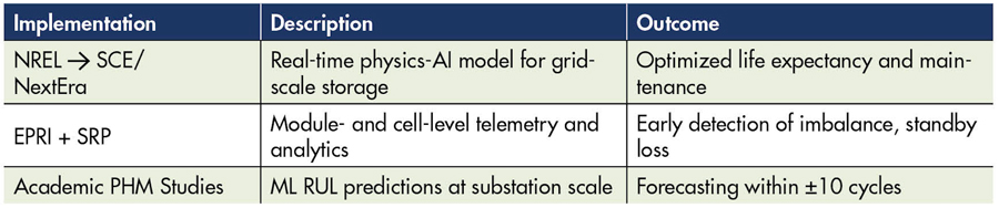

Predictive Modeling
Predictive modeling is revolutionizing battery diagnostics by transforming raw building management system (BMS) data into actionable insights across electric vehicles (EVs), energy storage systems, and industrial backup applications. By applying machine learning algorithms, such as random forests, linear regression, and long short-term memory (LSTM) neural networks, to real-time data like voltage, current, temperature, and charge/discharge cycles, predictive models can accurately estimate SoC, SOH, internal resistance, and aging rates.
Unlike traditional threshold-based diagnostics, these models recognize subtle patterns and forecast failures before they occur. A real-time example comes from a major EV manufacturer that deployed predictive analytics in its vehicle fleet: By continuously analyzing battery temperature rise during fast charging, the model flagged early signs of lithium plating in specific cells. Technicians were alerted through the fleet management platform, enabling preemptive cooling system adjustments and selective cell replacement, thereby avoiding expensive pack failures and recalls.
Similarly, in a utility-scale battery storage site, predictive modeling identified a cluster of modules with abnormal voltage decay during partial load cycles, prompting preventative maintenance weeks before alarms were triggered. After installation, these models continue learning and adjusting to operational conditions, detecting degradation under thermal stress, abuse cycles, or grid fluctuation.
Integrated with cloud platforms and digital twins, predictive modeling improves system-wide visibility, offers explainable diagnostics, and enables scalable anomaly detection across thousands of deployed assets. Ultimately, battery testing evolves from reactive checks to intelligent, real-time health monitoring, reducing downtime, enhancing safety, and extending asset life across all modern battery-dependent technologies.
Predictive modeling may be hindered by poor data quality, limited sensor coverage, model overfitting, lack of standardization, high computational demand, and difficulty adapting to new battery chemistries or unknown failure modes.
Table 1: Cases Illustrating Active Deployment and Ongoing Research Using Predictive Modeling
