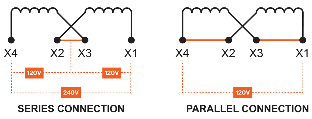

120/240
When you see 120/240 marked on a transformer nameplate, it denotes two separate 120-volt coils set up to connect in either series or parallel (Figure 3).
Figure 3: 120/240 V Series vs. Parallel Connections

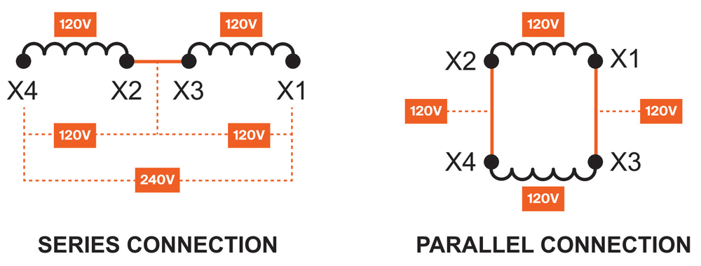

In series, the coil voltages add to equal one total 240-volt winding (Figure 4). The point where the coils connect is the neutral point. The series connection mimics the split-phase 240/120 setup. In parallel, the voltage across both coils remains 120 volts.
Figure 4: 240-Volt Series vs. Parallel Connections
Most indoor single-phase applications include 240-volt and 120-volt loads. As a result, the series connection is more common. The parallel connection is more frequent with pole-mount transformers (Figure 5).

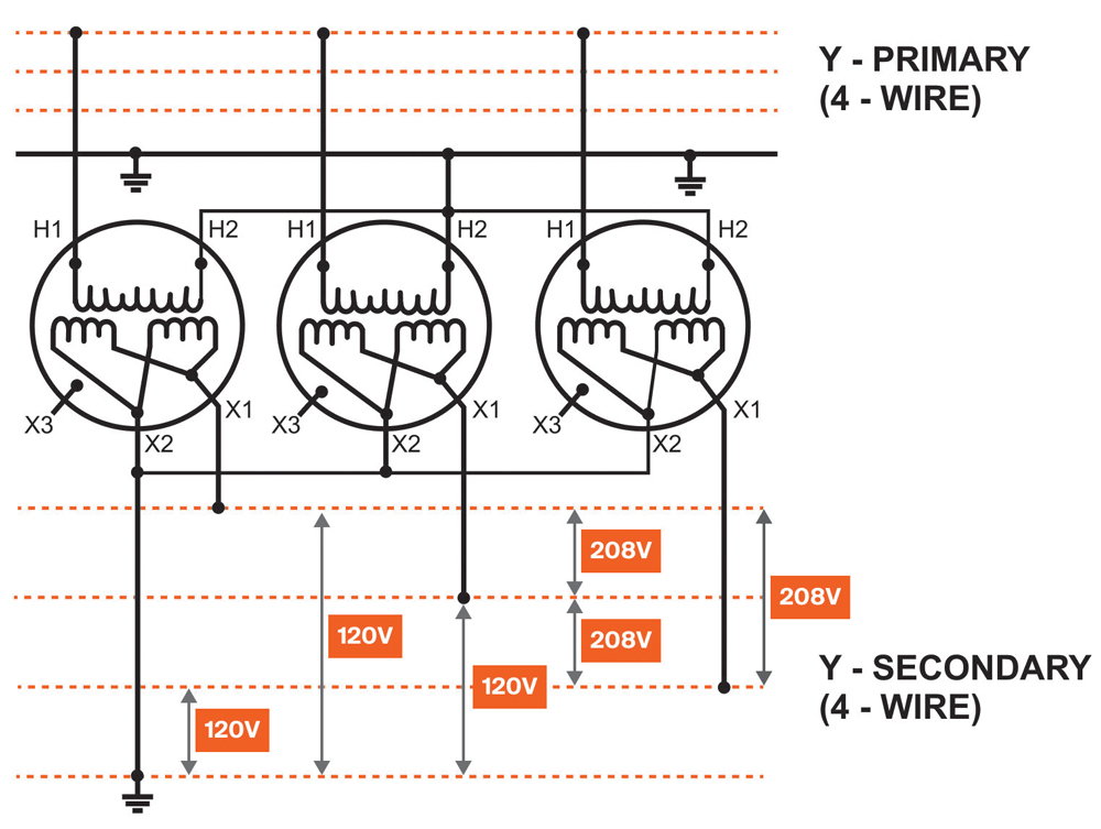

Figure 6 shows a single pole-mount with 120/240 windings in parallel. This configuration is the standard setup for three-phase pole-mount banks.
Figure 6: Three Parallel-Connected Single-Phase 120/240 Windings with One Common Neutral Point
When connected with two other identical units (Figure 7), the result is a 208Y/120-V power supply.
Figure 7: Three Single-Phase 120/240 Pole Mounts Banked Together for 208 Y/ 120

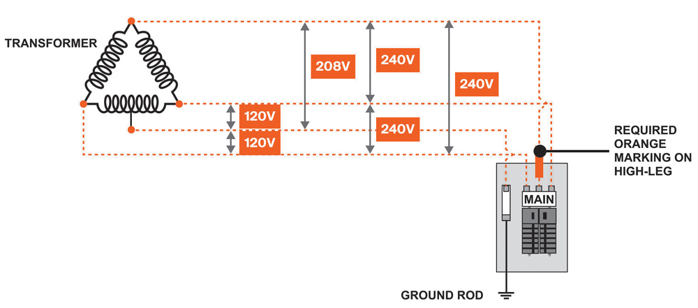

240-V Delta with 120-V Center Tap
Many 240-volt delta windings have a center tap on one of the three coils. This provides an option for a limited 120-volt output. This center tap, often called a “lighting tap,” supplies single-phase power for small lighting and receptacle loads. The coil with the center tap acts identically to the 240/120 single-phase scenario. The measurement between the center tap and adjacent phases is 120 volts. The measurement between the center tap and the opposite phase yields 208 volts.
The phase that measures 208 volts from the center tap (Figure 10) goes by many names: high leg, wild leg, stinger leg, etc. The high leg is very common in older delta supply systems in the US. This configuration works best for three-phase installations with minimal 120-volt needs. The amount of single-phase 120-volt loading should not exceed 5–10% of the supply transformer kVA.
Figure 10: Three-Phase High-Leg Delta

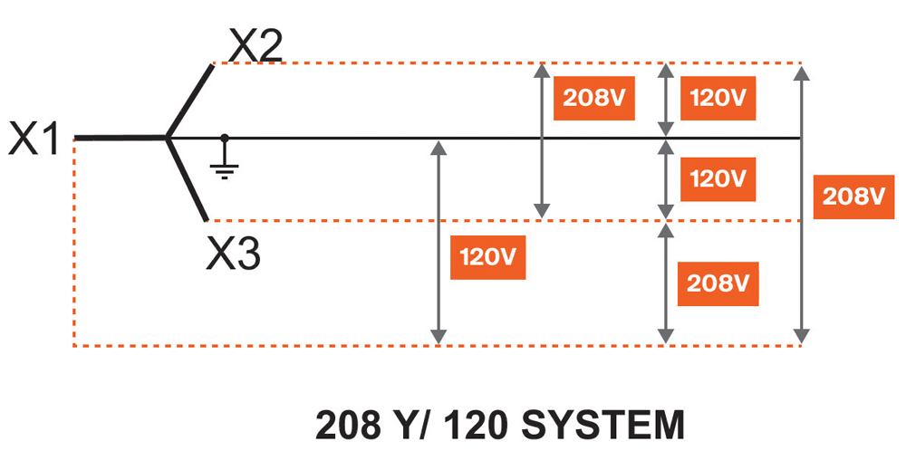

208 Y/ 120
208 Y/ 120 systems supply both 120-volt single-phase and 208-volt three-phase loads (Figure 12). This configuration is common for commercial establishments such as apartment buildings. In this setup, three-phase power runs larger equipment. The 120-volt supply serves single-phase loads such as lights, receptacles, and appliances. This system works best for buildings with larger 120-volt loads. The common neutral point allows balanced loading (unlike the high-leg delta system).
Figure 12: 208 Y/120 System

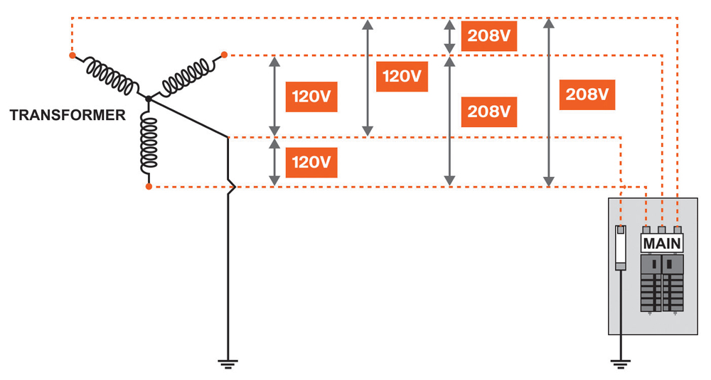

MEASURING SYSTEM VOLTAGE
The voltage between the ungrounded conductors in a system is the line voltage, also called phase-to-phase voltage (Figure 14). To determine the phase-to-phase voltage, test the voltage between A, B, and C phases at the main panel. This equates to measuring the voltage between H1, H2, and H3 or X1, X2, and X3 on a transformer. In Figure 14, the line voltage is 208 volts.
Figure 14: Measuring Line Voltage
Measuring Line to Neutral
The voltage between the ungrounded and grounded conductor(s) in a system is the line to neutral voltage. In Figure 15, the line to neutral voltage is 120 volts. At the main service panel,  measure between the neutral bus and the A, B, or C phase terminals.
Figure 15: Measuring Line to Neutral

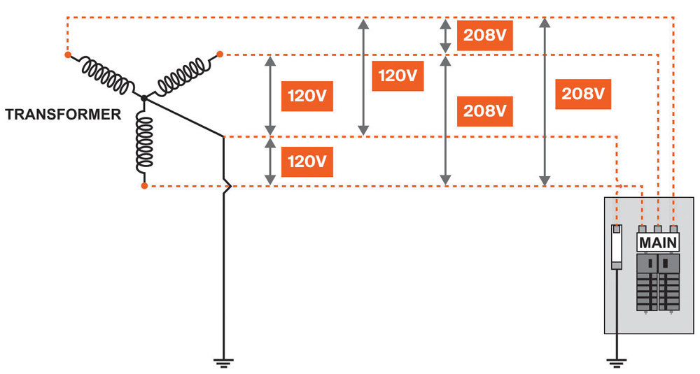

Measuring Line to Ground
Line-to-ground measurements are sometimes misleading. A predictable measurement requires an intentional bond to Earth (ground). This bond is made at the source transformer neutral or first service disconnect. Redundant or faulty neutral-ground bonds will often obscure voltage readings. In a solidly grounded system, the line-to-ground and line-to-neutral voltages are the same.
Figure 16 shows a solidly grounded system. The neutral point of the source transformer bonds to Earth ground. The common bond causes the line-to-ground and line-to-neutral measurements to share the same value. In this example, the line-to-ground voltage is 120 volts.
Figure 16: Solidly Grounded System
Voltage readings line-to-ground vary for ungrounded systems. Examples of ungrounded systems include delta and ungrounded wye. In such cases, measurements may vary widely.

Pro Tip: Distinguishing between 208 Y/ 120 and 240 Delta High-Leg Systems
The high-leg delta system is sometimes mistaken for 208 Y/ 120. This is usually when only line-to-ground voltages are recorded at the service panel. The 208-volt reading across the center tap and high leg can be misleading. Remember, a 208 Y/ 120 system will measure the same voltage line-to-neutral between all phases. Avoid this problem by measuring the line-to-line voltage (240 volts) at the panel (instead of line-to-ground).
