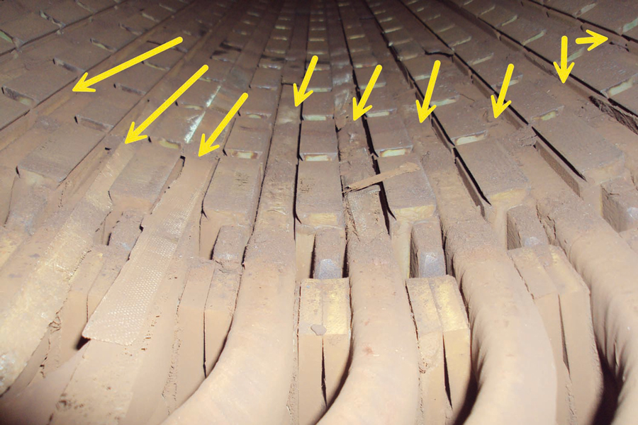

A majority of wind turbine generators use ferrous wedges to reduce air-gap harmonics, resulting in improved efficiency, reduced noise, and cooler operation. When balanced, there are no peaks. However, when wedges become loose or come out of the slots (Figure 4) due to poor keying, moisture exposure causing degradation of the ferrous materials, or coil looseness, a stator signature becomes dominant. The signature appears as in Equation 14 with any decibel level above the noise floor indicating wedge issues or coil movement.
Figure 4: Multiple Missing Wedges in 3-MW Wind Generator Stator

As the dB level increases above the noise floor, more wedges have been dislodged. The exception is when coil vibration, including endwinding vibration, occurs in over-extended or loose coils, in this case, increasing dB levels generate a warning prior to coil failure. These will often be found with a stator winding signature as shown in Equation 15.
Equation 15

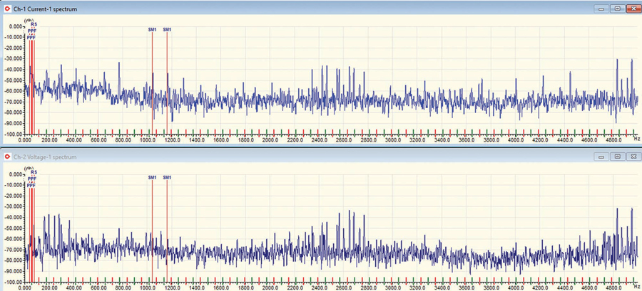

A signature associated with winding stress, which can indicate insulation breakdown, sparking, or partial discharge, indicates the final stages toward winding to ground or winding short defects (Figure 4). When there is a combination of the above, action should be taken immediately, often requiring insulation repair or rewind. When caught before the winding stress signature, wedge repairs may be possible (Figure 5).
Figure 5: Stator Wedge Signature for Stator in Figure 4 (Data Collected at 10 kHz)
