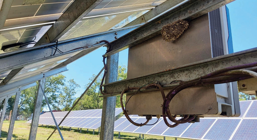

Visual Inspection
What may seem like a no-brainer is a valuable and often time-efficient means of adequate maintenance. Look for incomplete installation details and sufficient compliance with local applicable standards. These shortcomings can be inordinately costly if left unattended until well into the life span of the array. Visual inspection can spot physical damage and equipment modification or degradation from environmental conditions such as temperature extremes, dust, corrosion, and moisture. Solar arrays may also be subject to considerable damage from rodents chewing wires and birds building nests in the structure.
Visual Inspection Detecting Insects on Solar PV

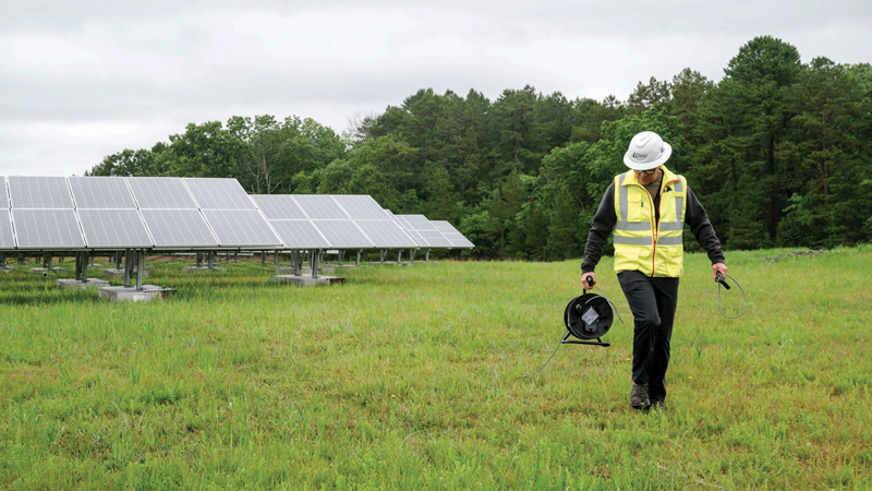

Continuity
This testing verifies that adequate low-resistance bonding has been established between module frames, conductors, structures, connectors, and other terminations in de-energized circuits and the grounding system. Simply bolting or crimping metallic components together is insufficient to guarantee that the required current flow can be accommodated without overheating, sparking, or other dangers, not to mention the possibility that in the complexity of a large grid, some connections and terminations may be missed altogether. The grounding electrode conductor should be verified as continuous, and accepted methods should assure the viability of irreversible splices, welds, and other connections.
Continuity Testing on Large Solar Array
The connection of the grounding conductor to the ground electrode (ground rod) must also be verified, as it may be called upon in fault situations to accommodate currents well above system values. It also includes continuity bond testing of metal cable trays, enclosures, frames, fittings, and other components that may be grounding conductors in fault situations. Electrical continuity can be lost due to inadequate mechanical installation. Be sure to test the electrical continuity between the grounded PV array source circuit, output circuit conductors, and ground electrode conductors. Remember to re-establish this bonding when equipment is removed for service or replacement.

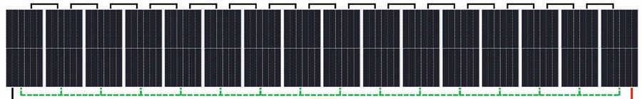

To identify faulty strings, first verify the open voltage of all strings. Then divide the voltage of a good string by the number of modules in series. This determines the module voltage. For example, if the voltage of a string of 10 modules in series is 500 V, then the voltage of each module is 500 ÷ 10 = 50 Vdc per module. If measuring on a faulted string, the voltage equals 400 V, and the voltage per module is 50 V, then 400 ÷ 50 = 8.
To detect ground faults in a grounded string of solar PV panels, you can use a high-quality voltmeter. For instance, if you have 16 panels and each panel has an open-circuit voltage (Voc) of 50V, then the total string voltage would be 800V. When there is a ground fault, there will be a voltage imbalance in the circuit. This imbalance can be measured between the positive terminal and ground, and then between the negative terminal and ground. If the positive-to-ground voltage is 200V and the negative-to-ground voltage is 600V, then the ground fault is between panels 4 and 5 from the positive side. You can identify this by taking the voltage to ground value and dividing it by the Voc of the installed panels.

Identifying Ground Faults on a 16-Panel String Using Voltage Tests

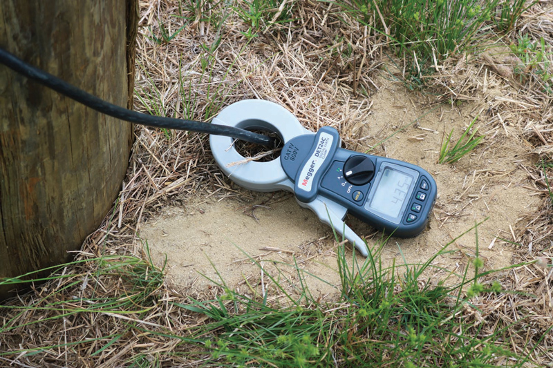

Earth Leakage Current
Systems equipped with residual-current devices (RCDs) can be tested for nuisance tripping. Such devices monitor the current flowing in line conductors and compare it to the return current in the neutral. If the difference in currents exceeds the device’s sensitivity setting (typically in milli-amperes), the device will trip and open the circuit. A clamp-on ammeter is clamped around the line, and neutral conductors are clamped separately. The difference between the two readings is the earth leakage current.
Leakage Current Testing
