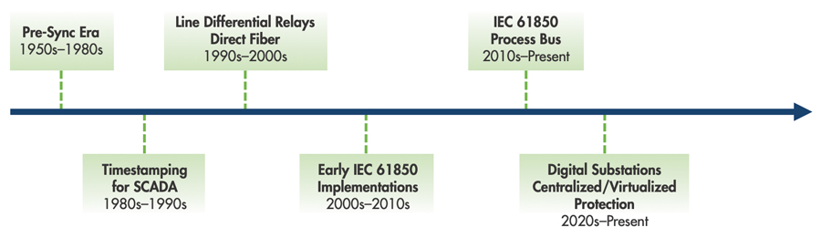

The timeline (Figure 1) shows how time moved from a background detail to a core element in digital substation designs. Until the 1980s, relays used local clocks, and time was mainly for event logging. In the 1990s, digital line differential relays over direct fiber offered better protection for the line than traditional schemes, but precise time alignment between terminals was required. However, this time sync was typically over direct fiber and not station-wide. In the 2010s, with IEC 61850 process bus and sampled values, timing shifted to a station-wide service often synchronized globally through a GPS antenna,  passed through Ethernet switch hardware, and finally to the end device’s internal clocks, enabling multiple IEDs to be synchronized to a common time reference.
Figure 1: History of Time Synchronization in Substations

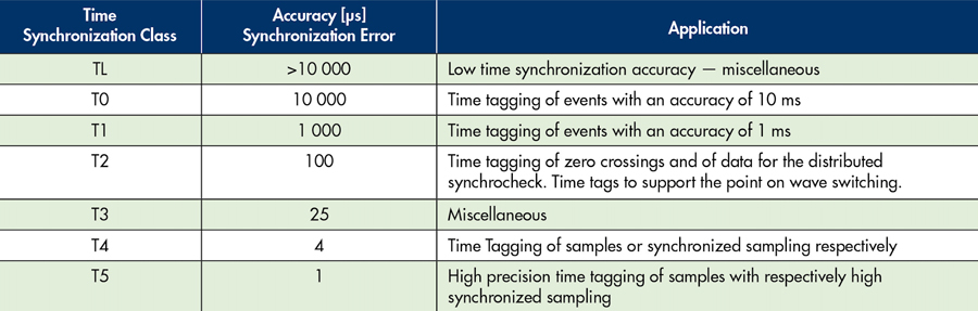

With many modern schemes, protection elements depend on synchronized, time-stamped signals for proper functionality. When signals are time-stamped by different devices and later realigned in the relay, any synchronization error rides along with the data. If that error exceeds the element’s tolerance, the comparison can be biased enough to cause misoperation. Therefore, the synchronization status must be monitored, and selected functions must be blocked if necessary. At the same time, certain protection functions are not sensitive to the synchronization status of devices, such as overcurrent.
Table 1: Time Synchronization Classes
A practical approach is to actively monitor the synchronization status and/or accuracy and block only those protection functions that rely on tight synchronization, leaving others in service and re-enabling sync-dependent functions once acceptable conditions are restored. This remains consistent with the traditional goal of power system protection: Balance reliability with availability.

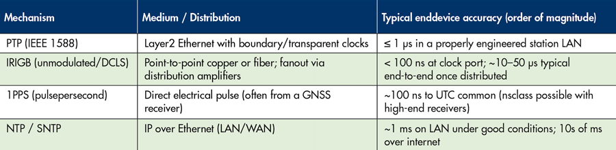

protocols such as IRIG-B, NTP, PTP, and 1PPS are used in substations. These protocols (Table 2) offer varying levels of accuracy, different mechanisms for distributing periodic synchronization messages, and different media on which the messages are sent.
Table 2: Synchronization Protocols Used in Substations
Precision time protocol (PTP) has proven to be an ideal protocol for modern substations due to its accuracy and the fact that this packet-based protocol uses Ethernet as a medium, which is already present in modern substations. However, a system designer must ensure that the equipment is PTP-capable as well as tried and proven. As we’ve all come to learn, multi-vendor standards can be interpreted differently by different vendors.

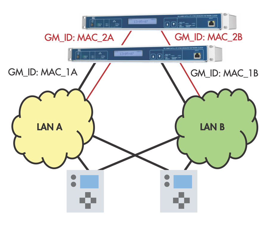

Designing a substation-grade timing system requires careful engineering so that time synchronization does not become the Achilles heel of the overall protection scheme. Hardware must be selected from reputable vendors with proven, standard-compliant PTP implementations. The architecture should avoid single points of failure by providing redundant time sources and redundant paths. In protection, redundancy is a proven means of enhancing reliability; the same philosophy applies to the timing infrastructure.
Beyond hardware, correct operation depends on a solid understanding of the relevant PTP profiles for power systems (for example, IEEE C37.238 and IEC/IEEE 61850-9-3) and consistently configuring those profiles across clocks, switches, merging units, and protection relays. Parameters such as domain numbers, delay mechanisms, message rates, BMCA priorities, and holdover behavior must be coordinated so the timing system remains accurate enough under both normal and contingency conditions. If the accuracy is lost or degraded, then the protection settings must disable certain elements. This can be done by internal logic in the relay, configurable logic, or settings.
Figure 3 shows an example of a redundant substation timing system with two potential master clocks, redundant paths over the parallel redundancy protocol (PRP), and redundant ports on the end devices. A designer must understand how the devices handle redundancy.
Figure 3: Redundant Substation Clocks Connected to PRP Networks

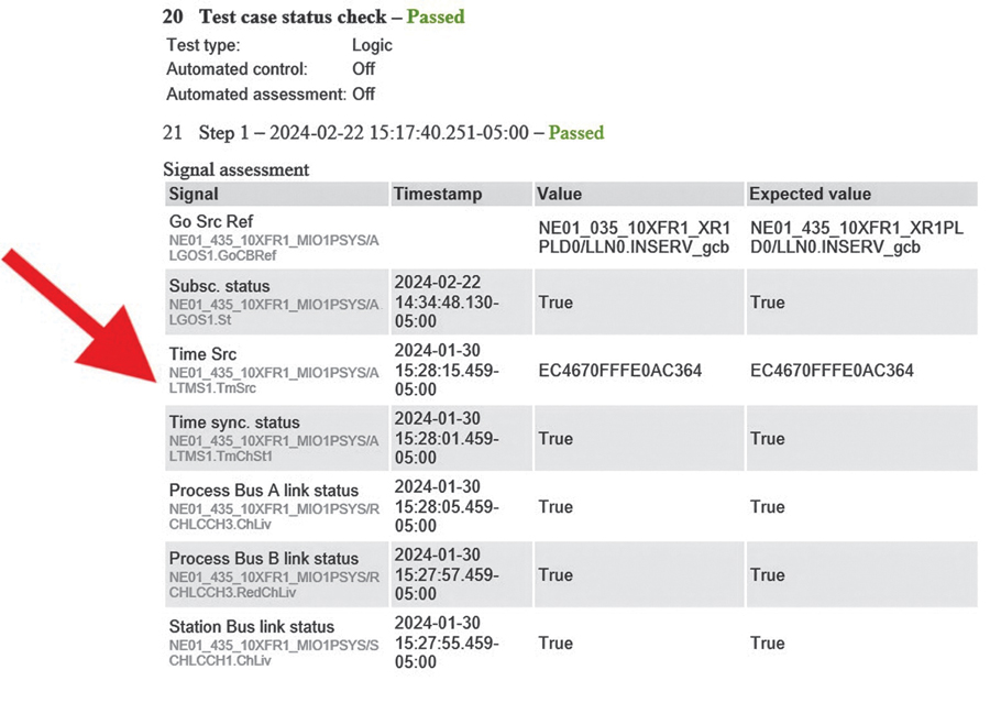

To verify synchronization, the IEC 61850 test software can poll each IED (merging units and protection relays) to verify its synchronization status via the LTMS logical node. Instead of verifying this individually in a time-consuming manner, the system configuration language (SCL) file can be exported from the configured project and imported into the test software. This is yet another advantage of testing in digital IEC 61850 environments. Based on the imported SCL file, we can select the LTMS logical node from the signal list for each IED. Once this is configured, we can refer to it as our substation timing system test plan and perform the test.
A report (Figure 7) is then generated showing the synchronization status of each device from the signal list. The test plan can also be saved and used as a template. This will serve well once it is time to fail over from the primary time source and see how the substation timing system reacts.
Figure 7: Automated Test Report Generated with Sync Status
