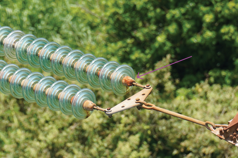

  • RGB imaging provides the most familiar perspective: visual documentation of physical condition. It captures issues such as broken hardware, contamination, structural degradation, or vegetation encroachment while offering valuable context for situating other findings.
Figure 1: RGB Imaging — Insulator Corrosion

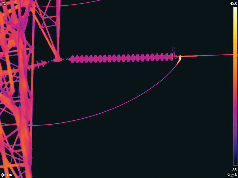

  • Infrared thermography identifies thermal anomalies, such as heating at joints, loose connections, or overloaded components. These issues may not be visible to the naked eye, but they present as temperature gradients indicating inefficiencies or impending failures.
Figure 2: Infrared Thermography

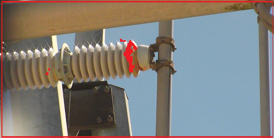

  • Ultraviolet imaging detects corona partial discharges. Unlike infrared, which identifies heating effects, UV reveals electric field phenomena that often precede thermal symptoms. This makes it an essential early-warning tool for insulation degradation, damaged components, improper installation, and contamination issues.
Figure 3: Ultraviolet Imaging

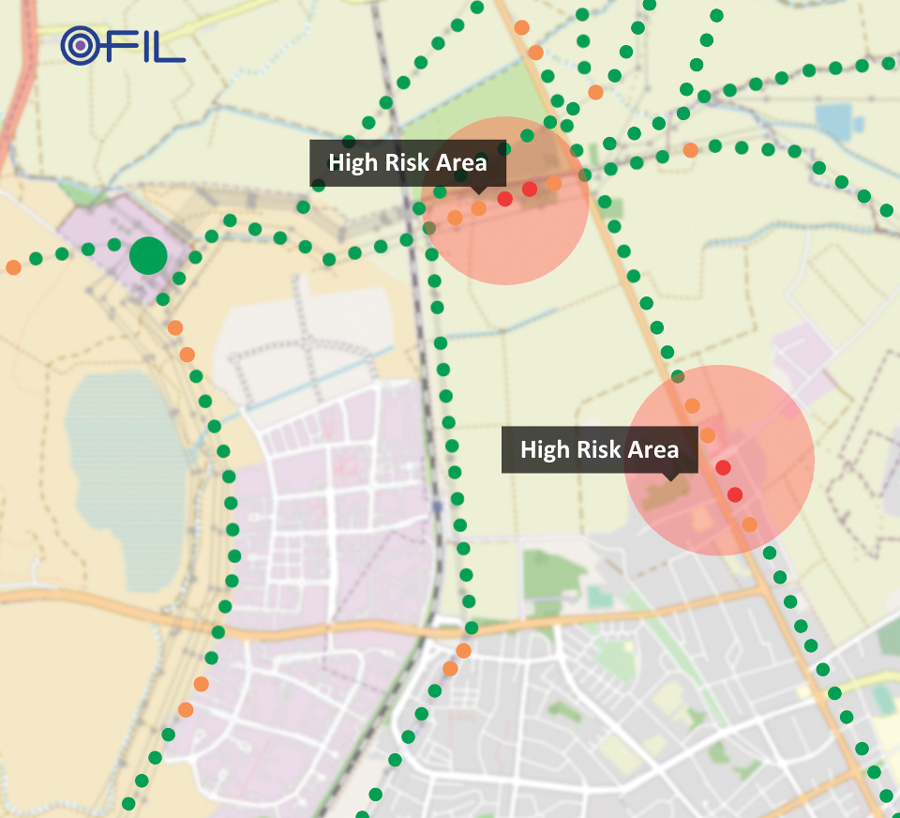

GIS integration plays a central role because it anchors inspection findings to the physical structure of the grid. By connecting each detection to a specific tower, pole, or substation with precise coordinates, utilities can organize inspection records in ways that mirror the real-world layout of the system. This ensures that when a hotspot is found or a corona discharge is detected, maintenance crews know exactly where to intervene. Accurate location data is also critical for downstream processes such as issuing work orders, scheduling crews, or planning outage windows. Without geospatial grounding, even high-quality inspection data risks being underutilized.
Figure 4: Geospatial Risk Dashboard
Beyond basic localization, GIS enables utilities to track asset condition over time. By maintaining a georeferenced history of inspections, teams can monitor how defects develop and whether they stabilize, worsen, or recur after maintenance. Overlays of inspection results across the network can also reveal spatial patterns of degradation — clusters of hotspots along a line segment or concentrations of corona activity in regions with heavy contamination or adverse weather. These patterns provide insights into systemic risks that would not be visible from isolated reports.

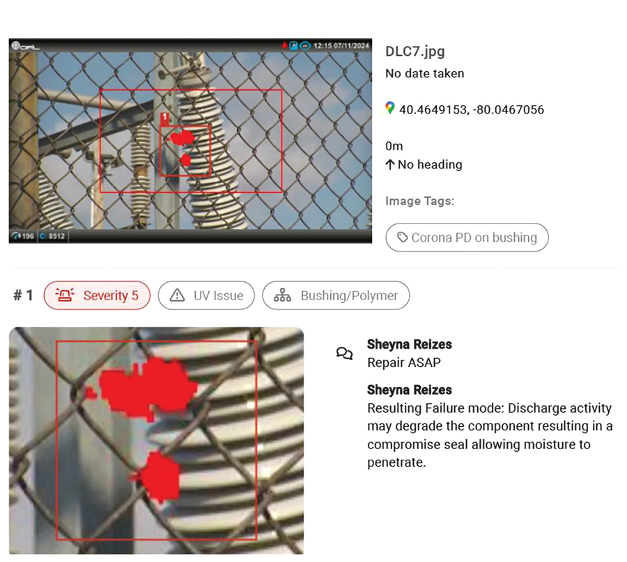

DIAGNOSTICS AND THE SEVERITY METHODOLOGY
One persistent challenge in inspection data is subjectivity. Visual interpretation can vary not only between inspectors but sometimes even for the same inspector under different conditions, such as lighting, weather, or workload. This variability undermines consistency and makes it difficult to compare results across teams or over time. To address this problem, structured severity methodologies have been developed to convert qualitative findings into standardized, quantitative assessments.
Condition Assessment
The foundation of this methodology rests on two dimensions. The first is condition assessment, which is derived directly from inspection data. Ultraviolet imaging provides evidence of corona activity, infrared thermography identifies overheating at joints and connectors, and visual imagery documents cracks, contamination, or physical wear. On their own, these observations risk being interpreted subjectively; structured methodologies provide guidance on how to classify and score them.
This is where the EPRI field inspection guidebooks have become indispensable. These guides provide utilities with detailed procedures for interpreting inspection results, ensuring that findings are not left to individual judgment. Instead of relying on inspector intuition, evaluators follow a step-by-step framework that translates imagery and sensor readings into standardized categories of severity.
For example, a corona discharge observed at a certain location on a component will correspond to a specific severity class, while thermal anomalies above defined thresholds are mapped to graded risk levels. By anchoring the interpretation process in published criteria, the EPRI guides reduce variability and promote uniformity across organizations.
Importantly, the EPRI methodology does not stop at classification. It also offers actionable insights and recommendations. Each severity level is associated with guidance on what actions should be taken:
  • High-severity findings may require immediate intervention or shutdown.
  • Medium-severity issues may be scheduled for near-term maintenance.
  • Low-severity findings may simply be monitored over time.
In this way, the EPRI frameworks directly link diagnostic results to operational planning, turning inspection data into a driver of decision-making rather than a static report.
Figure 5: EPRI-Based IR Inspection Report
