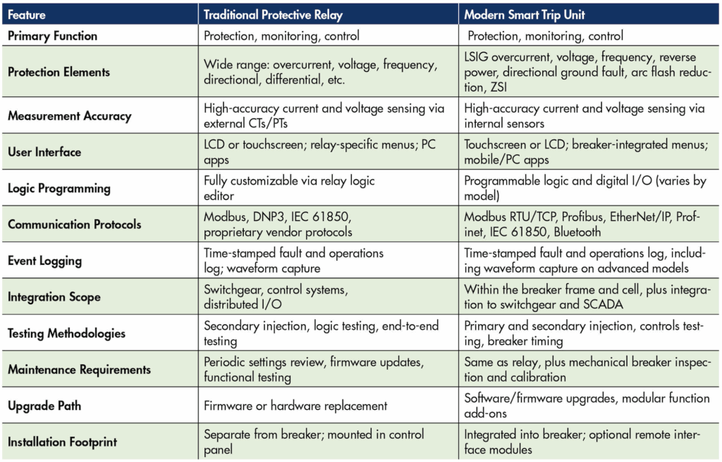

TRIP UNIT VS. PROTECTIVE RELAY ARCHITECTURE
Trip unit architecture first evolved beyond thermal magnetic overcurrent protection to systems consisting of current sensors, adjustable dial settings, and the introduction of additional features such as short-time and ground fault protection. Later, new microprocessor-based generations added digital displays, metering capabilities, and trip indication/logging, allowing easier event analysis.
In most cases, the entire protection system still existed within the confines of the circuit breaker frame. The newest smart trip units now include voltage and power-based protection options, arc flash reduction protection, zone-selective interlocking, programmable digital I/O capabilities, communication protocols, and computer-based user interfacing. These capabilities have extended the trip unit architecture beyond the circuit breaker frame and cell to include external components such as control switches, contact inputs and outputs, power supplies, and networking modules.
In comparison, protection relay architecture is quite similar. Instrument transformers provide current and voltage signals. Relays provide metering, computer-based interfacing, and digital, analog, and communication inputs. They record indications and events, produce direct trip commands, initiate communications-based trip schemes, and complete other logic-driven processes. Relays still maintain an edge over trip units in terms of customization, advanced fault recording, and I/O and logic processing, but the differences are becoming indistinguishable.
