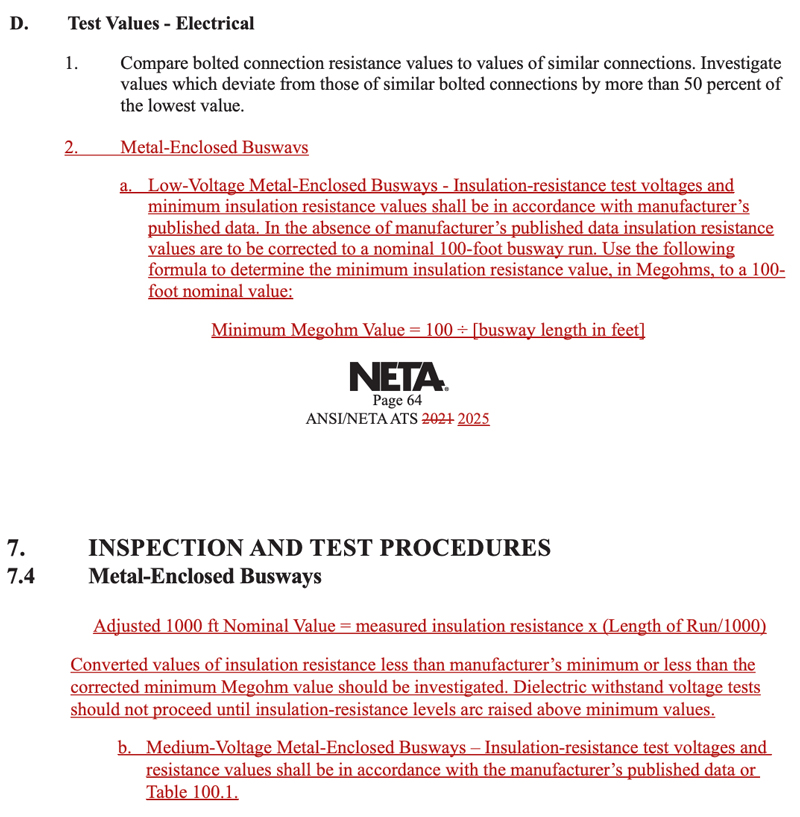

  • Appendix B: Guidance for Circuit Reliability Considerations for Medium- and High-Voltage Cable Testing Methods (Pictured below).
A noteable revision in ANSI/NETA ATS-2025 is found in Section 7.4.D.2.a-b., Metal-Enclosed Busways. This update introduces separate formulas for low-voltage and medium-voltage systems and replaces the previous nominal 1,000-foot run length with the actual busway length in feet, enhancing the applicability of testing procedures.
Example: A 340-foot low-voltage busduct was tested for insulation resistance, and the result was 5.4 megohms. The minimum value for this length of busduct would be calculated as follows:
Formula: Minimum Megohm Value = 100 / [busway length in feet]
Minimum Megohm value / 340 = 100 / 340 =  0.294 Megohms
Conclusion: Therefore, this 340 busduct would be acceptable.
