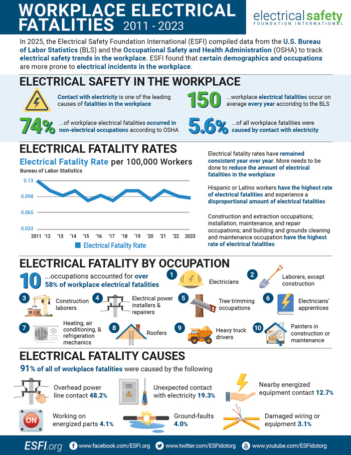

Overhead electrical line contact is one of the leading causes of fatal electrical injuries, according to OSHA, with similar data from the U.S. Bureau of Labor Statistics (BLS). Online data from OSHA and BLS consistently show that contact with overhead power lines is among the top three causes of electrocution fatalities in the workplace.
New data compiled by Daniel Majano for the Electrical Safety Foundation International (ESFI) using data from the BLS Census of Fatal Occupational Injuries (CFOI) and the OSHA 170 Forms from 2011–2023, provides great information on workplace injury and fatality statistics. You can find more information here: https://www.esfi.org/workplace-safety/workplace-injury-fatality-statistics/.

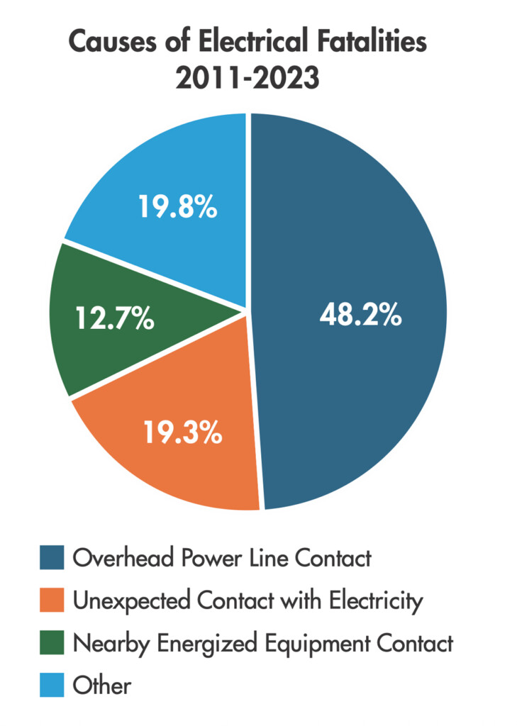

The ESFI Report included the following statement:
Overhead power line contact is the leading cause of workplace electrical fatalities. Overhead power line contact accounts for 48.2% of all electrical fatalities, 26% of electrical occupation fatalities, and 57% of non-electrical occupations. Overhead power line contacts are unique because in many cases the fatality occurred when the power line was clearly visible.
As you can also see in ESFI’s reporting (Figure 1), most of the victims (57%) are not electricians, but rather equipment operators, laborers, roofers, and drivers working near energized lines.
SOURCE: ELECTRICAL SAFETY FOUNDATION INTERNATIONAL
all electrical fatality causes are attributed to contact with overhead power lines. Because of that, we electrical workers, who should be trained and qualified in the hazards of overhead lines, should always keep an eye out for non-electrical workers on the job site and take extra steps to warn others about the hazards of overhead lines.
