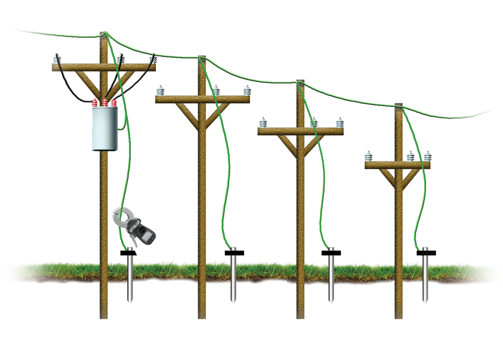

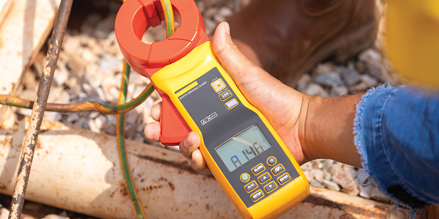

At a glance, the clamp-on ground tester resembles the familiar clamp-on multimeter, where the jaws are clamped around a current-carrying conductor and the current measurement is posted on the display. However, the jaws of a clamp-on ground tester have two windings: one to sense current and the other for voltage. With two measured parameters, the tester can calculate a third: resistance. The reading on the display is given in ohms. Beautifully simple, but what is it actually measuring? To complete the current loop back to the jaws and provide a measurement circuit, the tester must find its own path. This will usually be the nearby utility grounding system, such as pole grounds.
The success of the measurement depends on the existence of a return path close by and of negligible resistance so that it does not contribute a large error to the reading. A concentric neutral of buried power cable can also provide this element. When the clamp-on is energized, a test current is induced onto the clamped ground rod, travels through the electrode into the soil, and returns through the utility grounds and system neutral. This is bonded at the service entrance to the ground bus and therefore to the grounding conductor leading to the test item.
Figure 1: Clamp-On Tester Returning Test Signal through Available Utility Grounds
The procedure is simple but at risk of potential errors. An untrained operator can clamp the wrong part of the system and still get a reading that appears to be good. Traditional test methods require the stringing of leads and test probes, so the operator must have a general knowledge of the site and place the test probes accordingly. With a clamp-on tester, the operator has no such control and must accept the reading from the tester. In the extreme, there may be no return path at all. This would be the case with a newly installed ground that is not yet attached to the electrical system. The clamp-on has no path to complete a test circuit and is unable to perform critical commissioning tests that are often required before the electrical system is attached. This is an example of a test being defeated by an open circuit.

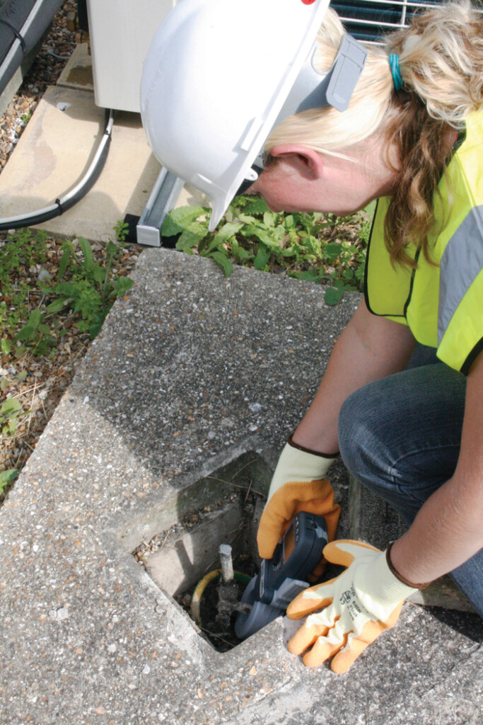

An additional consideration is measuring ground grids. There is no issue where a single ground rod exists, but grids often have multiple connections to the electrical system. In such cases, the clamp-on test current can merely circulate around the grid and provide a low reading that can be mistaken for a good ground measurement. With a clamp-on, the operator can be fooled into taking a continuity measurement for a ground measurement and recording it as such (Figure 2).
Figure 2: Technician Measuring Ground Resistance at Connection to Ground Rod
This problem doesn’t exist with traditional testing because the operator has placed the return probe outside of the sphere of influence of the grid. Uncommonly low readings from a grid should be regarded with suspicion and confirmed with additional scrutiny.

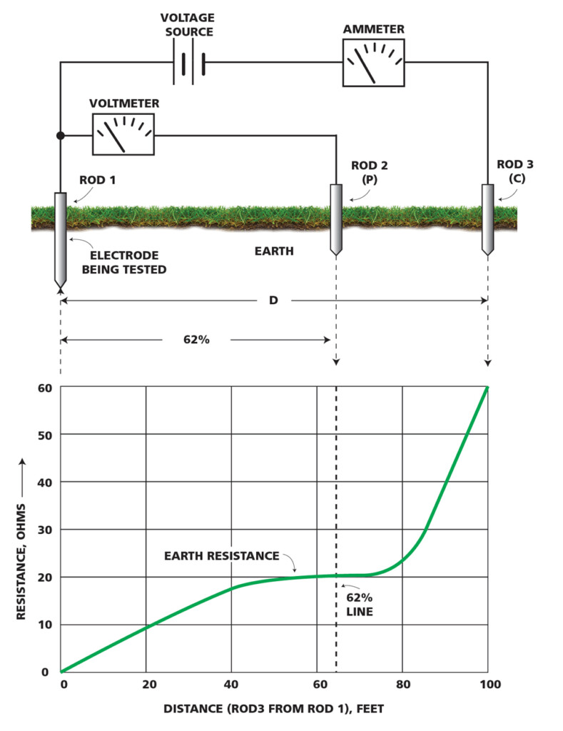

  • Three-terminal models have a common that attaches to the grounding electrode under test. The other two are current and voltage. The current terminal attaches a long lead and probe, which are placed in the soil far enough away so that their electrical sphere of influence does not overlap with that of the ground under test (IUT). When the tester is energized, a test current is established through the soil from the remote probe to the IUT. This is of a distinct frequency that the measurement circuit can recognize apart from all noise traveling in the soil. The voltage terminal connects a second probe that the operator manipulates by taking a series of measurements along a line, preferably toward the current probe, although this is not always necessary in areas of heavy congestion. Each probe placement measures voltage drop and calculates the resistance to that point.
  • The measurements are typically graphed, and modern testers do this automatically while displaying the graph as it is constructed. If the line continues to rise throughout (Figure 3A and B), the electrical zones of the test ground and current probe are overlapping, and the current probe must be moved farther away. With sufficient distance, the graph will level off.
Figure 3: A) Inconclusive Ground Test — Electrical Fields Overlapping and B) Fields Clearly Separated — Test Valid
At some critical point, there is no additional resistance with added distance. Current going to ground radiates 360° around the grounding electrode, not in a straight line as in circuitry. Therefore, at some critical point, resistance maxes out, and there will be no additional resistance with distance. By plotting a series of measurements, this point and its associated resistance value can be read from a fall of potential graph (Figure 4). If it’s at, say, 2.5 Ω, you have a good ground. If it’s at 50, start adding more rods.
Figure 4: Acceptable Fall of Potential Graph
