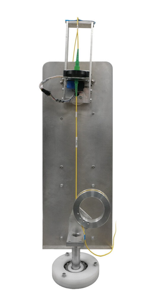

There are cable assemblies, and then there are GR-326 approved cable assemblies. Some cable assemblies are also referred to as “designed to meet or exceed” cable assemblies. However, in this scenario, there is no mention of whether the assembly is Telcordia GR compliant.

The rigorous design of a GR-326-certified cable assembly requires quality components.

For pretest IL and RL measurements, consider using an internal limit of better than 0.2 dB (objective) and 0.4 dB (requirement) to allow for some fluctuation that will certainly happen to some extent due to temp cycle/aging. The company can usually choose whether it uses a random mating process or a master test jumper for testing. This will need to be determined before environmental testing.
A good amount of empirical testing is required to fine-tune the GR-326 process. Consequently, this is the reason there are only a few Telcordia GR-326 approved cable assemblies. Beware of creative wording by the cable assembly vendors that imply they do Telcordia-witnessed or approved testing. In the end, it is an investment. Many Tier-1 providers require Telcordia-approved assemblies, and it follows that this is why GR-326-approved and accredited jumpers fetch a higher price. Quality is worth paying for, and some companies demand it.
