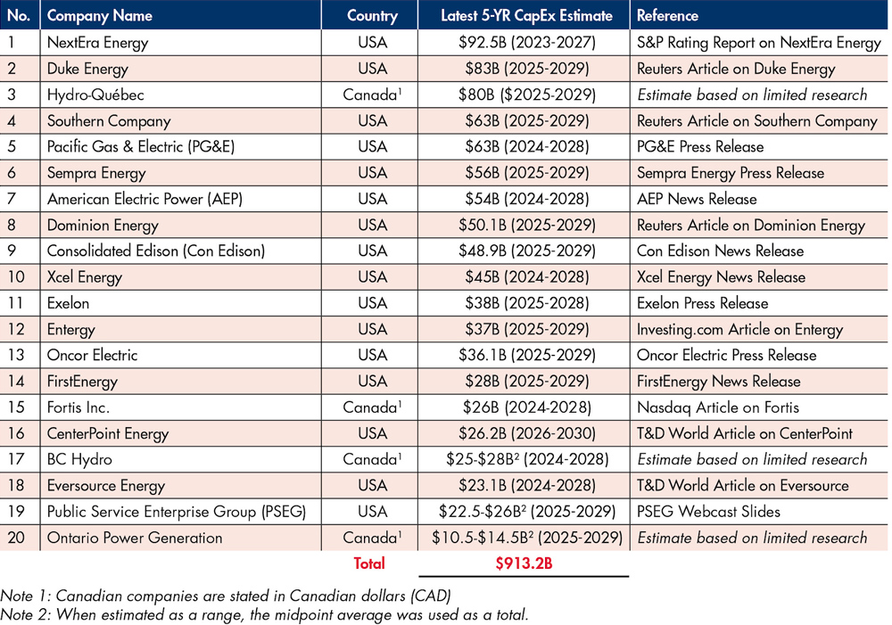

It was from that discussion that another thought emerged: If Oncor has a $36.1B  CapEx budget, what about other electric utilities across North America — or is it just a Texas thing?
So, by doing a little research, the following additional five-year anticipated CapEx trends were discovered. As a word of caution: This is not a deep dive into perfectly validated data. Rather, it is quick research to see whether other utilities were anticipating the same trends. Please understand the basis of the information and data. For a CapEx summary, see Table 1.
Table 1: Five-Year Estimated CapEx Spend for 20 North American Electric Utilities
The table is a look at the five-year CapEx budgets for 20 of (arguably) the more prominent utilities in North America, most of which are in the United States, with a few in Canada, understanding the following clarifications and data limitations:
Data Limitations: Comprehensive five-year CapEx budgets (e.g., 2024–2028 or 2025–2029) for all utilities are not always publicly disclosed in full detail. We used the most recent multi-year plans that were available, typically sourced from company reports, regulatory filings, or industry analyses like those from the Edison Electric Institute (EEI), S&P Global, Deloitte, or the U.S. Energy Information Administration (EIA).
Currency: U.S. utilities are in USD; Canadian utilities in CAD, unless converted for consistency.
As you can see, the estimated investment over the next five years for just these 20 utilities, taking into account the differences in U.S. and Canadian currencies, is approximately USD 900 billion.
Imagine what the full number looks like when you throw in every utility, every project, every state and province. It’s massive. It’s exciting. But it also raises a red flag, and it’s worth repeating the opening statements:

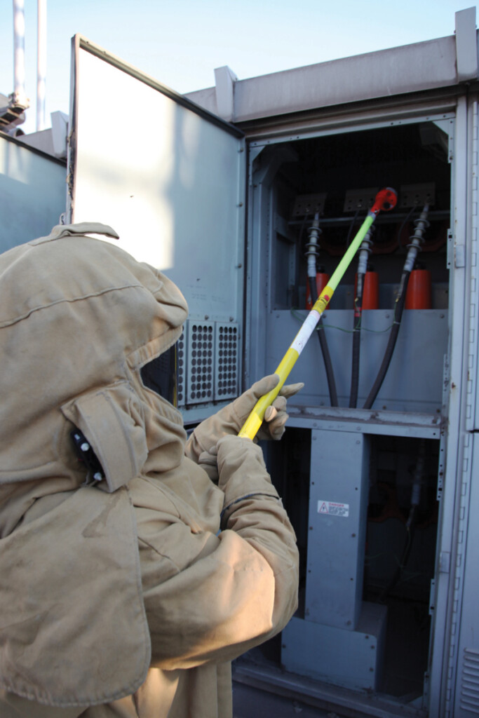

At a hospital, I stood next to a technician bypassing a 480-volt, 2000-amp transfer switch. A metal rod broke and fell across the bus. Boom! 480-volts arced, metal vaporized, and the room filled with smoke.
But here’s the kicker: We were prepared.
We were suited up with the right PPE. We turned away at the moment of the arc. Nobody got hurt.
That’s not luck — that’s training. That’s NFPA 70E in action.
