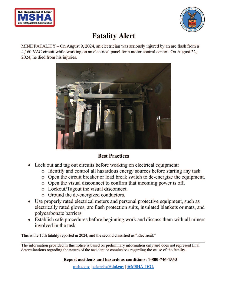

Texas: Mine Arc Fault Fatality
In the Fall of 2024, an electrician working in a Texas mine suffered fatal burns from an arc flash event. He succumbed to his injuries a few days later. The incident remains under investigation as the Root Cause Analysis (RCA) has not yet been released. At this stage, any conclusions are based on the Mine Safety and Health Administration (MSHA) fatality alert and are purely speculative. The alert suggests that troubleshooting was conducted without proper PPE, appropriate tools, or the correct test equipment, highlighting potential safety lapses that may have contributed to the fatality. It also appears that access door interlocks had been overridden to replace line fuses across the 4160 Vac contactor with the door open.
On the surface, this incident bears a striking resemblance to another fatality in North Carolina that was captured on video and is readily available on YouTube. You can view the footage here: Weyerhaeuser OSB Mill Incident. This documented event serves as a stark reminder of the devastating consequences of electrical hazards, emphasizing the critical importance of proper PPE, safe work practices, and adherence to established safety protocols.
At this point, any direct comparisons remain speculative until the RCA is officially released. However, it is important to acknowledge that the voltage involved — 4,160 V AC — exceeds the threshold outlined in OSHA 1910.269(l)(2)(i), which mandates that two qualified individuals must be present when working on high-voltage equipment. This regulation exists to provide an added layer of oversight and protection, reinforcing the necessity of strict procedural adherence, comprehensive risk assessments, and a strong safety culture to prevent similar incidents in the future.
MSHA’s Fatality Alert Best Practice statement (Figure 1) includes:
  • Use properly rated electrical meters and personal protective equipment such as electrically rated gloves, arc flash protection suits, insulated blankets or mats, and polycarbonate barriers.
  • Establish safe procedures before beginning work and discuss them with all miners involved in the task.
Figure 1: MSHA Fatality Alert
PRINTED WITH PERMISSION FROM MINE SAFETY AND HEALTH ADMINISTRATION (MSHA)
