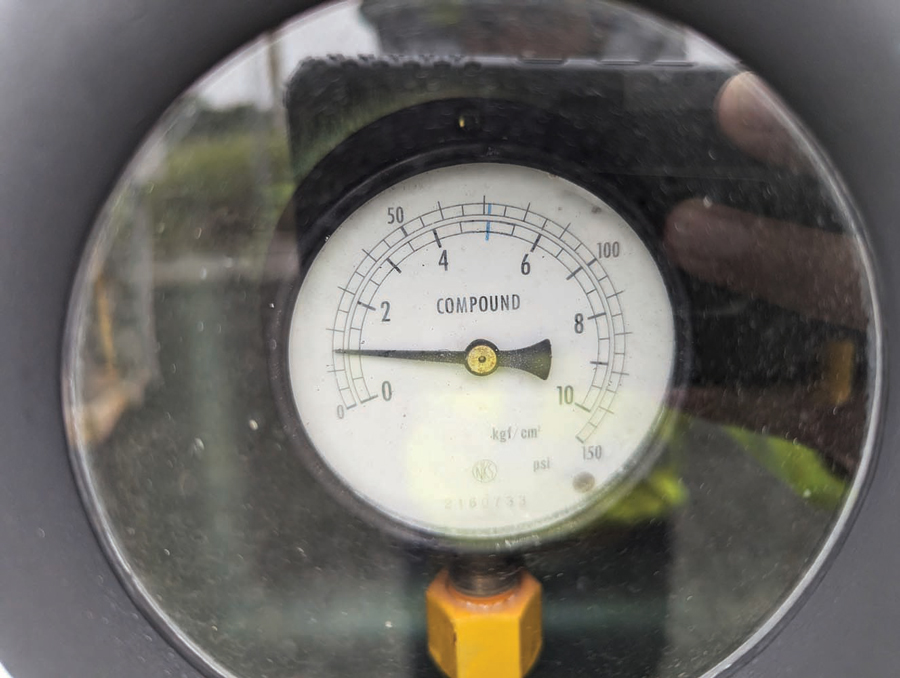

The most basic on-line assessment for an SF6 unit is visual inspection, and perhaps nothing is more important during a visual inspection than checking the pressure gauge. Figure 3 shows an SF6 pressure gauge of an energized 121-kV circuit breaker, with the needle sitting at around 15 psig, well below the minimum acceptable pressure of 57 psig according to the data plate.
Figure 3: SF6 Pressure Gauge Reading on an Energized 121-kV Circuit Breaker
No alarm or lockout functions asserted, as should have been the case. I discovered this during downtime at a substation while working on a completely different circuit breaker. Lest anyone think that the gauge malfunctioned, when the breaker was repressurized, the needle climbed back to the green line just past 70 psig. Had the gas density reached breakdown voltage, a ground fault would have ensued and likely destroyed the unit. I’ve developed the habit of checking every pressure gauge in substations, provided I have the time.

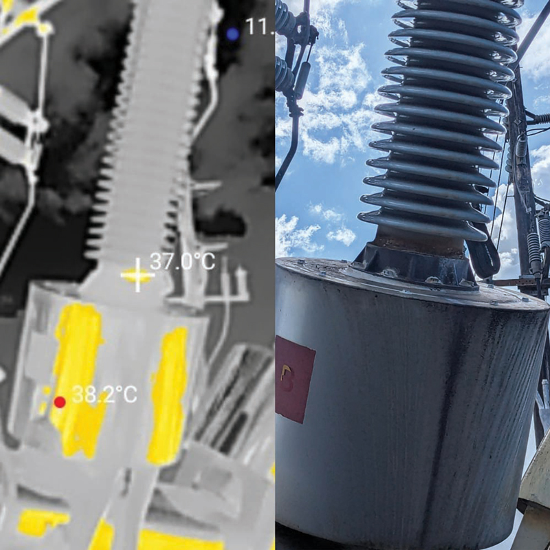

Infrared thermography is my favorite tool due to its wide applicability and accessibility. A wide range of defects developing unbeknownst to asset owners can be discovered during an infrared survey, including an anomaly I discovered in the same substation as the low gas pressure incident. Figure 4 shows a thermogram as well as a visible image of what appears to be partial discharge occurring at the camera crosshairs just above the flange and just below the last insulator skirt of a 121-kV SF6 breaker bushing.
Figure 4: Thermogram (left) and Visual Image (right) Showing Possible Partial Discharge on a 121-kV SF6 Breaker Bushing
Partial discharge like this is typically detected via acoustic or ultraviolet cameras, but the heat from mature partial discharge can be detected with an infrared camera.
Figure 5 is a zoomed-in visible image of the hotspot. Notice the damage incurred by the weather sealant/cement used where the porcelain of the bushing meets the metal of the flange. This is a common location for contamination and a source of measurement distortion for off-line testing.
