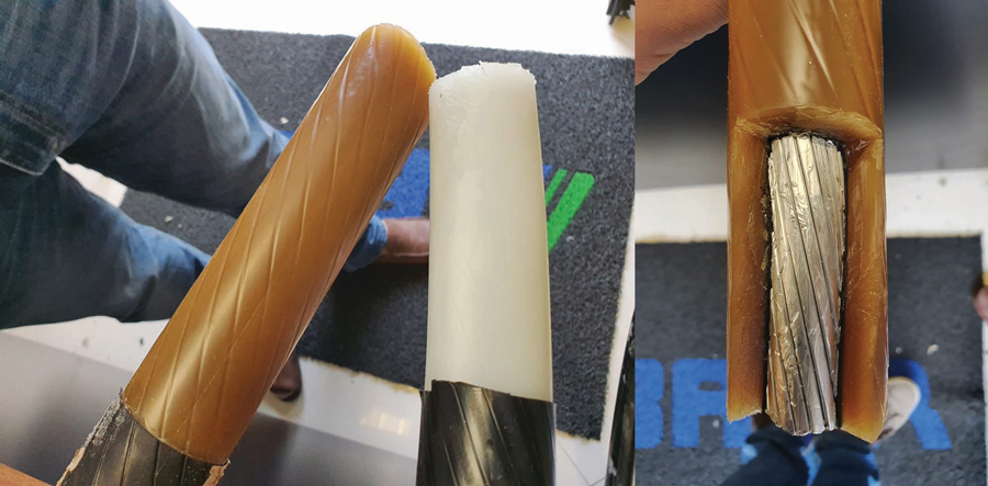

After ruling out the previous causes, attention shifted to the hypothesis of thermal failures. A comparison between in-service cable samples and new cables revealed significant darkening of the insulation, indicating early thermal degradation. This visual difference is shown in Figure 2, where the dark tone of the operating cable stands in stark contrast to the light color of the new cable, indicating exposure to elevated temperatures, possibly exceeding the continuous operating limit.
Figure 2: (A) Operating Cable (left) Condition Compared to the New White Cable (right);
(B) Detail of the Insulation Cross-Section after Operation
The observed discoloration is not limited to the fault location. It extends across significant portions of the circuit where improper cable grouping and inadequate thermal backfill were applied. These segments experienced recurrent thermal stress, leading to visible changes in cable coloration. In contrast, areas where proper spacing between circuits was maintained and backfill was correctly implemented did not exhibit similar discoloration.
